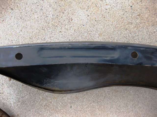

Do the rear fenders have dimples?
I'm new to oval anything - where would these be and what do they signify?

If the rear fenders are embossed between the bolt holes it means they are original fenders. The later fenders, post 1960, and the aftermarket ones will not be embossed.

Dimpled fenders - check your rear fenders behind the tires as the fenders are attached to the body. Between each bolt you should see a rectangular/oblong bump or dimple. That means you have og fenders which is NOT that common - I can't tell if your tail lights are riding high or not from the angle of your photo (tell tale sign of replacement fenders). Again, good luck with everything and there is plenty of info on the samba to assist you along the way. If you can't find it, ask.

No dimpled fender's unfortunately. I think a lot of this car is *new* (we were told it's been sitting since the 70's), but so much is so clean.. it probably isn't very original. Not a big deal to me now, I'll sort that out over the next several years.

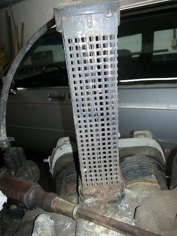

Got a July of 57 36hp for the oval this weekend. It's complete and ran 3 years ago, just needs cleaned up.
The main thing I saw is the fuel pump.. stand? Is that correct? Anything else that anyone can see that is interesting or wrong?

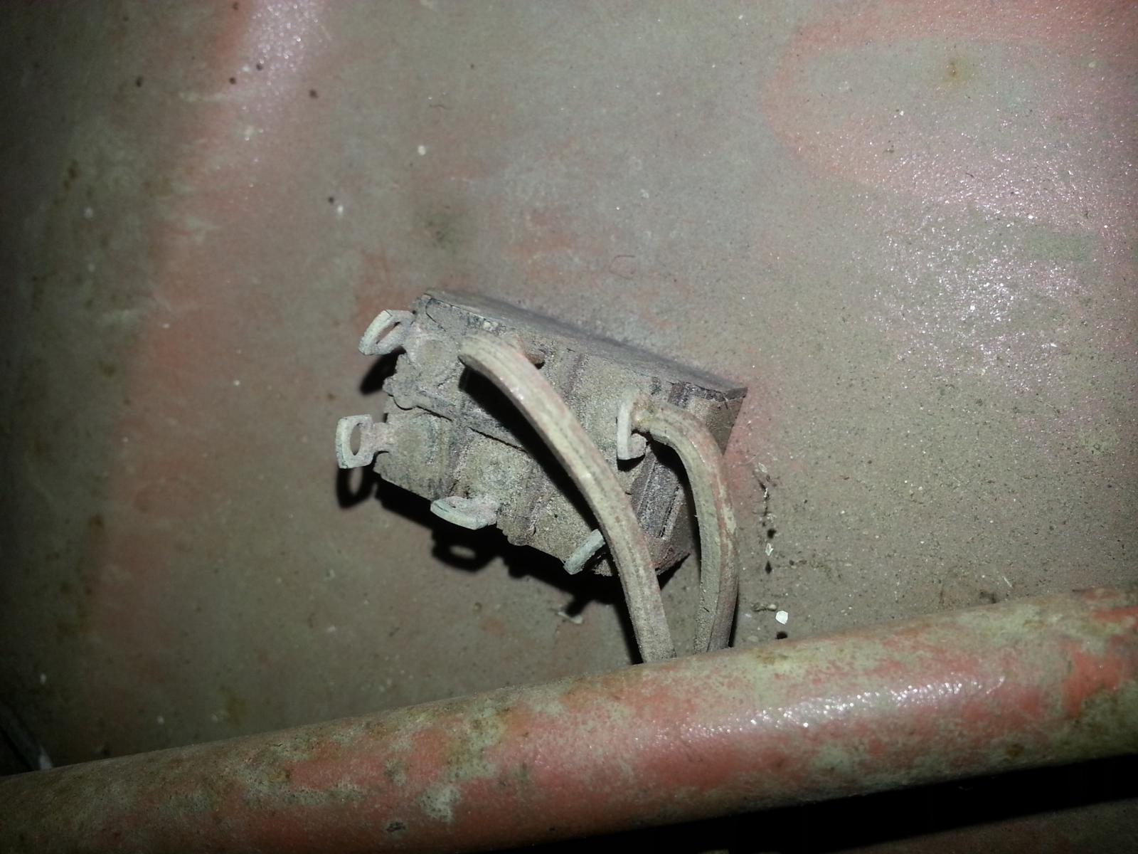

Is this the ground for the horn on the steering column?
I thought at one point that these were the horn wires, albeit too short. After looking at the wire diagram, I think whats currently connected to the horn is for brake lights. Stop Light Switch?
I have 2 wires in the spare tire compartment, one is always hot (when the car is on I think) and these are probably horn wires. I'm hoping that once I connect the ground? for the horn on the steering column that the horn will work.

Looks like some fool actually relocated the horn so he could get it where he needed it to attach the brake light wiring. Classic.

The horn wasn't attached, I just sat it on top of the beam to test the wires which are more than likely actually for the master cylinder.

Correction, the heater channels were replaced. Found evidence of that in the front wheel well.

Also I installed the engine, except I only have 2 of 4 bolts in atm. The bolt for the starter does not appear to be a half moon, as I tried using one. I looked at WW and say the half moon fits all upright a/c, but they also have a kit for pre 70 that does not have a half moon in it.
10 X 70mm, seems like its the driver side top bolt, what about the passenger side?
Any ideas?
