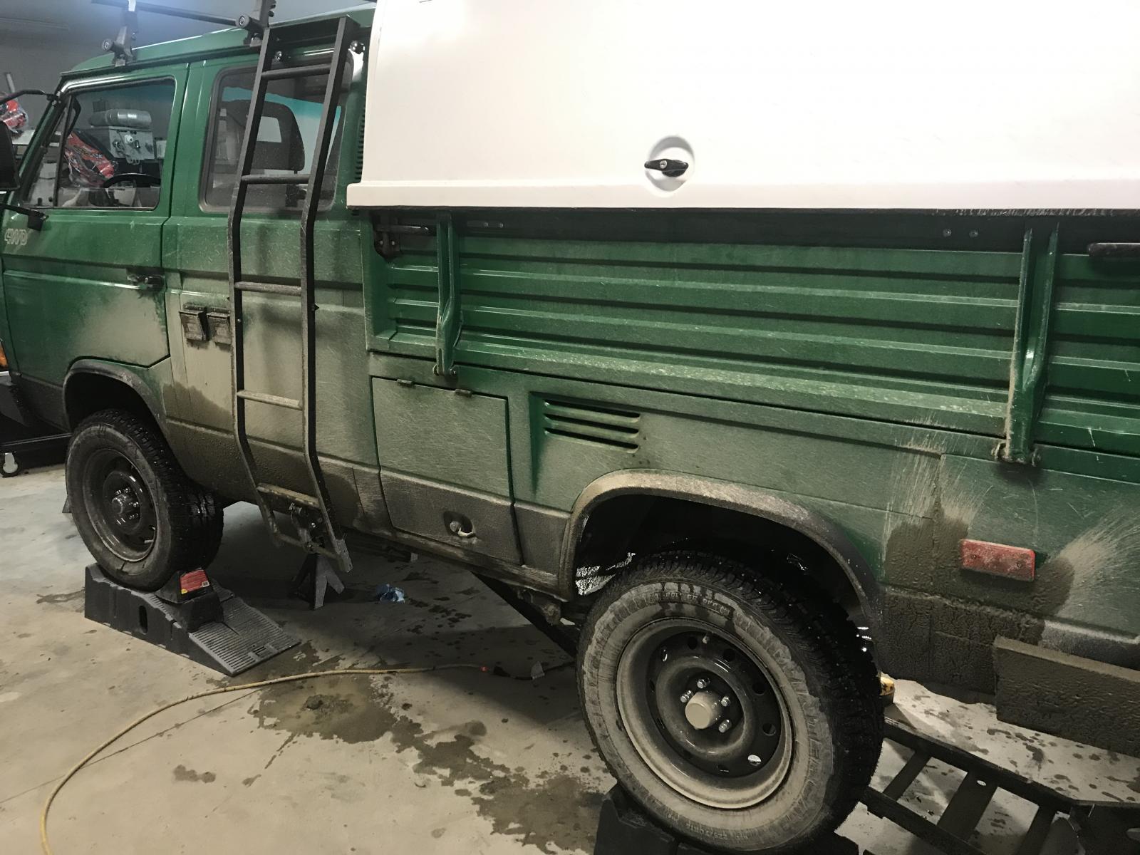

I recently installed the ladder on my doka utilizing the pinch weld adapter -
Before I was limited to the rock slider mount option - which I really didn’t need - or the jack mount which would would, for me, limit install to right next to the drivers door which seemed awkward. It does require one of the the three. Both the pinch weld and the slider mount would allow the ladder to be moved fore or aft in any position tho this would require loosening and tightening the bolts on the clamps on both top and bottom - a bit of a chore I’d think.
The pinch weld setup seems to work well for me - may have a little more flex then the other two mounts but handles my 210 lbs self slinging tires onto the roof basket just fine (better than my arm does anyway Smile )
The folding arm that “bumps” the ladder out from the sidewall gets filled with dirt and one needs to inspect to make sure it’s locked in position before climbing or driving away but it seems to hold up well to the abuse. Very happy with it.
