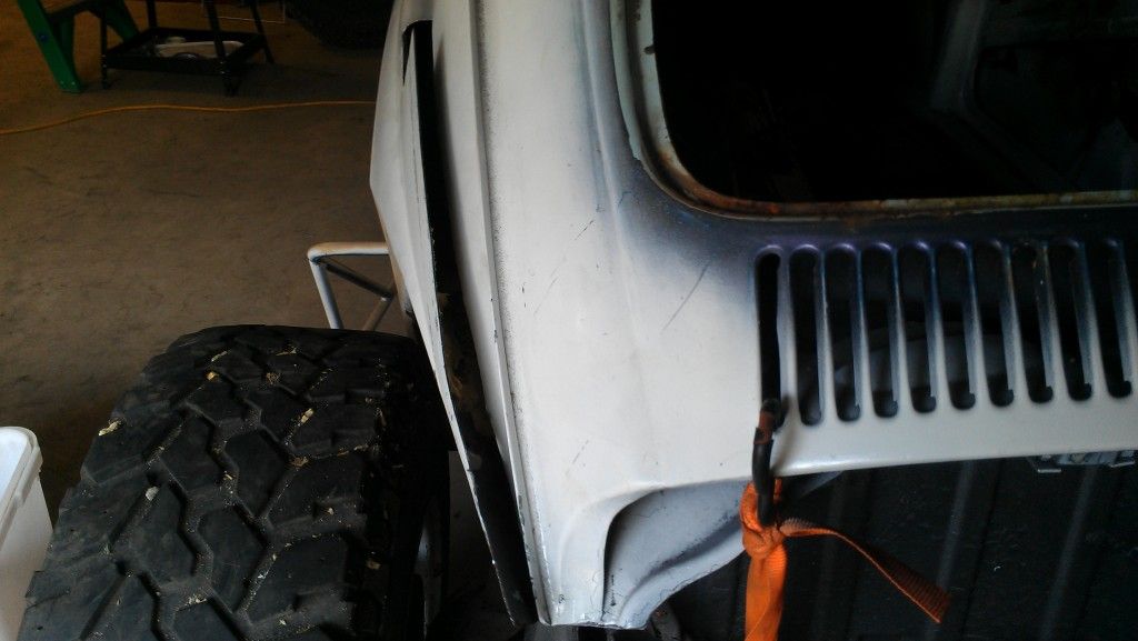

I just did a 5" chop and ended up cutting the C Pillar down the quarter.
Next I will cut the Wheel well and bend it in to match the C pillar area
I was able to keep the back window stock (did a slightly modified fernon Chop) The problem with running plexi etc is it will have to be curved.
Maybe you could heat it up and use the orginal window to get the curve you need?
Someone earlier made a comment about cutting the back glass.
You cant cut Tempered glass as it will just shatter.
You can get it fairly hot to remove the temper but a big bump will just shatter it.
Here is what the C pillar looks like with the roof layed down
inside of it.
68 BAJA
67 STANDARD
"Its a VW thing you wouldn't understand"

I cant look to see what you did, as I an looking from work, and they filter out photobucket.
For ease of glass, I would recommend you reconsider laying down the back window. That is what I did, and then used a cut/stretch/fill combination to get the decklid to sit properly on the back. It ended up coming out p[retty decent, there are pics in my gallery showing parts of that step, and how it looks after the fact, and the best bonus is I can use a stock piece of rear glass, which is the hardest one to get modified glass into.
was able to cut a windshield to fit. the other 6 pieces (2 wings, 2 rollups, 2 rear sides) costed 350 bucks to have made . . a curved piece custom made would probably cost near that by irself.

Looks great but where do you cut the wheel well to get it to match up?
