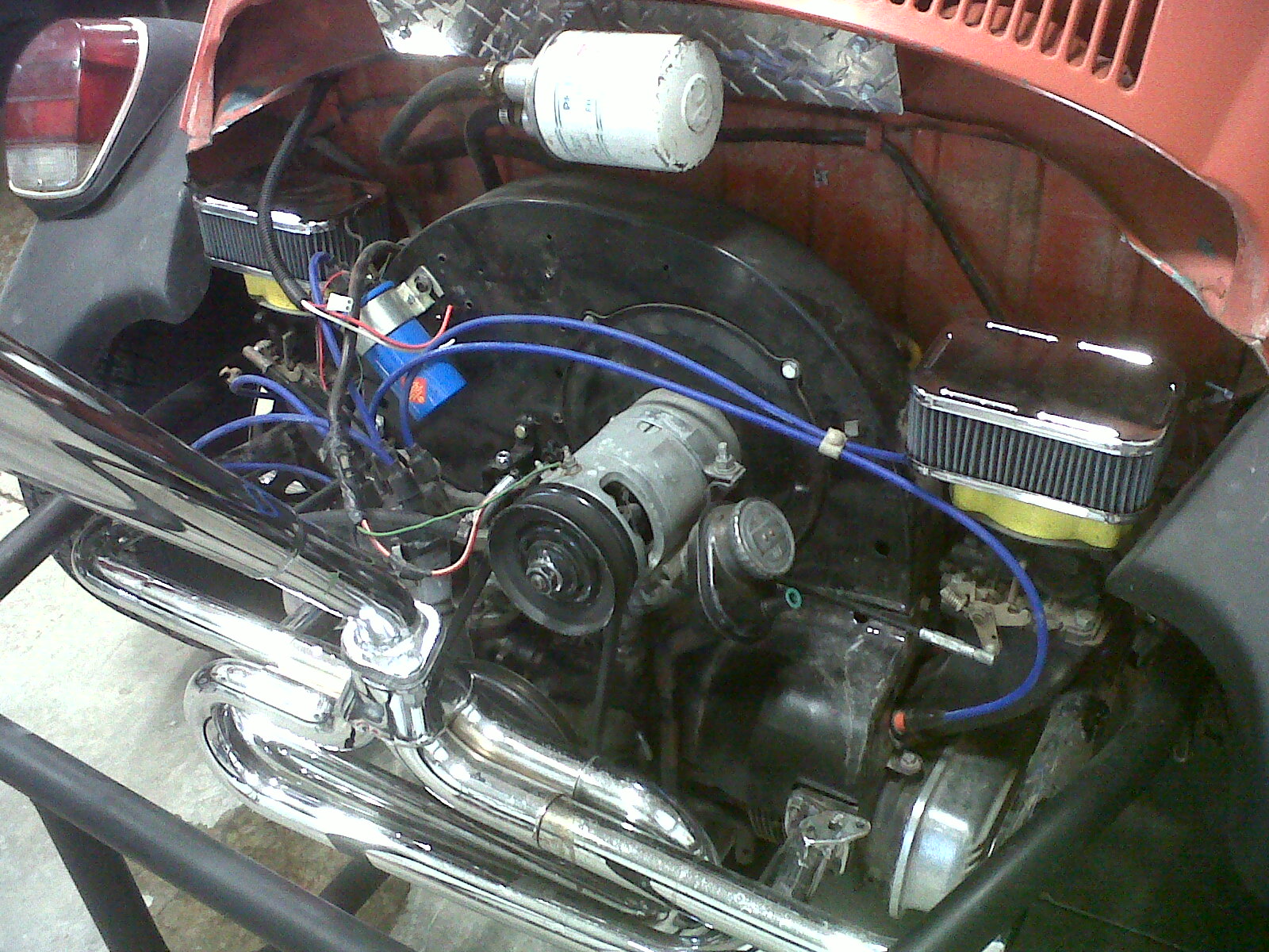

This IS my setup like 2 weeks ago, but i couldn't get it running and so i had the carbs rebuilt. While they were out, I figured one carb would be half the headache, so I put together a single holley setup and bolted ONE of the two to it and here I am.
I can be back at the above in a few hours, but is it worth it? or should I start fresh when my pocket book can float it

Now I'm a little confused
The dual progressive kits sold by CB used a smaller carb, not the 5200
The 5200 has numbers cast onto the outside, outside where the venturies are, should be 26, and 27, this is the size of the venturies.
What do your say?
One way or the other, it will take some amount of jet changing to switch it from running dual to single, if it was ever close to right to begin with. Either way would be some DIY stuff.
I think the ideal single progressive setup would be a carb one size smaller than the 5200, on top of a manifold that has the heat passages that go "up the back", if your gonna do it that's got some potential.
Then again you may be able to trade the dual setup for some kadrons, it would be a fair trade IMO, your call

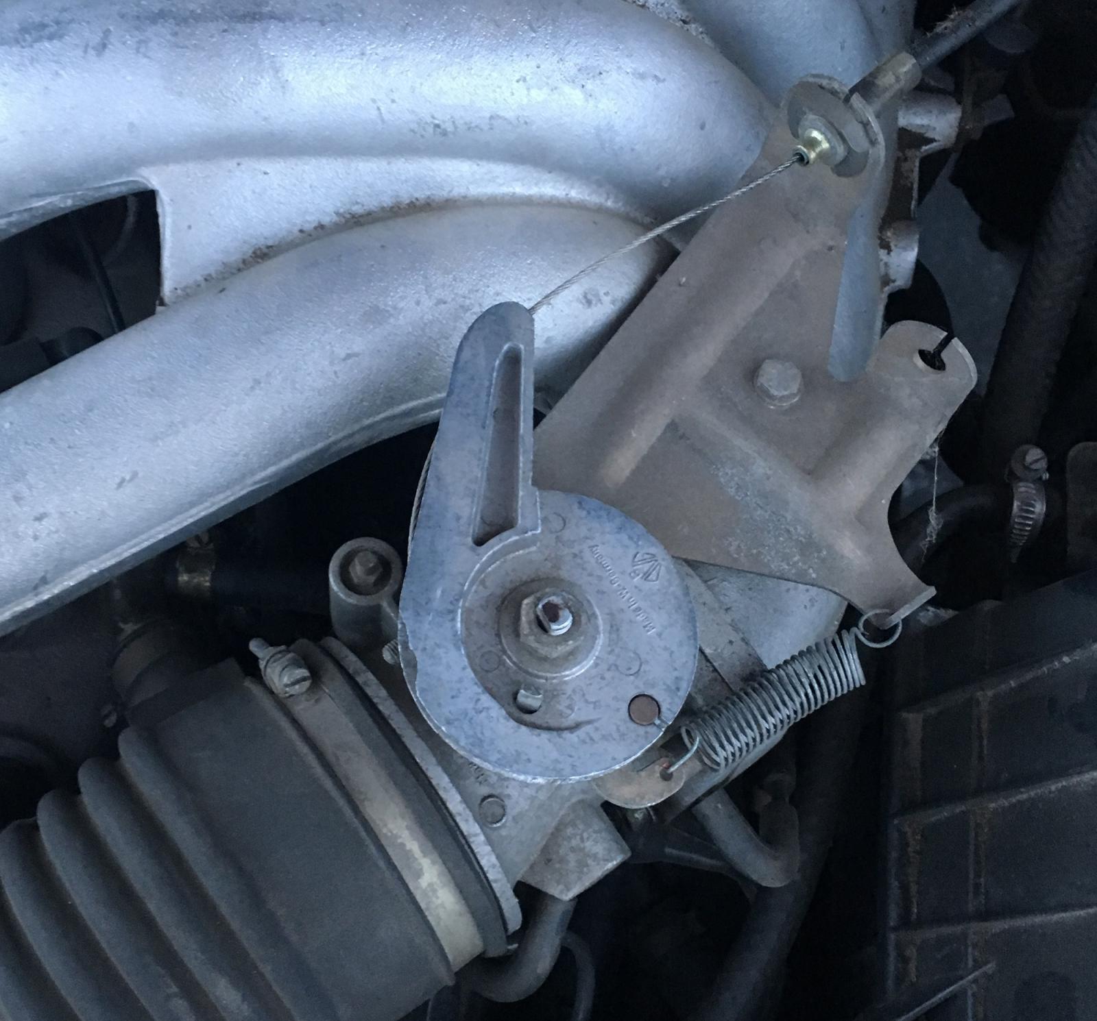

The logical reason behind it in my mind is the same for the dual progressives as it is for the single progressive or progressive throttle body 2 or 4 barrel carb or FI.
Better drivability.
This is how Porsche handled it on the 944 with a single butterfly throttle body. It gives a similar a action and peddle feel. Our Subaru is a single butterfly TB without this feature and is touchy as heck on the first 1/4 of the throttle travel which is where you drive the most.
I have tossed around the idea of getting a pair of these and going to cable controls on my Webers.

Sizing is not what I am referring to Modoc, it's flow rate linearity or the lack of it as the throttle opens. That is where drivability comes into the picture. If you are a 1/4 mile guy or drive your car like you stole it all the time on dry roads then you will have no idea what I am talking about and no need for a linear throttle response.

Yes I follow! Where I am coming from is valve flow theory. A butterfly valve flows approximately 75 - 80% of it's total capacity in the first 20% of opening. Very non linear.
A small primary with the extra flow capacity handled by the secondary is one way to linearize that imbalance in flow.

Yes, that's true, but I'd say with the throttles close to the head it can also be done with the linkage, for air flow.

Yes to a degree it can. That is what Porsche's eccentric throttle cable cam does too. In the instrument business we use very similar eccentric feed back cams on the valve stem to get that effect, more precise control at the lower end of the valve opening.
This phenomena we are discussing I believe accounts for a big percentage of what people feel as the "better response, more bottom end torque" of the one throttle bore per cylinder carbs. It's not so much a real increase in power(Yes there is an small increase) as it is a change in where the power comes on in the gas peddle travel. If one was to graph with a dyno the low end power increase it would be quit modest compared to what it feels the increase is in real life driving. The throttle response is more "hair trigger" therefore it is making more power - well maybe not...
Not sure I am expressing it well enough for you to understand what I mean.
