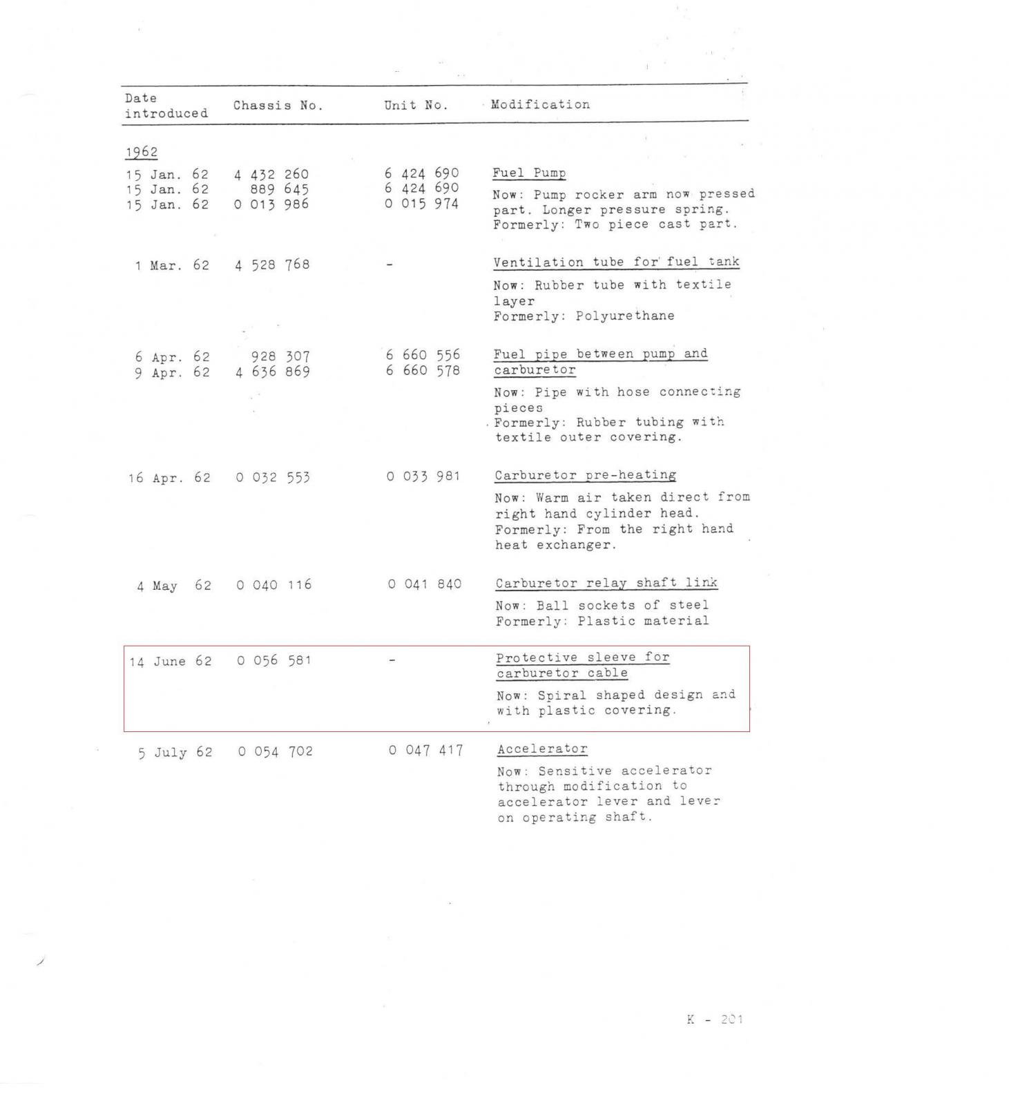

Did you read our "Protective Tube" quote from the part manual post thru that link? Not certain if it was a bowden tube, but VW was using something earlier than 64.
Using later beetle bowden tube on our 1960 walk thru panel camper conversion. Found could carefully work off one of the ends of the bowden tube, then shorten the tube to work with the earlier bus dimension, and work back on the end.
Yup. Much to my surprise in fact. The service manual doesn’t show the tube being used on Beetle accelerator cables until 1966. In my head, it’s the “right thing” to have, so I’m actually surprised it wasn’t used on earlier models.
I’m going to order one up and give it a go on my 64.

PostPosted: Mon Feb 14, 2022 9:57 pm    Post subject: Re: 63 throttle cable Reply with quote
Problem with that listing is it only shows the tube being used for that chassi to chassi time period, and does not list it as the very first used.
There are a few parts that are not listed in the parts manuals. EG we have a DEC62 and MAR63 single cabs. Both have a metal fuel line clamped to the body up front of the engine front tin and the line continues just short of the fuel tank. Have yet to find in any listing in the type 2 parts and workshop manuals of those.....

PostPosted: Mon Feb 14, 2022 10:23 pm    Post subject: Re: 63 throttle cable Reply with quote
Just for the heck of it looked into our AUG64 type 2 parts manual and it lists a:
70(of the parts diagram) 111 721 551 Protective tube - Accelerator cable 1(quantity)
(shorten to 670 mm)
Pretty sure it is original to the parts manual, there is no date on the bottom of the page. Next page back has a "27/67" which should mean 27th week of 1967, meaning it was an updated page.
