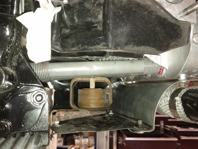

Use them for shure but try to find the original version and not the "new"version. The newer style wil close the flaps when they fail!
Original style:
New style:
