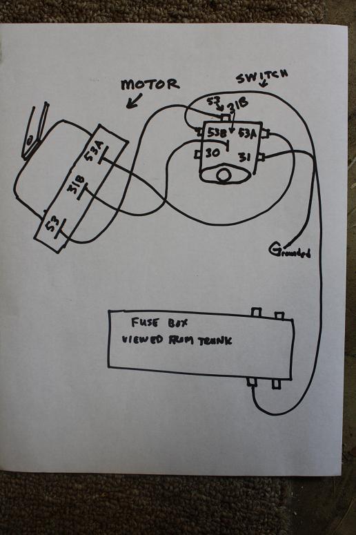

I drew a diagram of how its currently wired...

I have a multi meter that my dad gave me a cpl years ago. I admit, I dont know how to set it. Here is a pic of it. Does anyone know what setting I should have it on? Are the red and black sensors in the right place? When I check each terminal as described in Andy's link, which should I put on a ground and which on the terminal while testing?
Please dont be to rough on me... I you had questions for me in MY field of expertise, I would be gentle with you. Very Happy

On the meter, move the black probe to COM. Leave the red probe where it is. Turn the meter to the 200Ω position. Touch the leads together, you should get around .01-.05Ω, that is the resistance in the meter and the probles, equivalent to a direct connection (continuity). Then apply the probes as listed in my other thread - coninutity will be as in the initial lead test or just above it in resistance. Open will be no reading at all.

Does your motor work? Grab a piece of wire from a hot leg on the fuse box and conenct it to 53 - should run. If not I would suspect the motor or your ground connection. Andy, please double check this.
Also, bench testing would have been a smarter thing to do. And how are things in Indiana? Been out that way a couple times over the last couple months.
