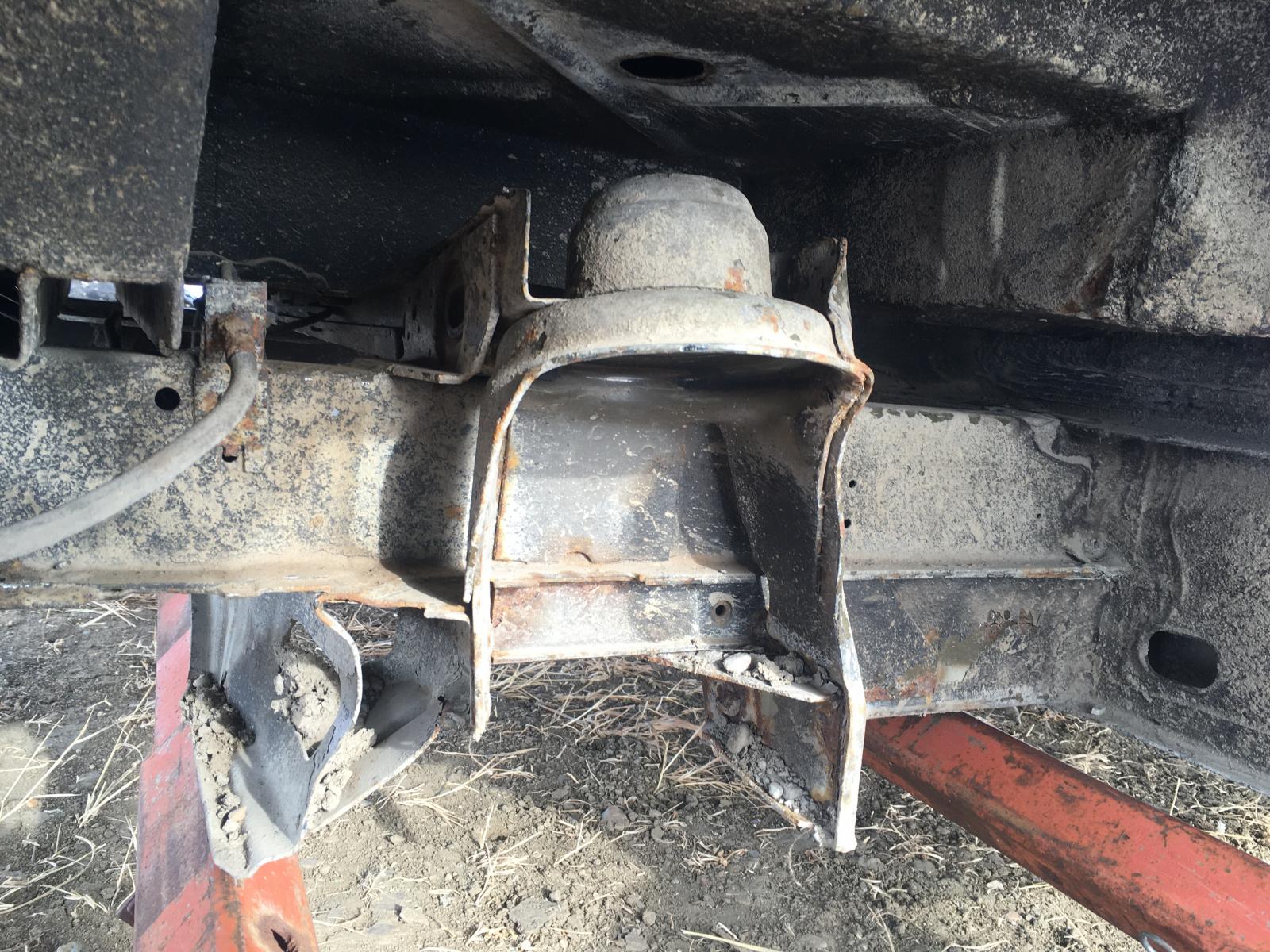

Hey guys/gals, I am in the process of saving a Syncro Single cab tub/body only, and building it back up...to do so correctly, I would like to know if it's a 16" or 14".
There are some tell tail signs of it POSSIBLY being a 16" (fenders are cut, and holes drilled for the 16" flares, the front shock towers are reinforced like all 16/14" transporters).

There is nothing that screams syncro 16 especially with all of the missing drivetrain but you never know, the M codes will tell you what it was originally. There was a bad road package for 14" syncros so the front shock tower reinforcement isn't even a dead give away.

PostPosted: Sat Mar 12, 2016 8:19 am    Post subject: Re: VIN check quiz (tell me if this is a 14" or 16" Syncro) Reply with quote
So I went up there and grabbed the other syncro from the guy, and while I was there I grab a bunch of pics for my friend, this pic is what raises the question of if its a 16
You can see the shock tower has the 16 reinforcement on it
