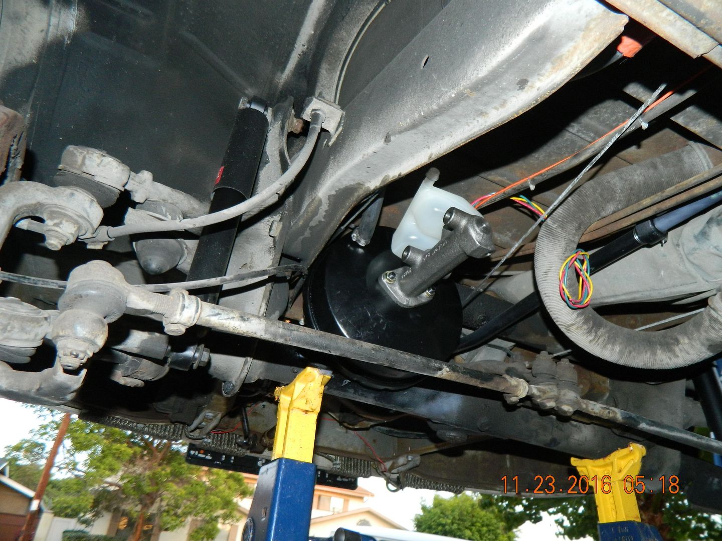

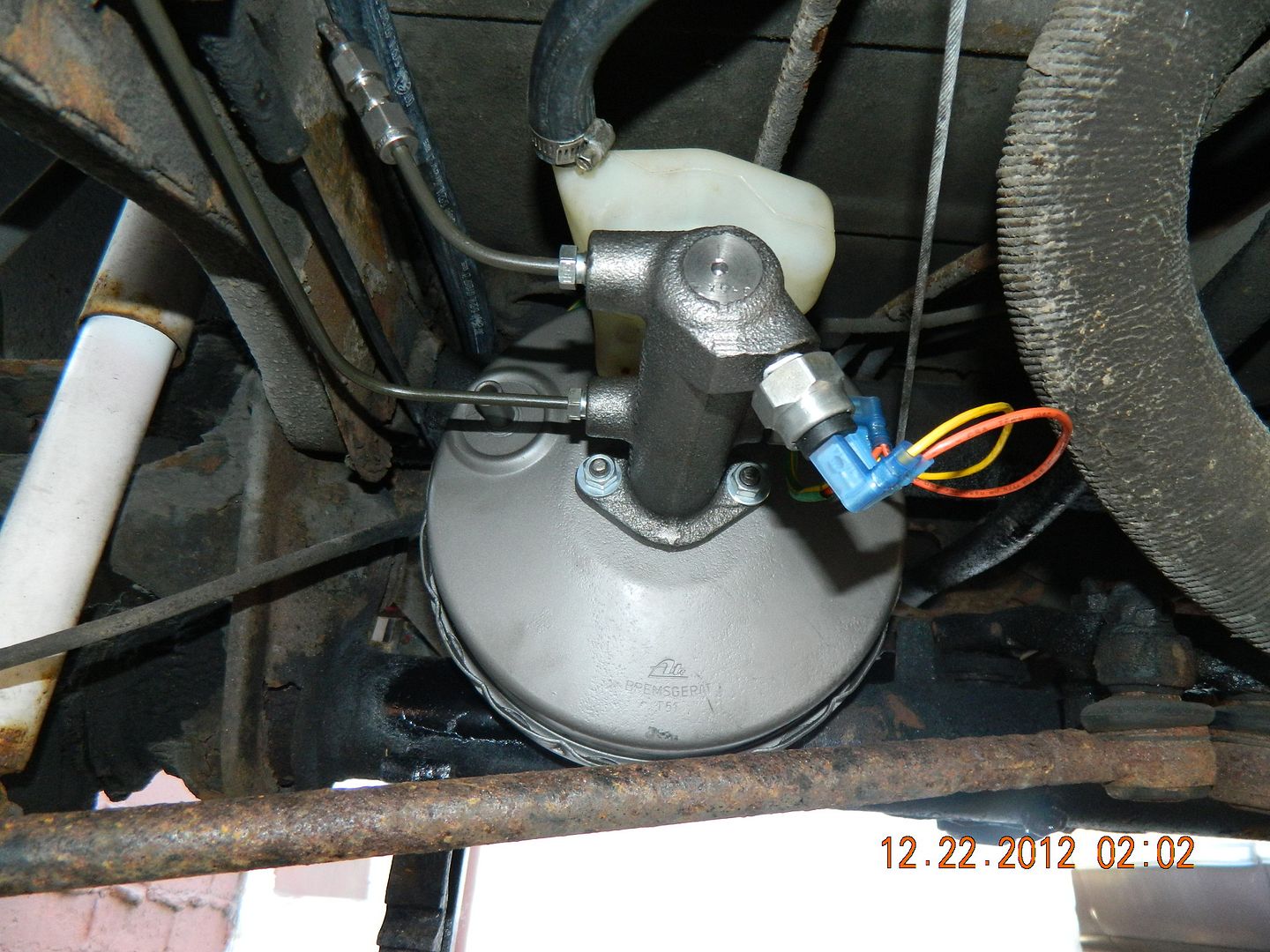

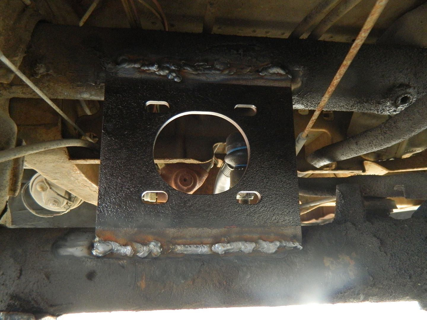

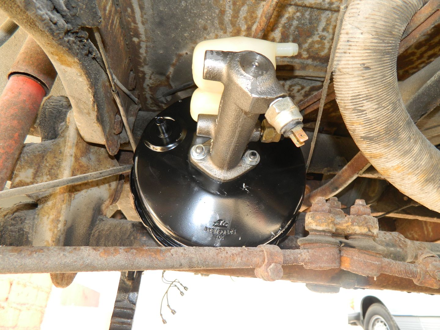

I’ve helped several early bus owners improve their 4 wheel drum braking by installing a 1971 booster and master cylinder. Good results and happy customers.
1). Get a 1971 booster and mc plus rod to pedal
2). Weld a plate to the beam on which to mount the booster
3). Lengthen the rod by 1inch
4). Mount the components and modify the hard brake lines to the mc
5). Tap into the intake manifold and run power brake vacuum hose up to the booster
6). Modify the brake switch wiring to reach
7). Run a line from the upper reservoir to the lower reservoir for fluid.
Snap. I did this to my 68 that already had great brakes, the result was a pedal as light as my mk4 golf. I've done the same with two other drums all round buses with the same result. The big BUT is that the brakes were already very good and my experience is that drum non-servo are far better than disc non-servo like my present bus was...until I added the servo.
