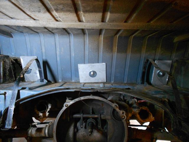

Here is what I did to add 2 rear seat belts in my kombi. The pic does not show it but they fit with a camper bed. I used the WW seat belts. They came with bolts, nuts, lock washers and big washers. I added a few plates for extra support. Be careful and not use bolts to long as it is a tight fit behind the gas tank. I cant remember if I used the bolts with the belt kit or if I got some different length ones.

That is good, but you do not want that firewall panel to pop loose in a crash. VW made seat belt mounts for there in the 1970s buses and they attached to both the firewall and the panel the gas tank resides on.
Here is an image of the later bus rear seat belt mount cut out of the bus.
Should not be that hard to add the extra bolting mount, and with gas tank in place it would be out of sight.

I chose to mount mine below the tank deck... and anyone looking that close at my Westy in some random parking place, is damn suspicious.
