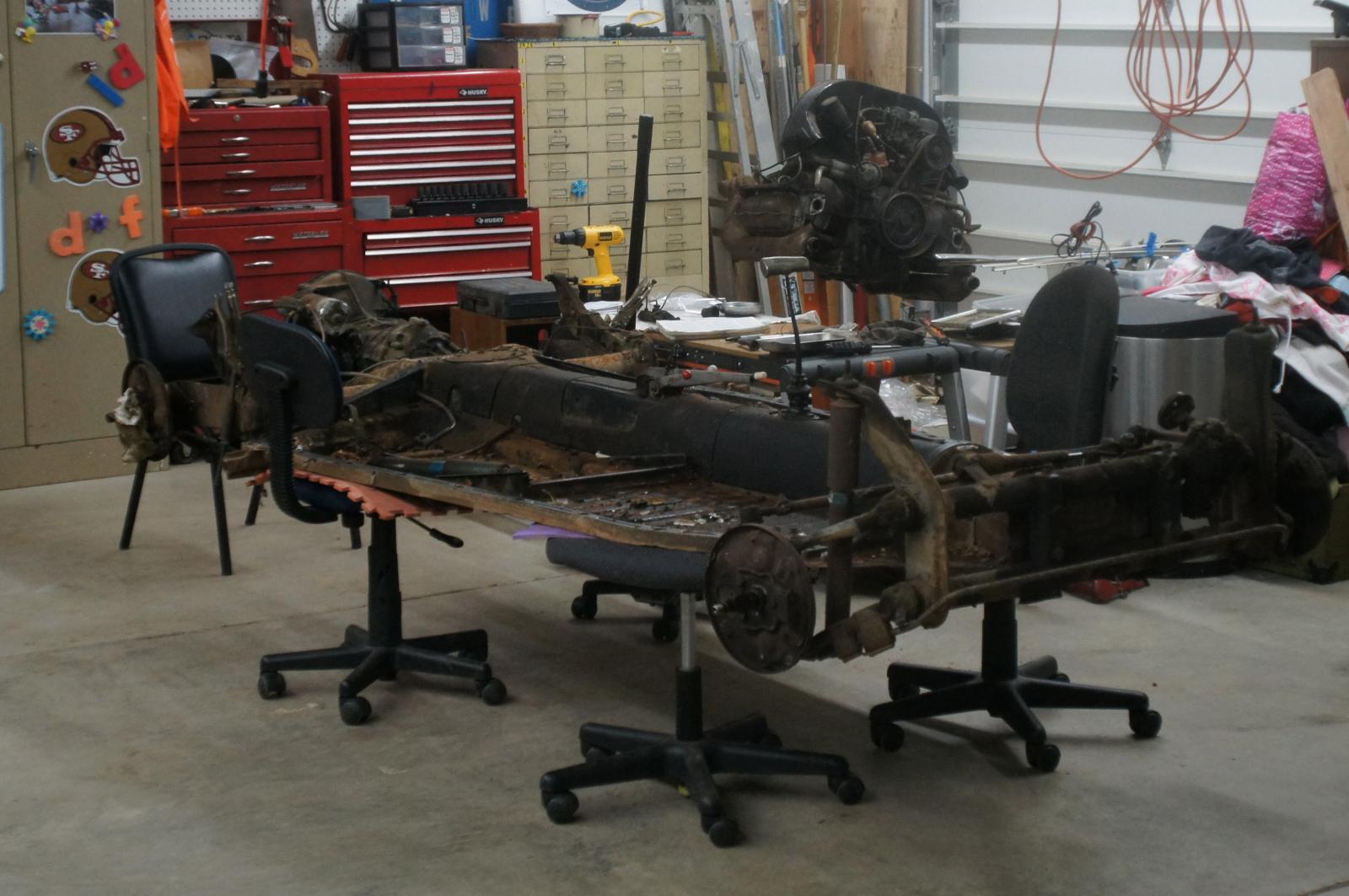

I found that 4 office chairs to roll the chassy around worked like a charm. I can sit in one place and maneuver the chassy about with ease (while seated).

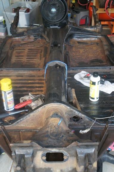

Is that thick asphalt type stuff on the pan original or after market?

Now to remove the front end. I have no idea as to what I am doing or the order in which to disassemble this thing.

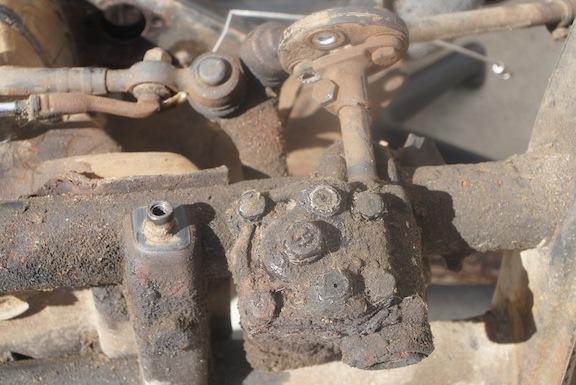

Hmmmm... I used a dremmel to mark the steering box location. What a mess!. it grinds when turned, so I guess I have to rebuild this too. Any pointers?

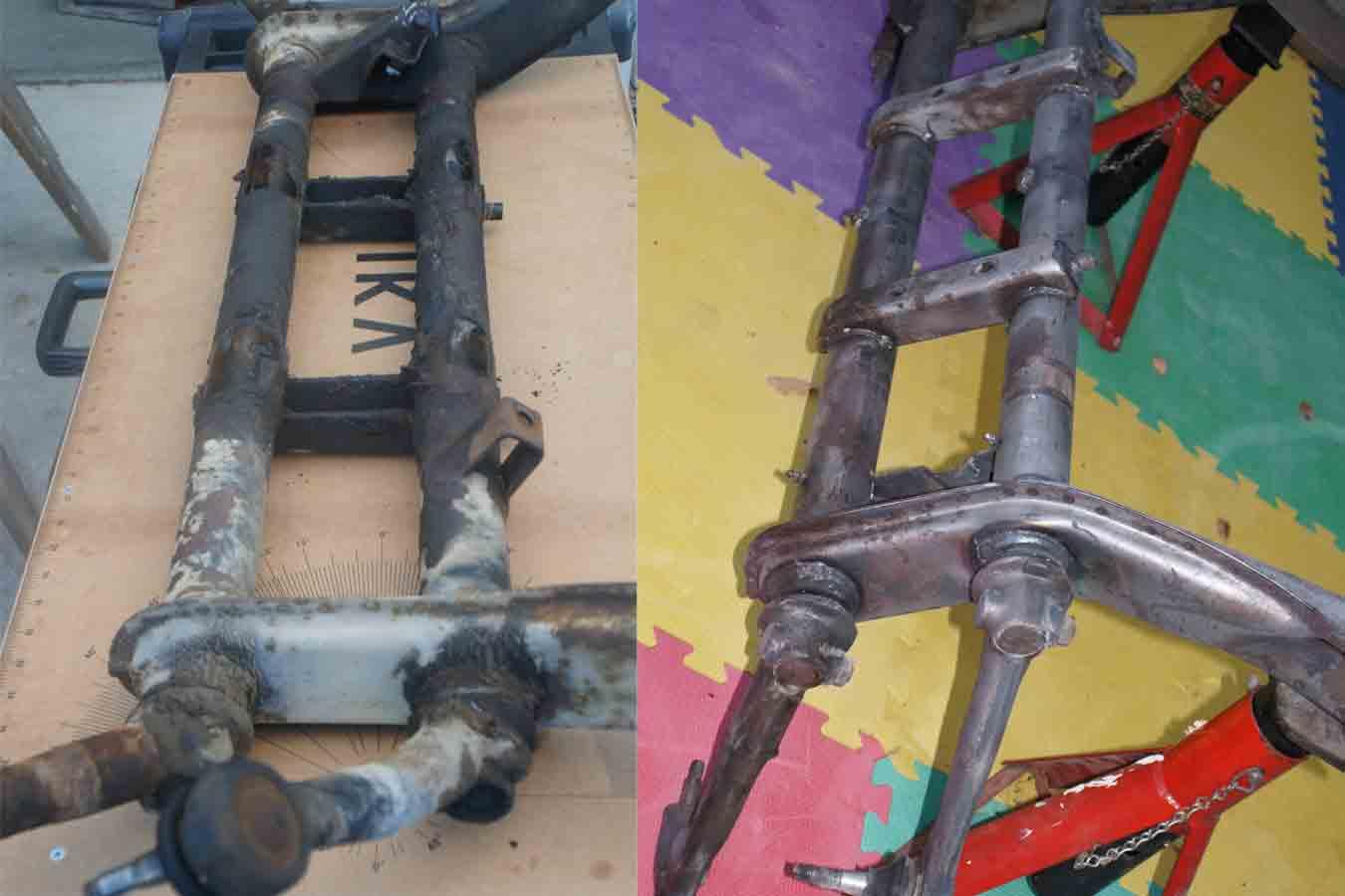

Cables, shifter, and the beam has left the chassy! Now I get to media blast and clean stuff.

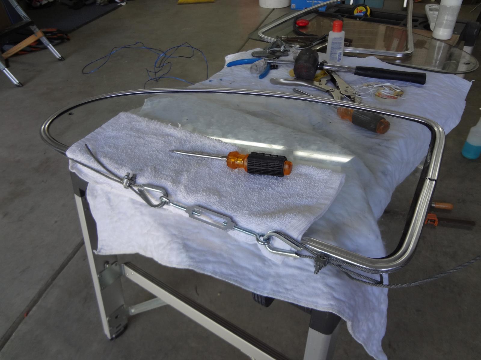

Bought a radio off a Samba member (locally)... seems the only thing the car didn't have. Second purchase was the glass to frame seals for the pop outs. Spent many hours searching info on how best to do it (not a whole lot out there). I found one post here http://www.thebugshop.org/bsp57_17.htm with photos. The guy used a nylon binding strap which was difficult to keep centered. I was dreading the task - as it appeared daunting.
Lo and behold, after trying diff things for several hours, I thought of this cable / turnbuckle thing. The cable rides in the window to body seal grove and cinches it up like a hot knife through butter.Each window went together in 20 minutes. Oh, and I found KY jelly to be the best medium to aid in slipping the frame on. This photo was taken prior to final cinching - see the gap at the seam.
Dental floss perpendicular between rubber n frame helped to keep the rubber in place while cinching.
[/img]
This is the last double post I promise! I was so excited about the result that I posted it here http://www.thesamba.com/vw/forum/viewtopic.php?t=5...lass+frame before starting this resto thread.
[/img]
OMG, please, please PM me and I'll send you illustrated details on how replace pop-out seals, I do a set every few weeks and it really is the easiest job to do - and I've never ever had to cinch them either. All credit to you for the ingenuity and well done.
That is too funny, love it!
