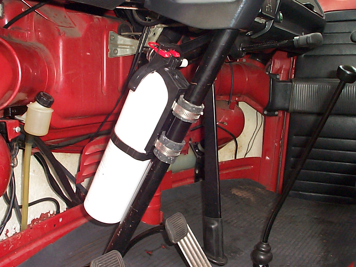

Posted: Sat Apr 29, 2006 10:23 pm Post subject: |
I settled in on this concept of mounting my extinguisher to the back of the steering column of my 70 bus and had to share. After driving the bus for a week with this installed, I realized it never got in my way and is easy to reach if I ever need it.
