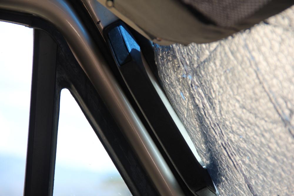

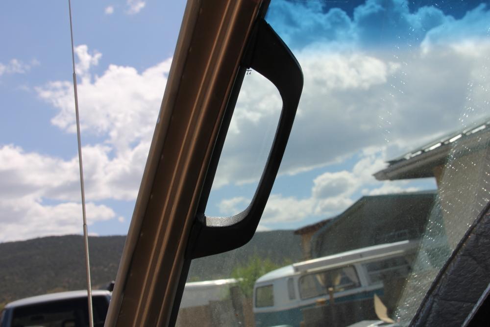

I have a parts Vanagon, and since I have trouble getting up into it the Syncro, and was worried about grabbing the steering wheel each time I decided to pull the passenger side grab handle and install it in the Syncro. Here is the finished product.

PostPosted: Tue Sep 11, 2012 1:42 pm    Post subject: Reply with quote
GrindGarage wrote:
So funny was looking at doing the same may the classifieds flood with spare handels
Good luck in finding them.....the install took all of ten minutes.
Just make sure to get the escutcheon that the handle screws into, screws and caps for the handle, so that they sit away from the pillar, which keep the handle away from the windshield.
Just a note. Be very careful drilling into the A pillar as there is a wiring harness going up it. I knew it was there, so the first hole was drilled very slowly. The I kept a dentist pick on it while drilling the last three holes to keep it away from the bit. Slow and sure is the best way. Wink

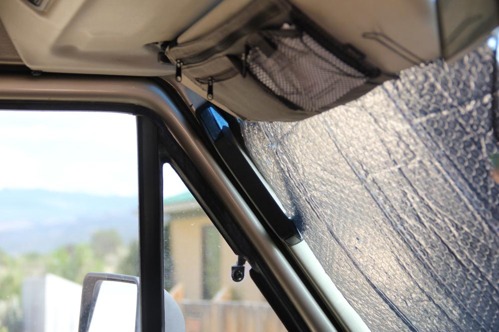

PostPosted: Tue Sep 11, 2012 2:04 pm    Post subject: Reply with quote
Another option

PostPosted: Tue Sep 11, 2012 8:38 pm    Post subject: Reply with quote
That handle is from an early '90's Passat. It's not entirely evident, but there's a fair amount of metal that runs up behind the dome light on the drivers side. It's probably best to pop the light out and feel with your fingers to determine how far you can go, but I think it's something like another inch before you run out of metal. I don't use that handle as much for ingress/egress, as for adjusting my position while in the seat.
