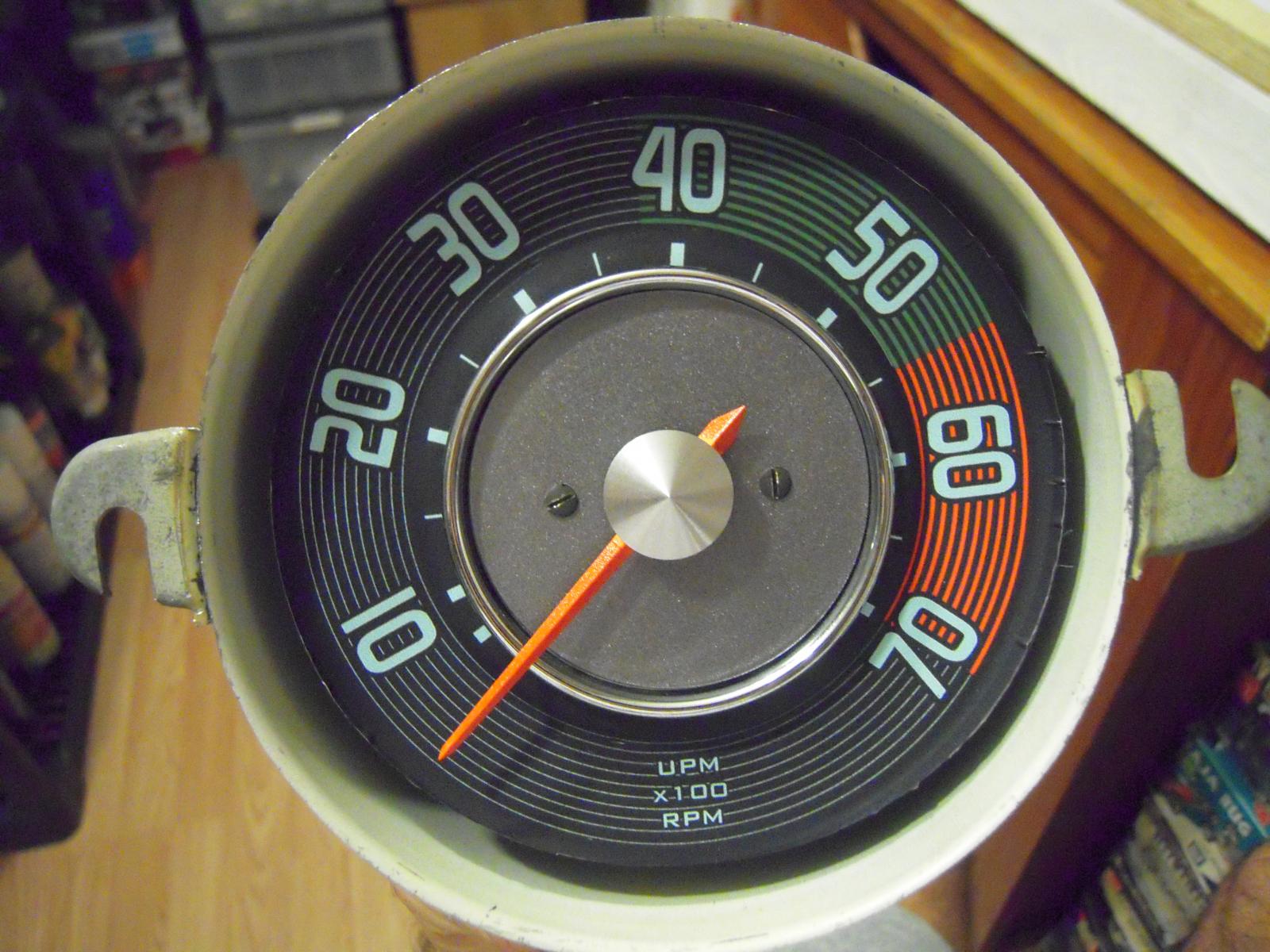

I purchase the decal available here on the Samba from a nice fellow. I went to Pomona and picked up a 914 tach for $15 and I had a clock out of the parts car that did not work. I tried to figure out how to put the tach guts inside the clock body and seal it all up but it was beyond my abilities. So, I decided to convert the tach body to fit the dash like the clock would. The chrome on the clock was pretty bad so I found some jewelers rouge and a dremel and polished the chrome. The parts that do shine are so bright that they glare over the bad spots. Depending on how the rest of the car comes out I will eventually find a better ring or rechrome this one.
Next step was to make the tach body accept the clock chrome ring. I marked the tach body and then filed it off. If you have something better than a hand file use it as it took a long time to file everything but eventually it fit. See the black marks below for how much had to be filed, it does not show real well sorry-
Next I cut the mounting tabs off the clock body with the dremel and attached them with JB Weld
I completly filed the lip off in the areas the mounts were to attach.
Next I had to deconstruct the clock face and drill new holes for the screws to attache the guts of the tach. I had to remove the collar in the middle. I then filled in the old holes, smoothed it out and painted with a hobby paint by Tamiya called Light Gun Metal. I used a dark gray primer to deepen the color.
Here is a picture of the test fitting with the new holes to mount the tach workings to the clock face
Next was the part I was dreading. Application of the decal. I have been a scale modeler for many years and decals can be tricky when they are water slide varity but this is sticky vinyl and you cant move it around. So I centered the face over the decal and marked the decal with a perm marker and the cut around that. I gave myself a little extra material to allow the decal to move down around the curves on the clock face. I then removed the vinyl backing and marked the decals backside with reference marks at 12 and 6. Then I placed the decal face down, sticky up and dropped the old clock face over it. I then started applying pressure on the flat surface where the numbers are and worked my way to both compound curved areas. After gentle working, I cut off the outer excess and the middle section where the chrome trim went back in. Next is to take an exacto blade and start making fine cuts over every little air bubble that I could not work out untill they were all popped and everything sat as flat as possible.
Now at this point due to the shinny decal it still looked pretty bad but luckily I known an old modelers trick. I coated the surface with some hobby Tamiya flat clear. Suddenly all the little imperfections go away and it looks great.
Now on my clock face the stamping is far from symetrical but the method I used centered the art work circles on the inner raised surface. The outer bevel is uneven at best.
Next I decided that in the 50s tach needles were probably not dayglow red but i still wanted red so it would stand out. I used a bright red paint and sprayed just the needle portion.
I then used the glass from the 914 tach and the front flat black ring from the clock that I resprayed flat and remounted the chrome front ring with its internal gasket in place. And there you have it. I nice looking tach for the old Ghia for around $60 invested.
Here is the finished tach

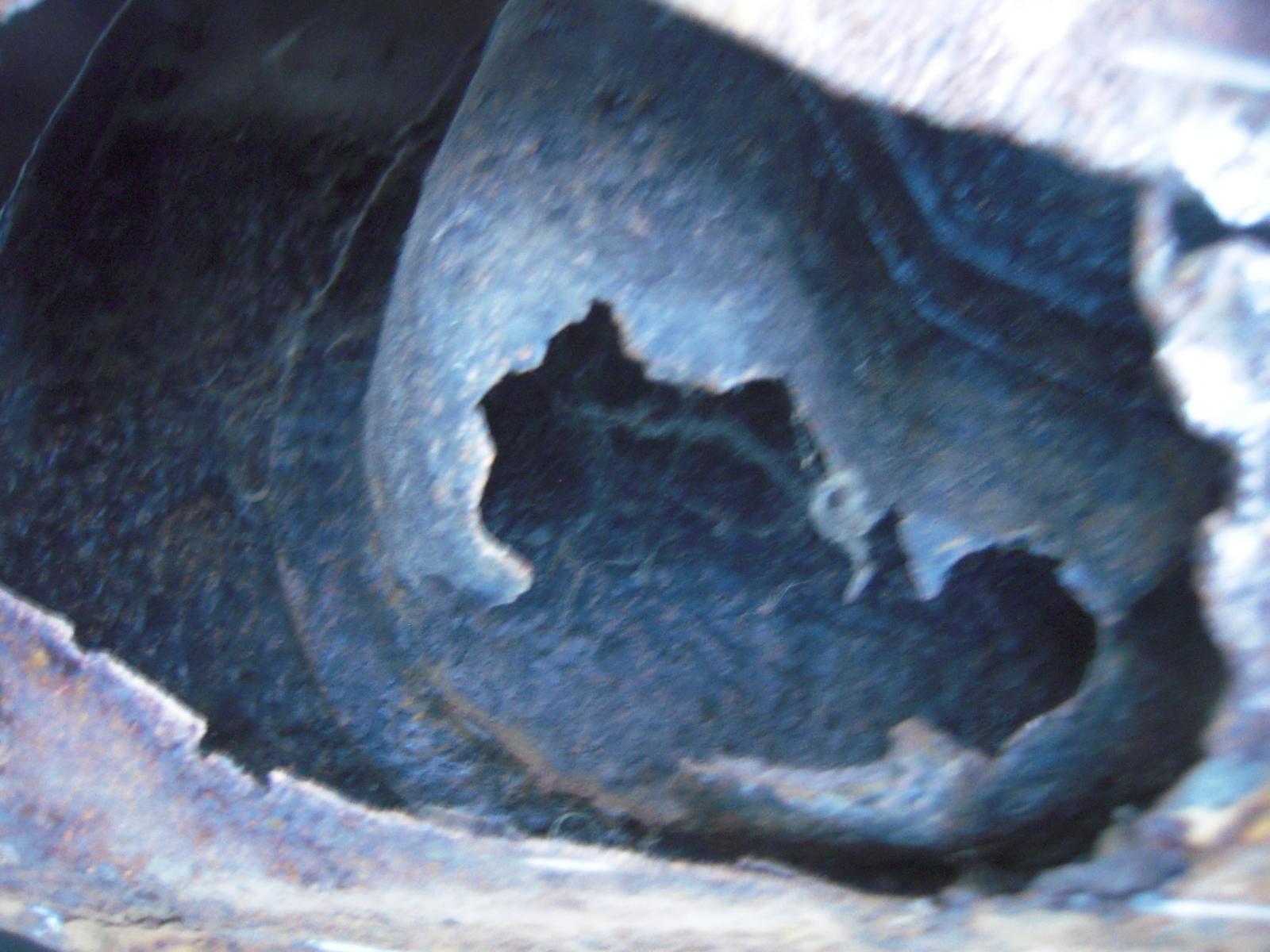

PostPosted: Sun Oct 28, 2012 6:57 pm    Post subject: Opening Pandoras Box Reply with quote

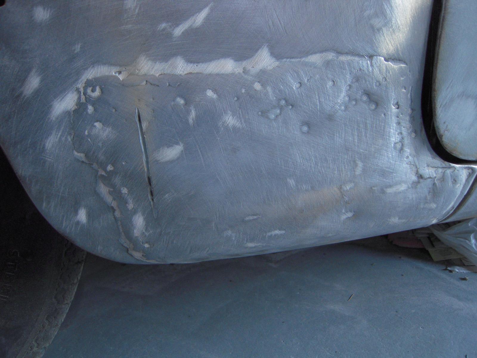

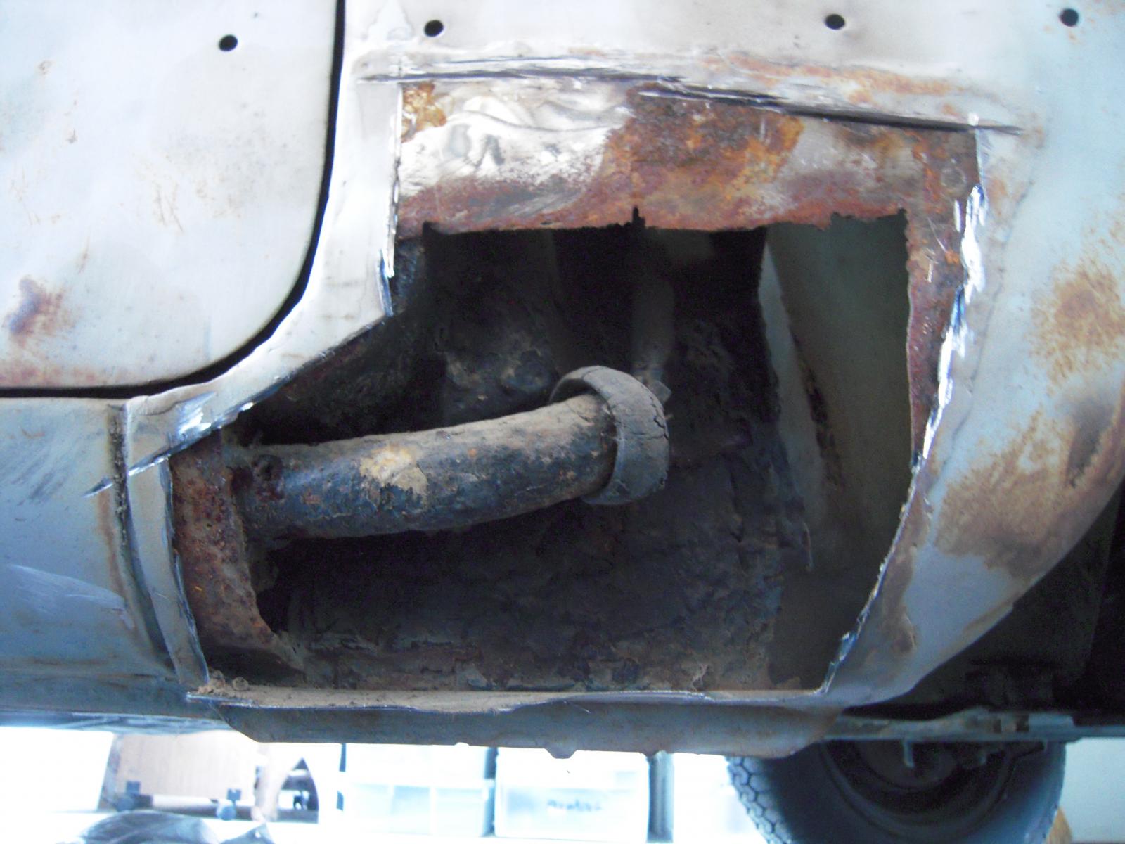

Got one of those 3m wheels today and decided that dig in to some of the bondo.
Found a patch like this on both fronts.
Underneath I found this
the bottom of the A pillar support is gone behind the wire loom tube. I think I feel a small problem on the back of the loo tube also.
They just welded these big panels over the holes and rust.
Looks like I have some work to do here.

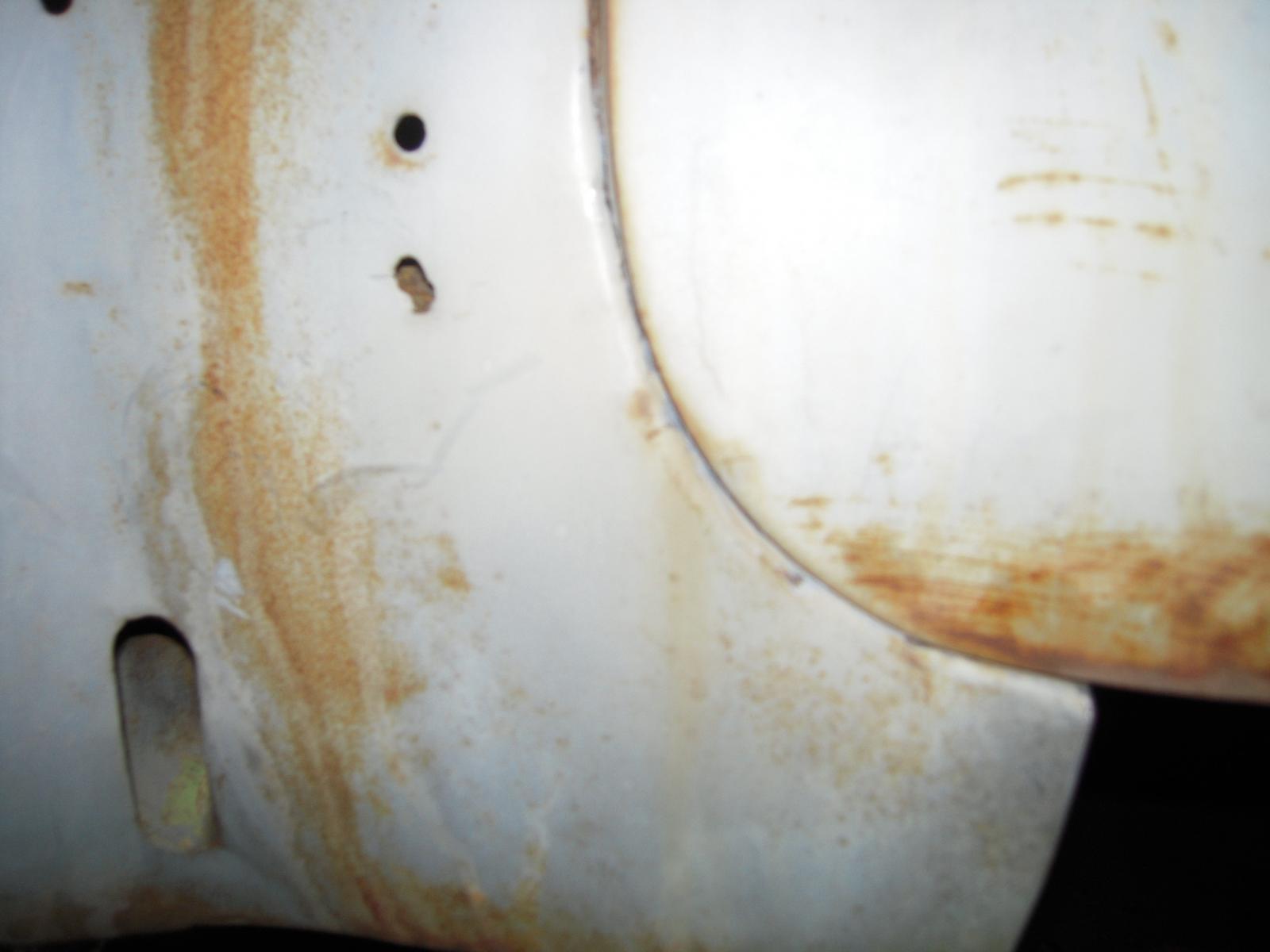

Also found this on the upper corners on the body above the rear deck lid. I found a wavy pattern that almost looked like a crack but when I hit it with the wheel it looked like lead underneath. It is very soft and I can scratch it with my finger nail and it partially ground out.
Not sure if you can see it but here is a pict of one corner It is the crescent shape going around the corner
Any one have any idea what is going on here???

PostPosted: Sun Oct 28, 2012 8:58 pm    Post subject: Reply with quote
The factory used lead in various places to fill low spots. You will find some around the front hood, around the decklid, door jambs, window frames, etc. If you look at my project you can see lead in these areas too:
http://www.thesamba.com/vw/forum/viewtopic.php?t=403985
Thanks Loren
That was my thought but it reminded me of the look of some of the stress fractures on the nose.
Question, are only the lower rear section of the front wheel wells shaped differnt than later years or are the rears different than the later year patch panels too? I have only found one small area in the rear that looks mildy rusty so far.

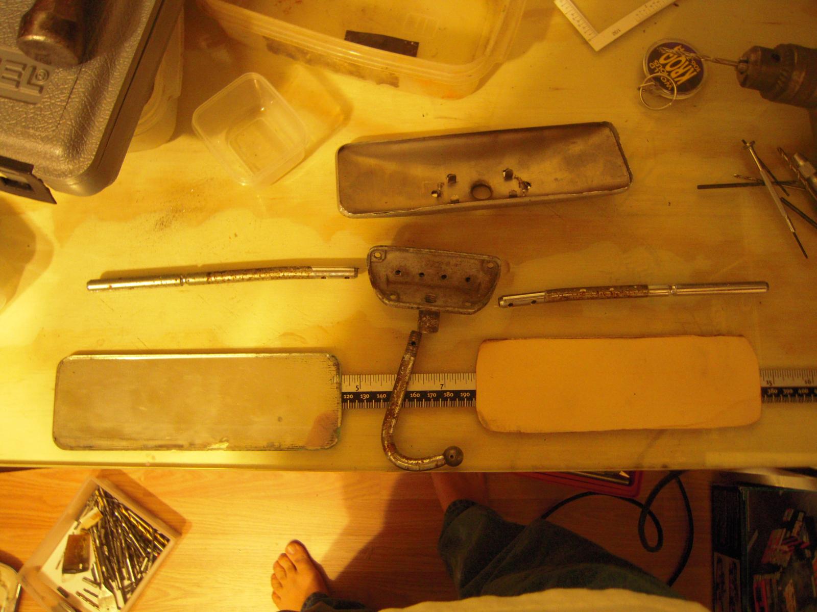

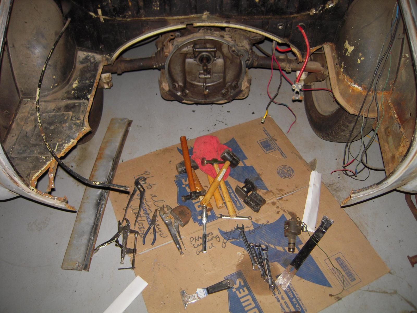

got the mirror torn all the way down
took out the bad metal in the motor compartement. Used the drill bit and paint scraper method.
Once I got all the bad metal it was very easy to relax the panels back into position.
This bottom corner gap was quite wide before
on this side the deck lid overlapped the body
just waiting for new metal
Hosted on Fotki
I am going to try and save the bottom valance as the new metal has exhaust dimples and that would probably be just as hard to fix.

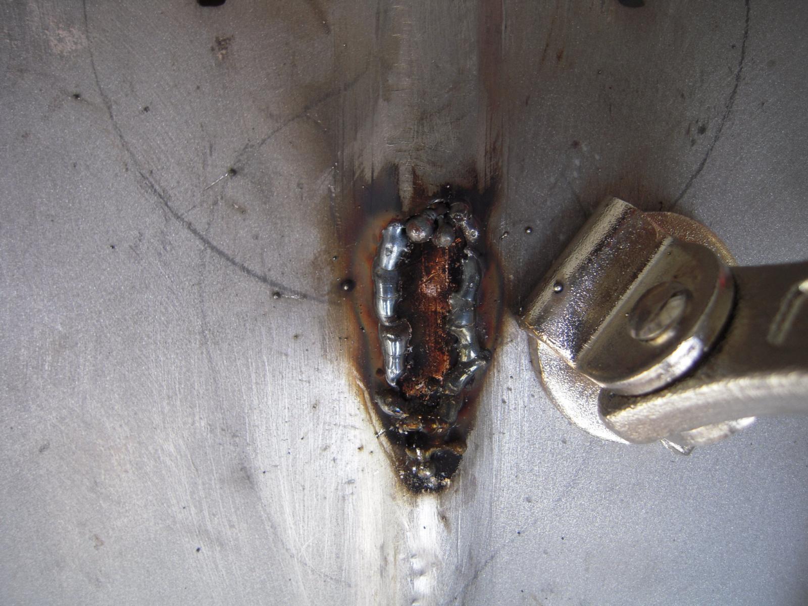

Well with about 10 practice spot welds I decided to go for it. I filled in a bunch of holes at the rear of the car, which went well, so I decided to go for some harder stuff. The nose ridge. I made the tool Greg demonstrated in his youtube videos and roughed the nose into shape. I then used that tool to bend a piece of copper into the shape. I could then clamp that behind the big hole where prior persons had ground the nose ridge away. Top to botton the ridge is missing metal.
here is the copper backing plate and starting to build in the metal. Think of the work as a really slow 3d printer LOL
I then ground rough shape with a small cutting wheel and then went to hand files.
Following are the two largest holes roughed back in. Fine metal work will come later. Metal is much thicker and stronger now Cool
Onward goes the battle Very Happy

Looking great! The tach turned out really nicely!
Keep it up.
