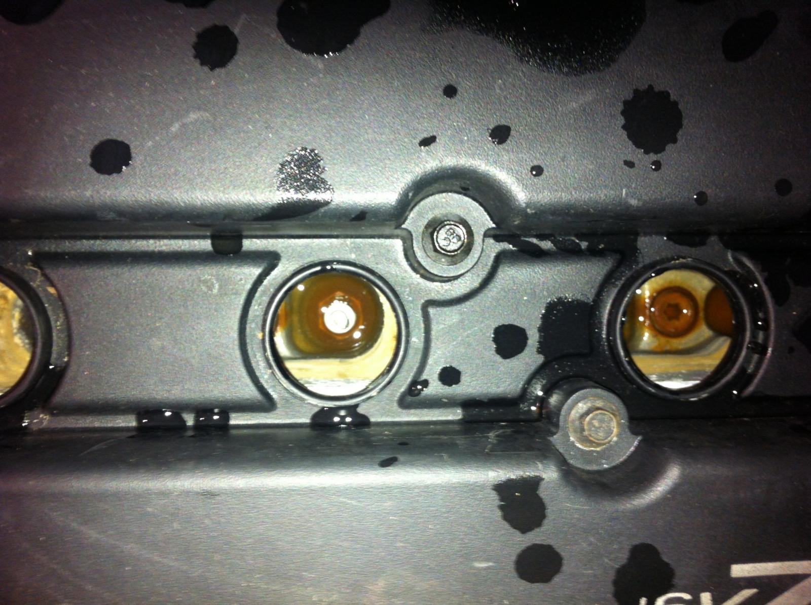

Be careful when cleaning a zetec conversion that you make
sure to vacuum any water that gets into where the plugs go.
