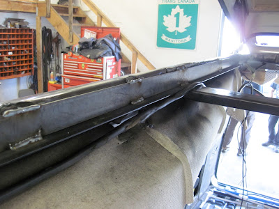

canasync
Joined: June 28, 2010
Posts: 657
Location: BC
canasync is offline
PostPosted: Wed Jul 11, 2012 9:05 pm    Post subject: Reply with quote
Here is an example of what one of my friends that converted his hard top to a pop top. I don't have any pictures of the completed reinforcement or completed project but the fabricator that did the welding added very substantial cross braces. My buddy wanted a thicker mattress than the factory westy one but still wanted to be able to keep all the bedding, cushions included on the bed while the top is down. To achieve this, the cross braces were welded in a few inches below where the westy would have them.
It's not a factory install but the end result turned out awesome.
