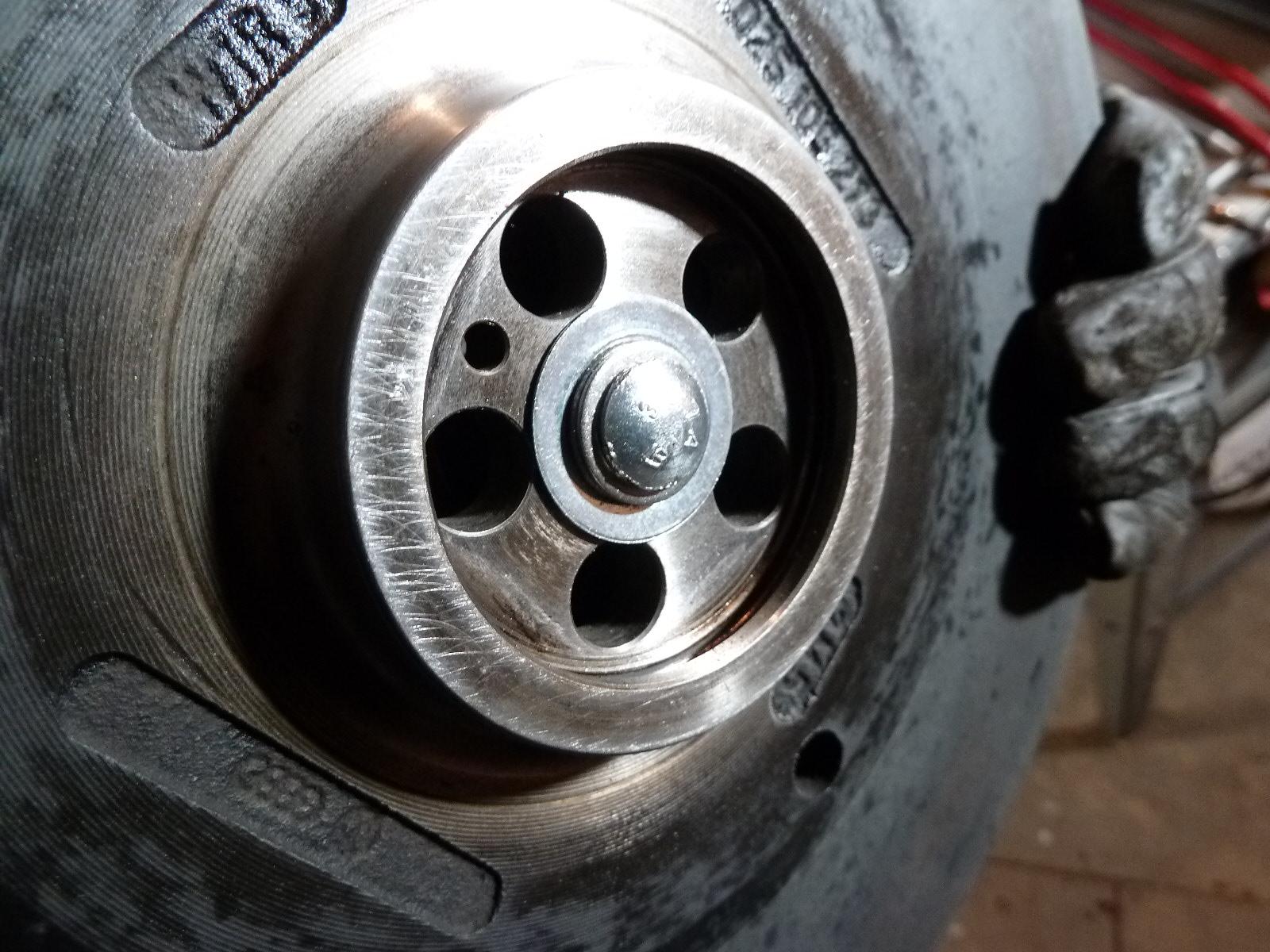

1) Got myself a $5 rubber 3M "Disc Pad" (used for circular sanding discs with a power drill):
2) Used it as an arbor to mount the flywheel (the rubber helps grip the flywheel & keep it centered):
3) The concave mounting washer provided also helps center on the pilot shaft hole:
4) In place of the small screw provided with the pad, I used a 1-1/4" stove bolt
to allow for the depth of the flywheel, plus a few washers to take up some slack.

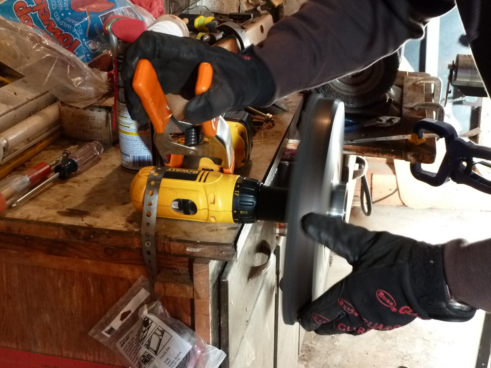

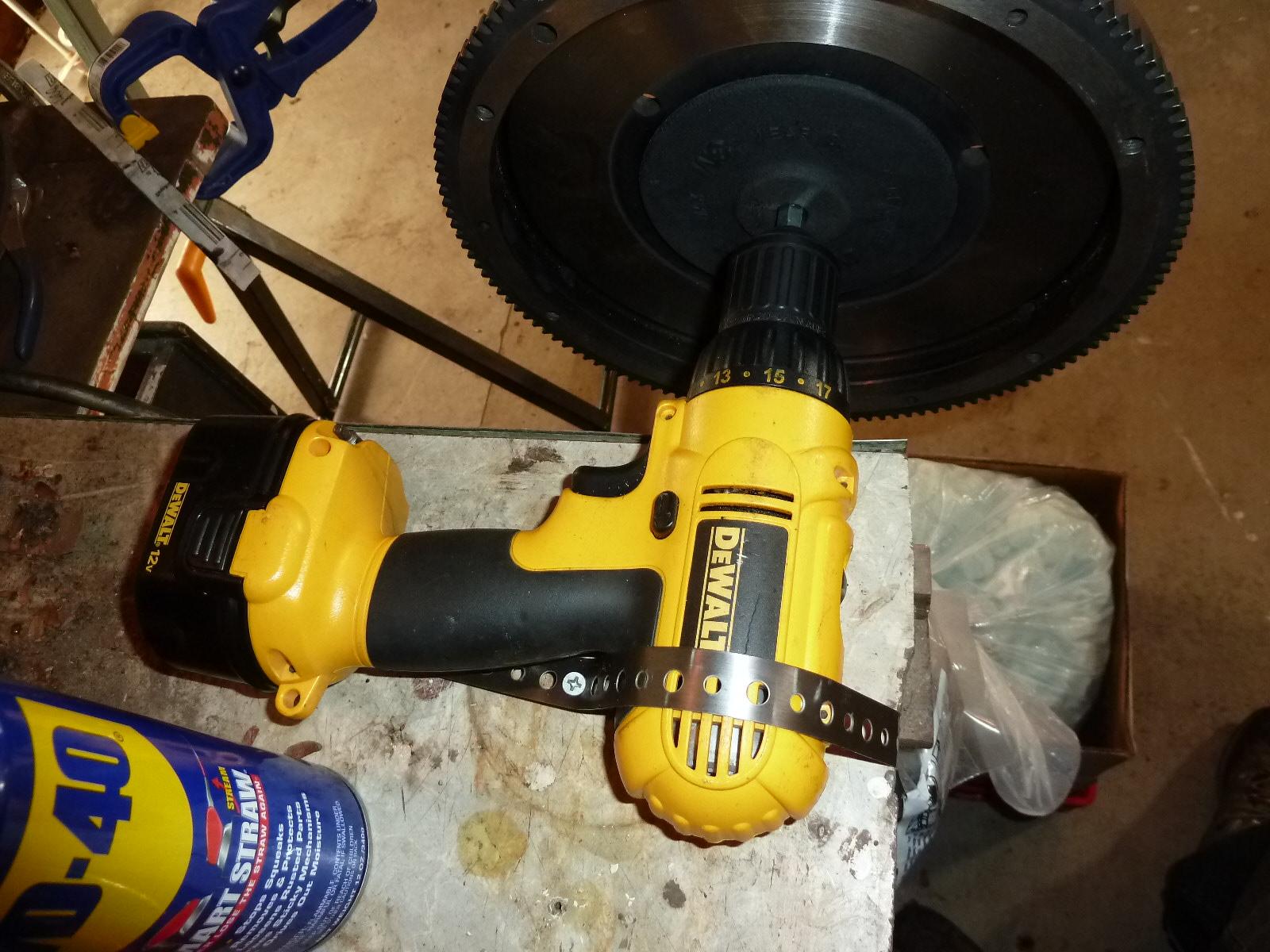

5) Mounted my cordless drill to a spare work surface (did I mention I'm cheap? Wink ):
6) Used a spring clamp to lock the trigger (using the slow clutch setting):

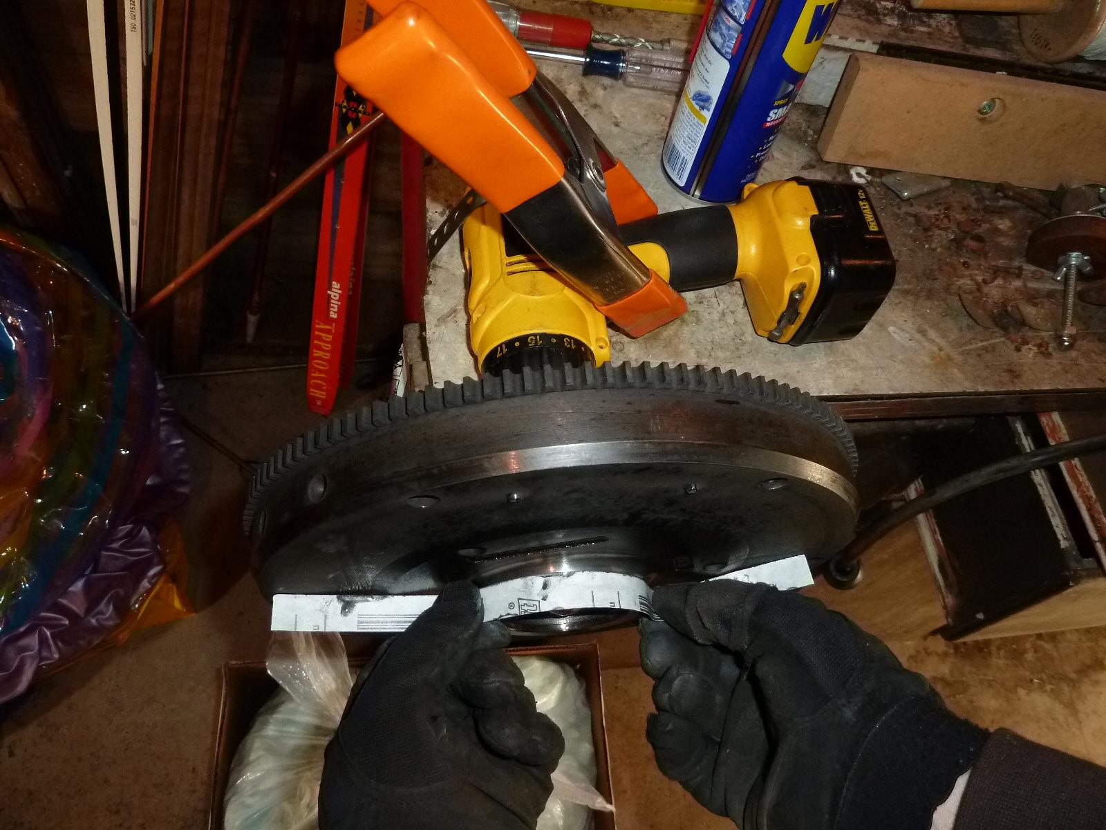

7) Just as described by tencent: a bit of WD-40 to float the swarf, and about 5 minutes with a narrow strip of each successive grit
(50, 80 & 150-grit emory cloth, then 220, 320, 440, 600 & 1500-grit "wet-or-dri"):

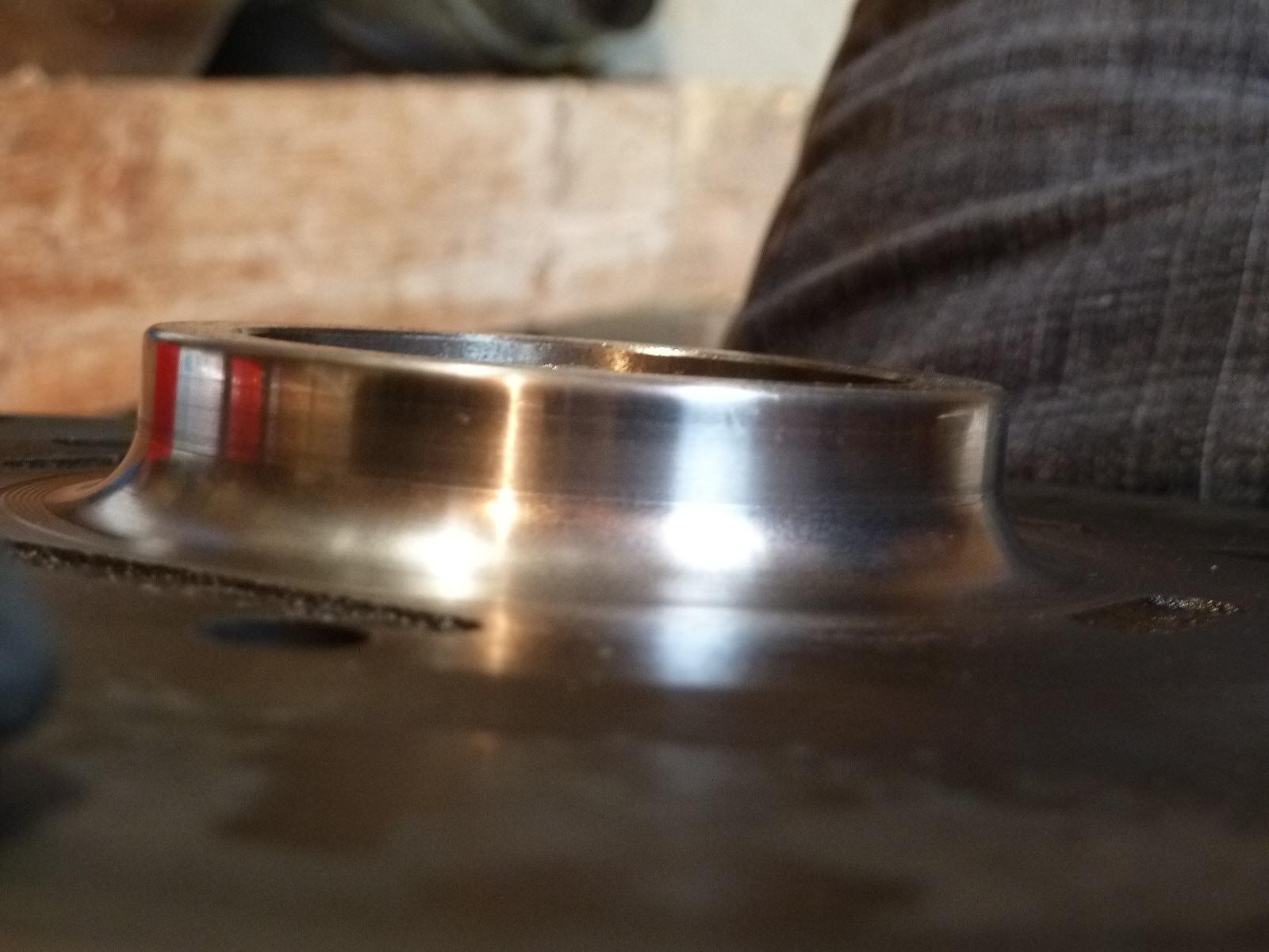

8 ) Here are results after the 600-grit, with 1500-grit yet to come:
I managed to kill both of my batteries in just under an hour, so I decided to call it a day and finish up tomorrow.
(By this time it was also a little past beer-thirty - another perfectly good reason to save some work for later...)
I plan to finish with the 1500 wet-or dri & then go completely anal with a round each of rubbing & polishing compound...

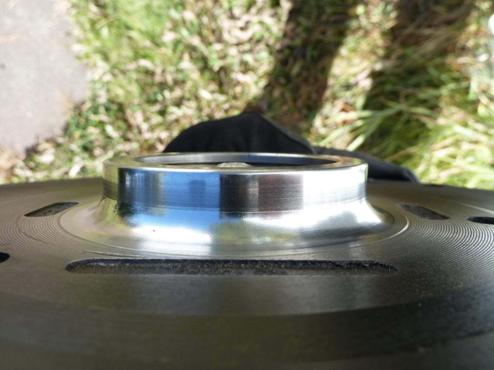

FWIW - finished the process today and I'm very happy with results:
This after finishing with 1500-grit, plus rubbing- & (finally) polishing compound*.
It's clean & ready for a new seal and many more miles...

another reason to do it this way is, it's fun.
the flywheel seal dia does seem like a good point though.
build it back up with a mig and spin-grind it back with your drill-lathe and a 4.5" grinder. problem solved. Smile
I would probably put the drill motor in a vice.
the safety measure assumes when things let go, they will go straight down to the ground. but actually, if the flywheel shifted off center enough to be a problem it would wobble until it flung itself sideways. often what happens is the arbor of that sanding pad will bend, because it's just wimpy mild steel. then it all goes south....err east or west. Laughing
not that I don't approve of the process. I might have used a grade 8 bolt/nut/washer and maybe a wooden disc.
would it have been possible to fill that groove with JB weld and sand/polish that ?
