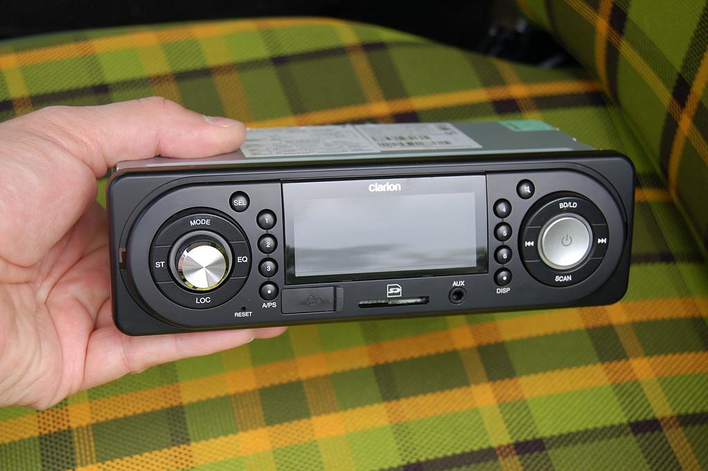

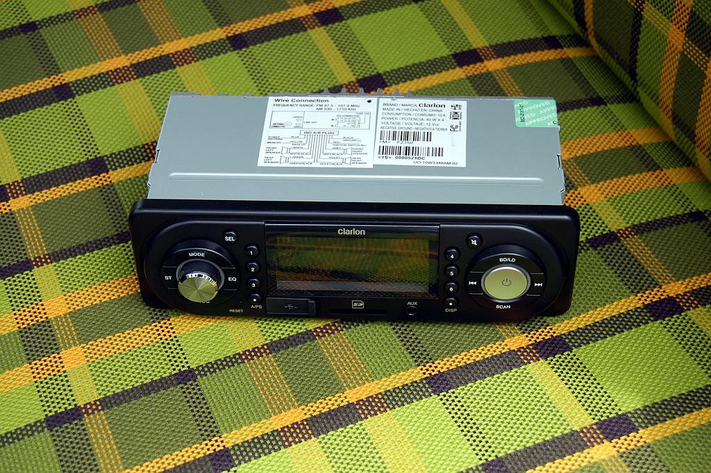

I wrote about this last night in my build thread , but wanted to post it in its own topic so people that need this solution can find it.
If you have a late bay with the type of underdash KCOOL Air Conditioner that uses accordion hoses to connect between the two sides, the short hose loops over the ashtray housing and this severely restricts the depth available for the radio. What I'm about to say ONLY applies to this configuration.
If you're thinking of installing a new(er) radio, you're 99% sure to run into a problem. Nearly all modern radios are about the same depth, and that depth will not fit in the available space.
Now, if you're bent on having a CD player in-dash, well good luck to you. There's simply not enough depth available. But, if you're willing to leap fully into the modern digital age (MP3s on USB or memory cards), there's an inexpensive solution that may be one of the shortest depth units out there. It's a Clarion FZ150 and it's only 3 1/4" deep. *Link to mfgr info* *Link to Amazon*
Like any modern DIN radio it won't quite fit in the stock dash hole, but careful work with a dremel cutter on the dash opening can make for a perfect fit.
Yeah, I know ... you can always keep an old radio or blank plate in the dash and an iPhone/iPad/Android in the glove box. I present this as an excellent alternative.

Posted: Tue Jul 30, 2013 8:14 pm Post subject: |
scrivyscriv wrote: |
I never knew anyone made a radio that size! Thanks for linking it. Looks like a deal - wonder if it sounds good? Do you have a pic of it installed? |
Yes. in my build thread Scroll down a little from there and you'll see it installed.
I only have it connected to the door speakers the bus came with so can't say what it's capable of sounding like, but it's rated at 40W x 4ch.
type2much wrote: |
Nice looking radio. What are the wiring connections like, was that part easy or no? |
It comes with only about 6" of wire coming out of two connectors, one for power, one for speakers. Built in fuse. Obviously the first thing I had to do was extend the wires. It's not any easier/harder than installing any other radio in a bus I'd think as there isn't a factory harness you can just plug into. The hard part is deciding where to tap into power/memory power/ground. I got lucky that the A/C relay provided connections for both powers.
