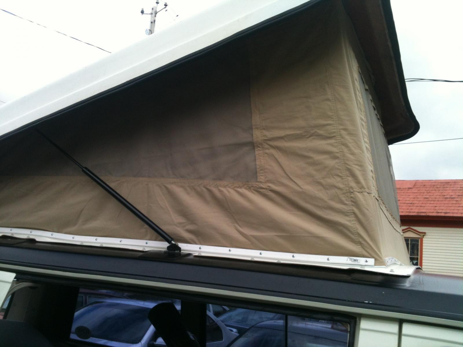

Nice. Looks good. It almost looks like the top is still hitting the van at the very back when the top is up - optical illusion? The lift bar design looks excellent. Combined with the shocks, that's better than the Westy design. You ought to add a link to further information...

Libby- only the bulb of the seal is touching when the roof is lifted. I am working on producing these, finding time between other work can be tough. Once ready I'll post an ad.

Thanks Jackbombay, believe it or not, I had a set of your shocks on the prototype. Without the spring loaded liftbar that the Westys have, they were not strong enough. After trying a ton more, we ended up using much longer ones and reversed the angle at wich they lift the roof.

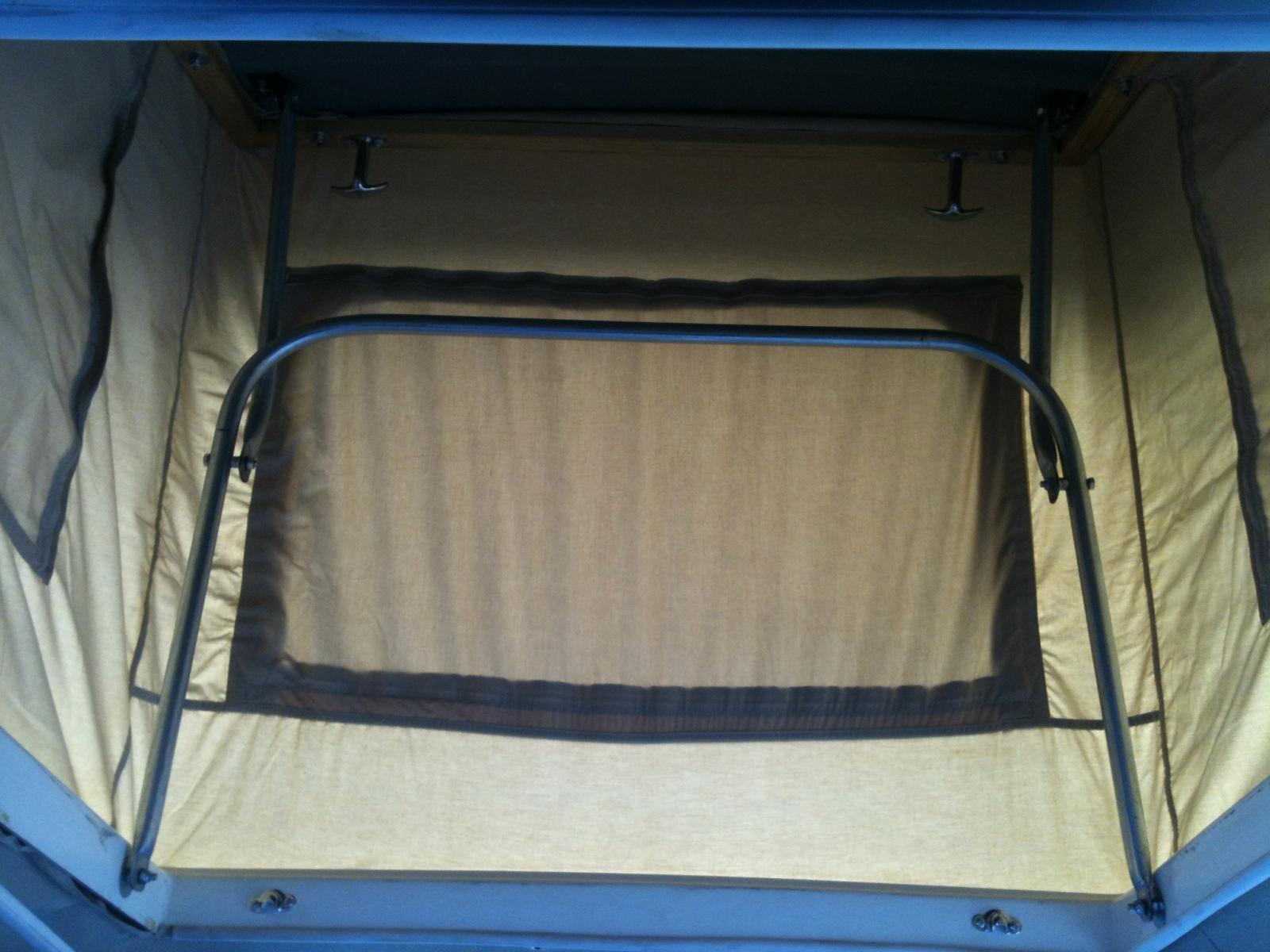

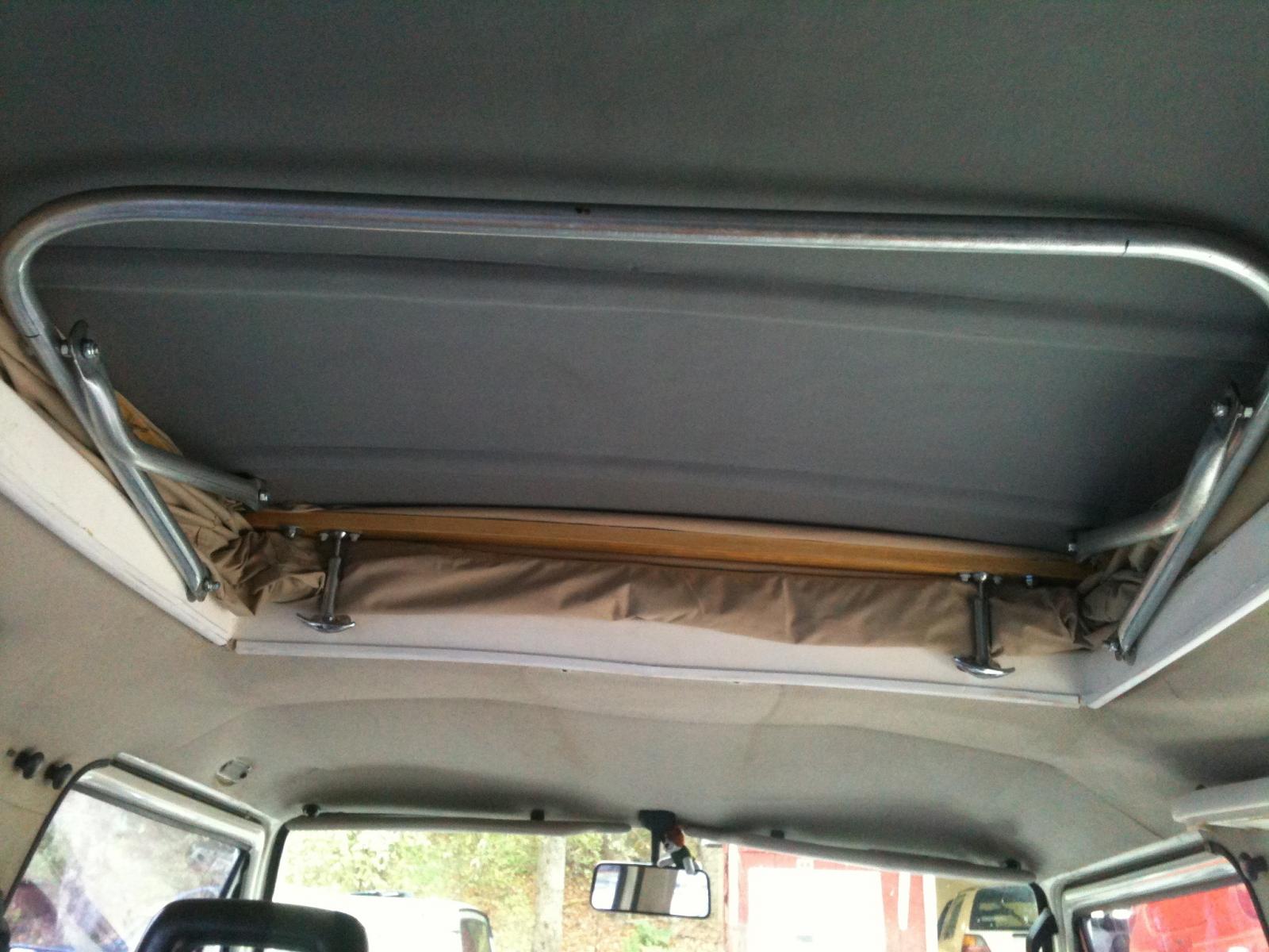

DLJ- Thanks, I really appreciate that. I just took a look at a Westy lift bar, I think it could be adapted but you would probably need to shorten and narrow it along with change the way the bottom of it attaches. I think in the end it would be quicker to copy the picture of the one I made if you have something to bend tubing with. You will find any small change in dimension on the lift bar affects every thing, the height it lifts to, the location of the push up bar when roof is down, the amount of "latch" it makes when roof is up and push bar is pushed forward to lock it.

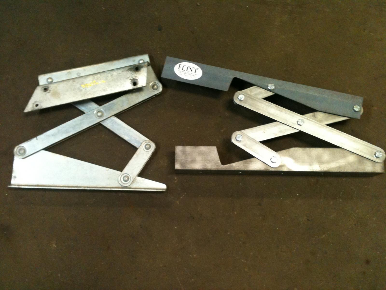

Westy hinge to the left, Flint hinge to the right.
