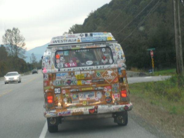

That added hose from under the bench sounds odd, I don't do Facebook so unless you are willing to read this: http://www.thesamba.com/vw/forum/viewtopic.php?t=6 and post some pics I can't help.
BTW here's the pics from the ad:

Pancake_Repairman wrote:
Whoa. This thing runs great!
I've got 5 days of permit on it starting today. Could I ask a couple questions?
What is that pan in the center and below the front bumper? If you know the name it'd help me search posts.
I see a hose from the heater fan (it was cold tonight) coming into the bus VIA under the bench/bed. It looks like everything is missing. Ever seen any links of ducting photos? I'd like to get the heat to the windshield.... eventually.
I've having a hard time posting photos. You can facebook kelley deon if you want to see a photo I guess.
Your bus probably started with two hoses underneath that brought air up through the cabin floor. What you want to do for now is make sure the diverter valve which directed air through these hoses is closed off. I just remove the cable and wire mine as the cable is a source of trouble and on most buses no longer functions. Actually disconnecting the cable front and rear is the way to go and then fixing the cable from the control lever down to the defrost diverter on the heat/defrost tree under the dash.
You also might as well pull down the center tube and look for mice nest. I am pretty sure I must have some mice debris in mine this year as the air volume is down.
