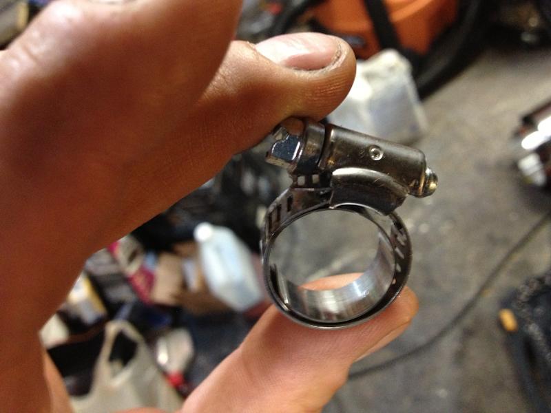

Total cost about 380 with six feet of hose. I added clamps to each push on fitting for extra security.

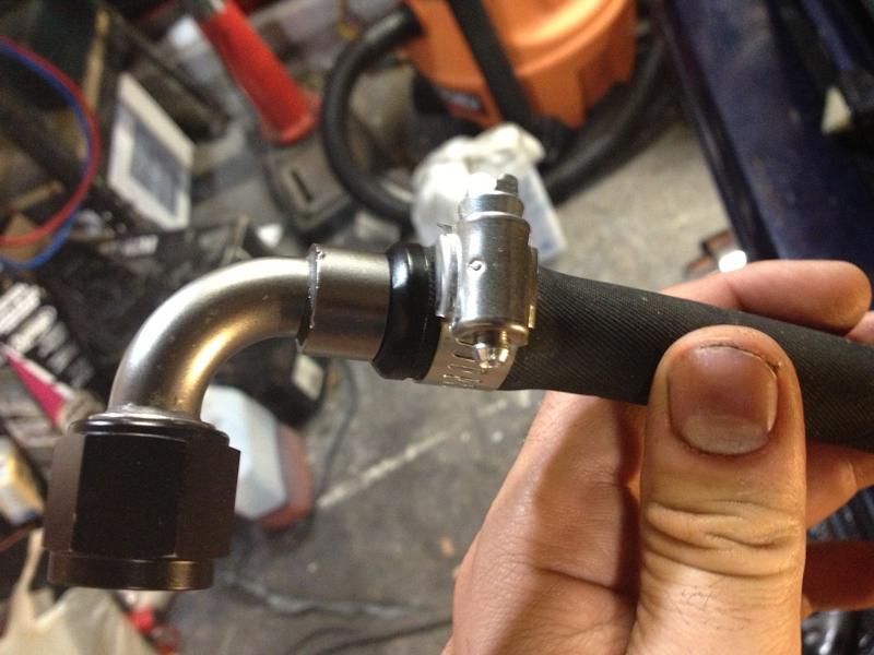

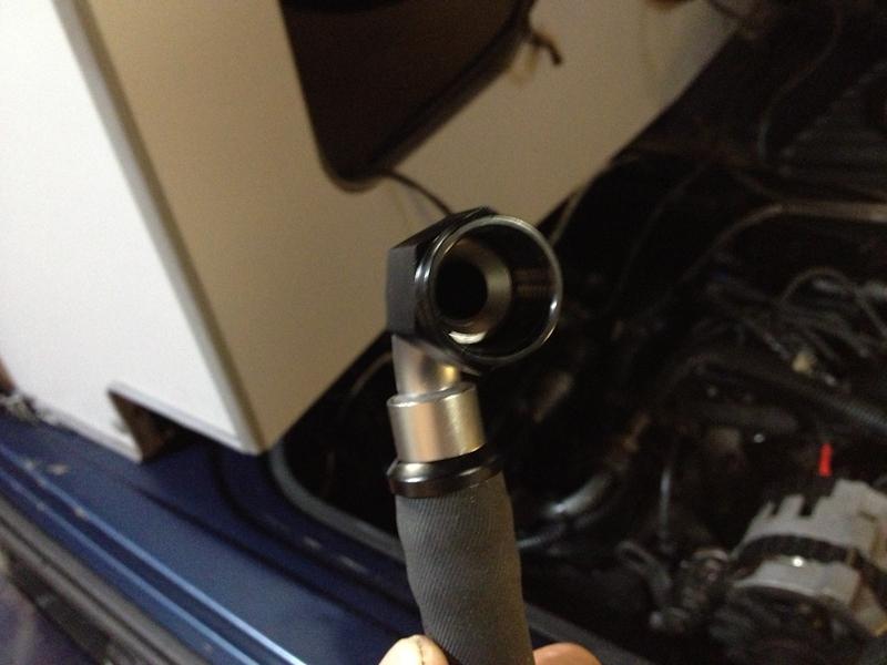

To make hose assembly easier, here's a few tips.
1. Use dish soap (not oil!) to lube the press on fitting. I've mounted it here in a vise, sitting on the garage floor so I could add my weight to the hose whilst sliding it on. I heated the hose with a heat gun for a few seconds, then just slid it on with a few wiggles. Very low effort this way.
[img]http://www.thesamba.com/vw/forum/album_page.php?pic_id=979885[/img]
The almost finished hose:
Adding a lined stainless clamp. Note the inner lining. These came from the local Parker hydraulics shop:
The bulletproof finished hose:

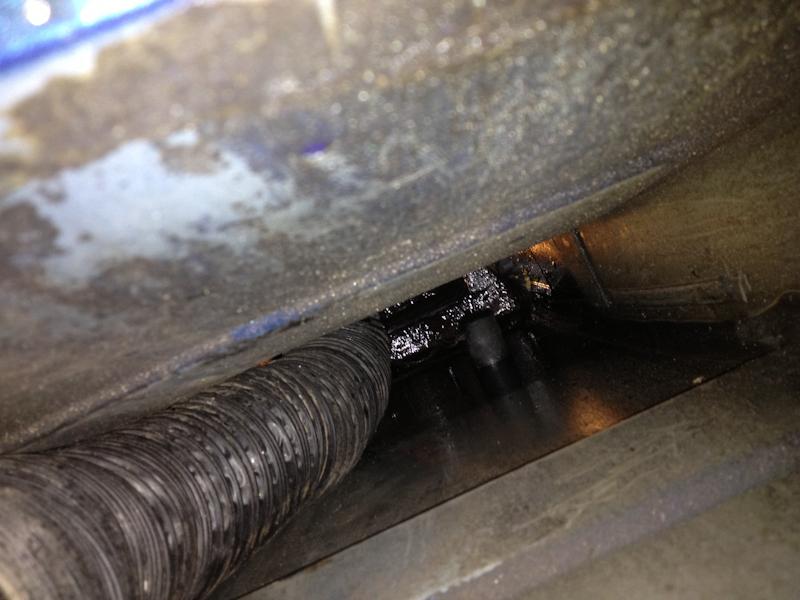

Here's the intake snorkel:
Installed on its rubber isolators, the snorkel is hidden from view from the outside. Here's the view looking down towards the bottom of the vent. The tube on the left connects my intake box to the stock snorkel. The original intake tube collapsed on the conversion's maiden voyage 8 years back creating quite a mysterious decimation of performance. I've cut a hole at the base of the passenger D-pillar which will direct air over the cooler.

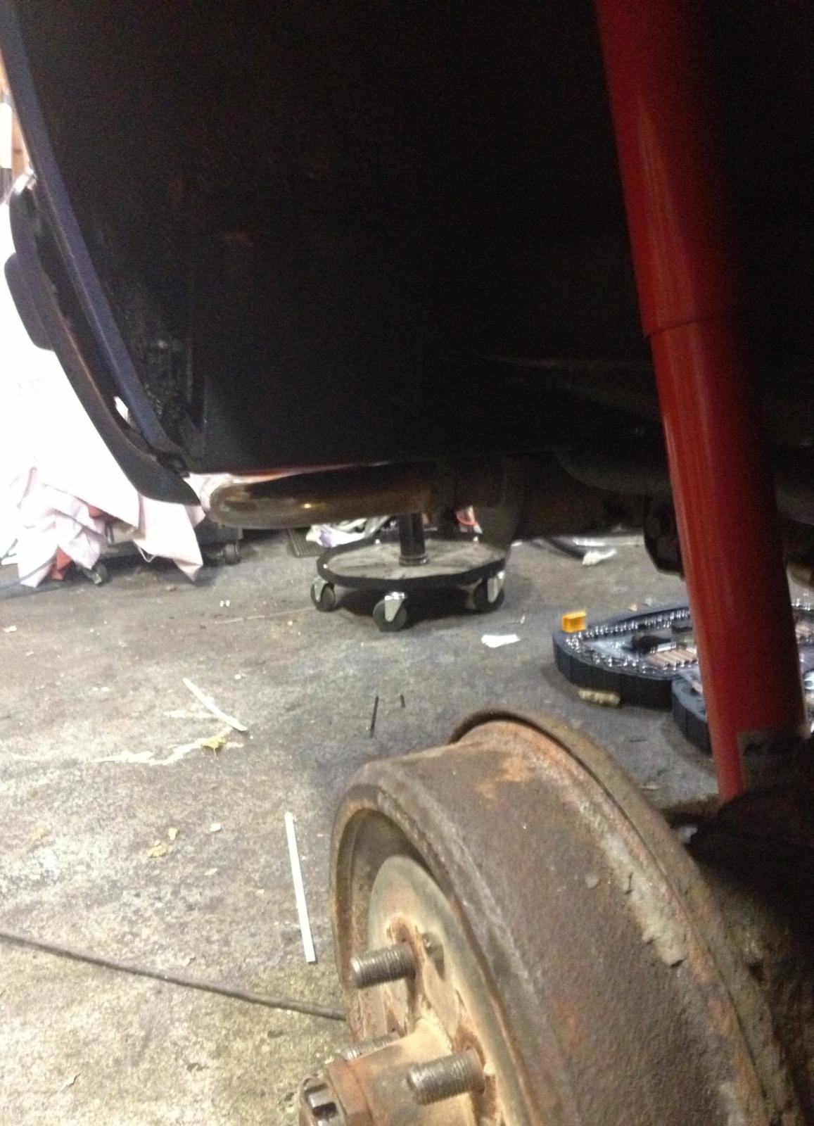

Here's a view (don't mind the KROWN sprayed everywhere...it's messy) through the passenger tail light opening. The hole is about 4" x 12". The metal in this area is very thin, so very easy to manage via tin-snips or similar. I used a 3" hole saw (with carbide cutting surface) first to make things easier. The silver thing at left is the air box/muffer box slide forward. It's now lined with accoustic insulation retained by wire mesh, and wrapped with dynomat. The intake is very, very quiet Smile

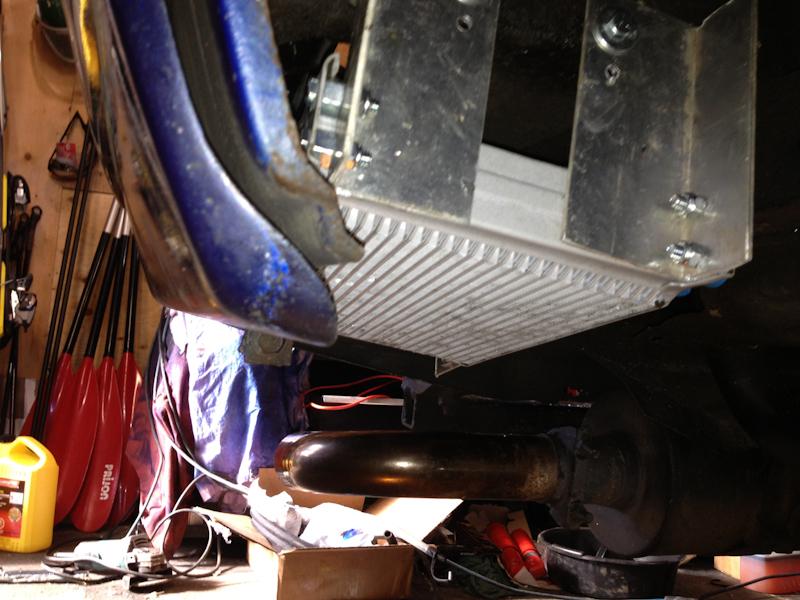

Here's the oil cooler behind the passenger rear tire in the fender cavity, perfectly sized for it. What you don't see here is the aluminum sheeting added to force cool air through the cooler. Also coming later is the alumumum plate that protects the cooler and vents the hot air to the rear of the vehicle where low pressure will "suck" the air from the cavity. Air flow is therefore from the high pressure area at the engine vent intake, exhausting to low pressure at the rear of the vehicle. At idle, the air flow will reverse via convection stack effect and importantly, keep 100% of the hot air isolated from the engine bay.
Without taking things apart, the mounting detail seems more complex than it it is. Both the accusump and the Mocal plate use a fitting which has female/male 3/4" thread which slides through the plate...allowing you to index it where ever required, before tightening. IF you were not using the Accusump and also removing the stock coolant/oil cooler you'd just need a short 3/4" nipple to screw into the block. The female/male mocal fitting at center threads to the nipple and you're good. If you were just adding the mocal plate to a stock configuration, then attaching only requires the 3/4" Mocal fitting. It attaches about as easy an oil filter.

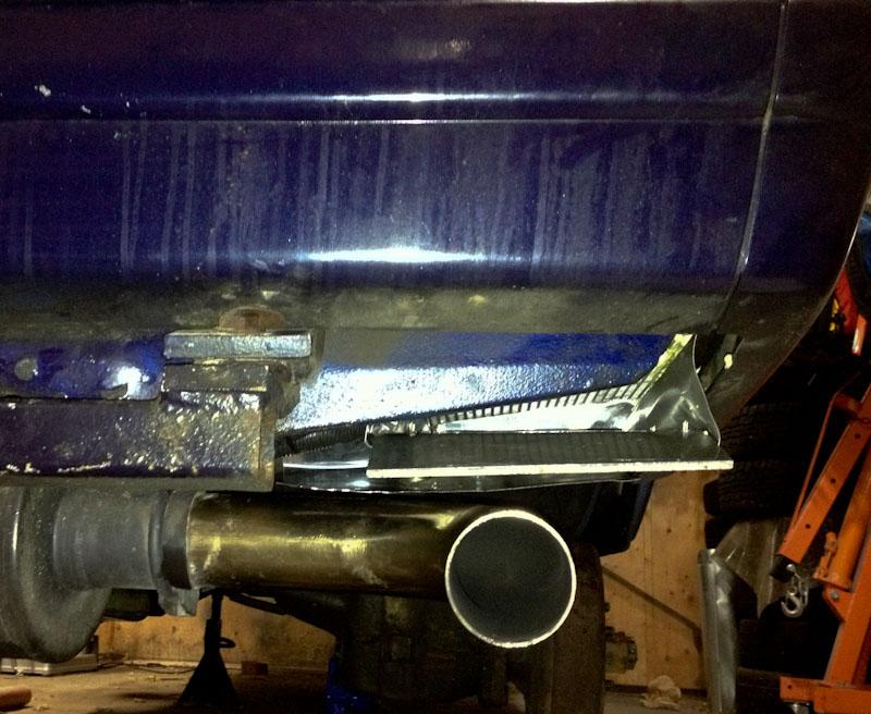

3/16" plate aluminum. It encloses/protects the oil cooler 100% and forms the air box that directs oil cooler "exhaust" to the low pressure area at the rear of the vehicle. Otherwise the cooler would be destroyed pretty quick back there. More pics later.

From the rear, the early tin work. The lighter aluminum sheet is just there for air flow, the 3/16" plate is there for protection from the rear wheel. You can see I've angled the oil cooler exhaust exit down a bit to make sure a low pressure zone will exist there at speed. We already know that the engine rear "air intake" vent louver has good positive pressure at speed...so I would predict very good flow thru the cooler, high to low pressure. You can also see why the oil cooler's heat output is completely isolated from the engine compartment.

Got the replacement cooler in place and all buttoned up. Here's the rear fender area with the cooler air shroud/shield in place. Basically you can't tell it's there unless you peak under the rear bumper where you'll see the air exit for the cooler. Note the nice new Koni now installed too. The rears were easy, the front a nightmare as the shocks in there did not have the allen head..it's a 6mm flat which is incapable of holding the rod as you back off the top nut. Ack. Ended up drilling a hole all the way through the shock so I could put a bolt through the shock/tube assembly and hold it from spinning.
