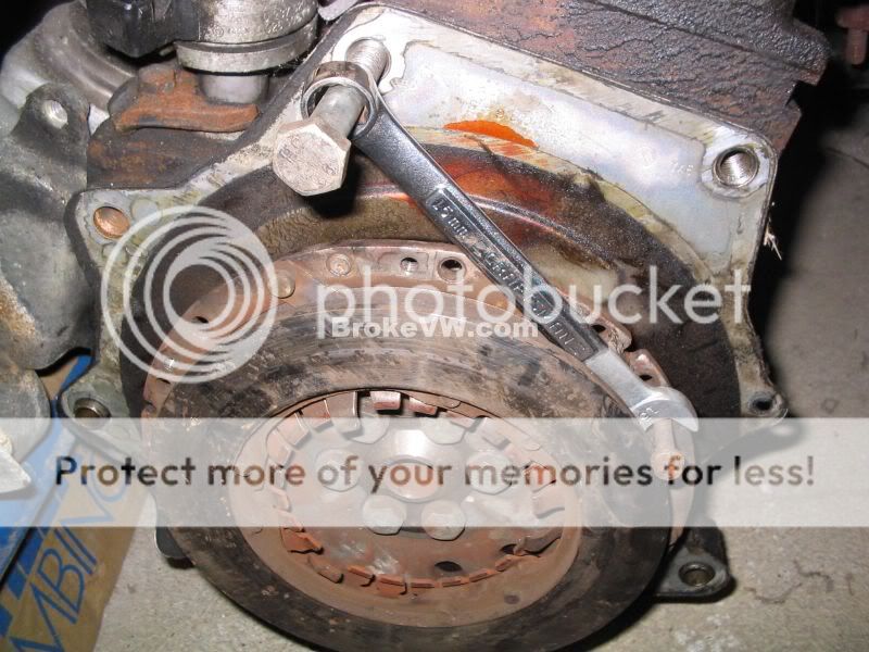

PostPosted: Thu Oct 18, 2012 5:09 pm    Post subject: Flywheel Lock Reply with quote
I went to Google Images and googled VW Flywheel lock. I thought this one was pretty clever. Good Luck.

for a flywheel lock use a wrench like shown but use spare grade 5 or grade 8 bolts. Don't sue the captured nut. Keep the wrench close to the case so the force doesn't bend the bolts or crack a flange. I'd send you a lock but it would not make it by Saturday.

Using the wrench as shown does lock the flywheel to the case but doesn't do anything to secure the engine from turning cartwheels when you put the big wrench on the gland nut. So the wrench as shown really doesn't do anything. You want to lock the flywheel to the floor and not to the case. Wink
That picture from BrokeVW is a Rabbit engine, not as much torque as a T1 gland nut The wrench trick would probably work on a T4 or WBX engine, but I'd be concerned about bending the bolt/stud -- the bolt in Broke's picture is a 12mm threaded into iron, the flat-4 "only" uses 10mm and through/into aluminum or magnesium.

I wouldn't do it that way either on a T'1.
