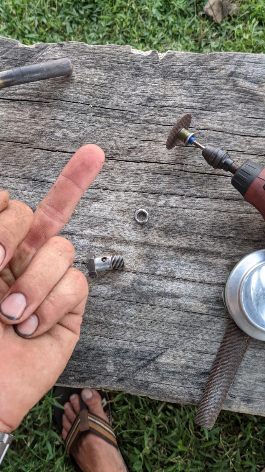

I had some clutch issues a few months ago in El Salvador stuck on a beach with my van. Pilot bushing for the input shaft was at fault ( a custom made part that turned out to be a downgrade Mad )
I was playing with slave cylinders.

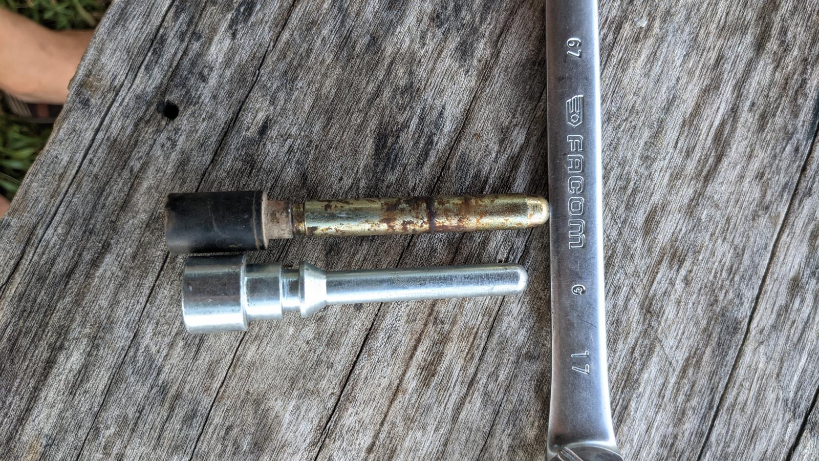

Like mentioned above, original VW slaves made by FTE or ATE differ by pistons and rod pairing from the aftermarket.
I tried a longer rod to gain more travel, it doesn't matter, as you just compress the cylinder inside the slave while static, the travel remains the same, given by the master cylinder.
It is worth noting the arm on the bellhousing is clocked differently between gasser and diesel. I have a gasser arm on a diesel bellhousing, and indeed it doesn't change anything, you just work the slave more on the last part of the travel of the piston rather than the early part of the travel. Still works, at least for me ( single mass flywheel and clutch, and I later switched to dual mass flywheel and clutch).

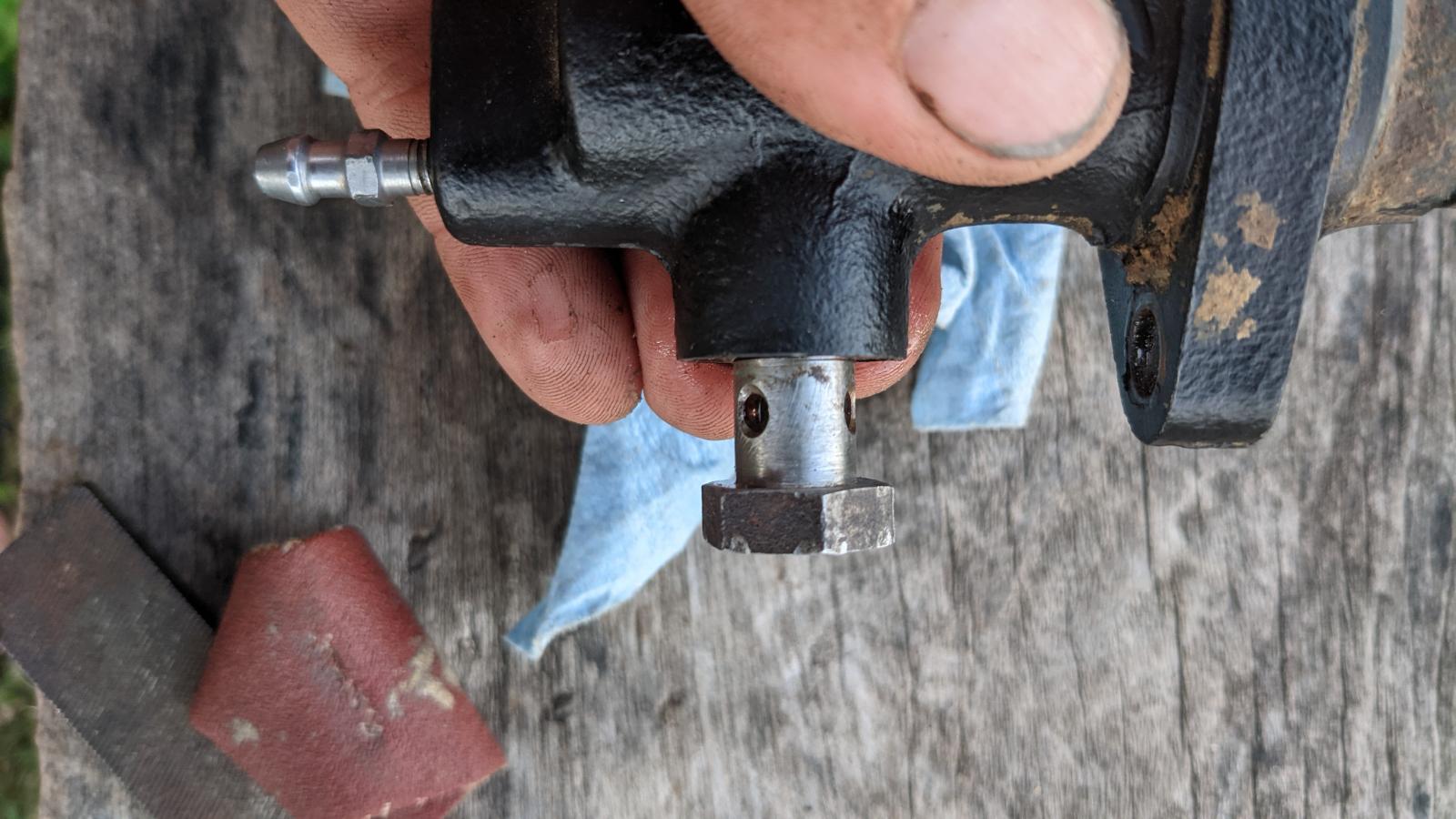

It is worth noting the Topran brand slave cylinder is not threaded deep enough to accomodate the Syncro factory banjo, the seal washers don't get crushed enough and it pisses like a sieve. I had to cut the banjo bolt with a Dremel on the beach.... Rolling Eyes
Syncro banjo bolt in Topran clutch slave cylinder
Same in FTE slave cylinder
I annealed the crush washers and rubbed them on a file. I was going nuts bc it kept pissing fluid just sitting there! It took me a few times to understand...
Then I cut the bolt
FTE rod vs Topran rod. Don't mix parts and you'll be fine. In my case I tried mixing them, it was still fine Laughing
35 years old ATE factory rubber cap vs cheap chinese rubber cap from Topran
