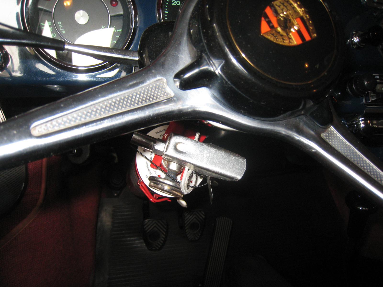

If the extinguisher is not secured in some fashion there is a risk (slight?) of it becoming airborne and thus a missile in the event of a crash. There were some threads on the Registry forum about means of installing an extinguisher along with opinions on the best location quite some time ago - searchable if you're interested.
I fashioned a rather crude method of securing it to the steering column using the Halotron "quick release" mounting that is in the photo in this thread and a couple of hose clamps protected with some old fat tire bicycle tubes. It doesn't rattle, cannot be hit by my knees or legs and can be dropped from its holder into the hands of the driver instantly in the event I need it. I think that there were photos of "more artful" installations on the other forum. There would HAVE to be more elegant solutions than mine.

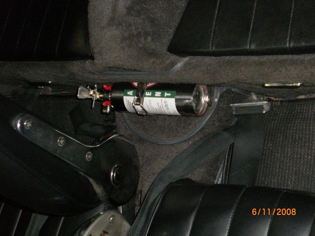

356JAEGER
Joined: May 19, 2007
Posts: 444
Location: Norte California
356JAEGER is offline
PostPosted: Tue Jul 03, 2012 8:27 am    Post subject: Reply with quote
As I have stated previously on this topic on that 'other' site :
A. Mount the extinguisher in a readily accessible spot. My preference is
either between the seats on the shift linkage cover or under the dash
on the passenger side. Mounting it on the steering column provides
the chance that the release clip could be inadvertently released, dropping
the extinguisher into the drivers footwell, a remote but very dangerous
scenario.
B. Always spray through the deck vents, do not open the lid as it wastes
time and provides more oxygen to the fire.
C. Never leave the extinguisher (or any other heavy object) loose in the
interior as it can become a missile in the event of sudden change in the
vehicle's velocity.
Porsche number 1 has it mounted where I mount mine. If it's good enough
for # 1, it's good enough for me... Wink
Regards,
Joel Jensen
When in doubt, think about it..
The outcome of a project is directly proportional to its preparation.

Pat: I'm submitting a couple of photos. Joel's photos (and for that matter his car) are better than mine. Alex's extinguisher appears to be mounted toward the passenger side of the column. Mine is right on (bottom side of it that is) the column. Joel's remarks about an inadvertent release of the extinguisher are cogent and I have seen them before but I decided I am very unlikely to somehow pull the release so I opted for the extinguisher being closer.
By the way, Joel, would you mind elaborating on what you made/did to match the #1 mounting? You might change my mind, although my wife would prefer that if the extinguisher is knocked loose by one of us that it fall on my foot on "my" side of the car (which, under California law, she reminds me, IS community property). Very Happy
This pic is taken fairly close to peering directly down the column while still permitting a view of the extinguisher. Yes, the car is a survivor.
This view is from the driver's door opening. Yes the triple gauge is incorrect. Shudder. Wink

Thanks for the photos Bill, Joel and Ev. I would worry me a bit having that hunk of steel near my knees if I ever hit anything. I like the idea of keeping the extinguisher on the right side or maybe on the tunnel.
I would like to find one small enough to fit in the glove box. They used to make one that size, but haven't seen one in a long time. Meanwhile I have the larger extinguisher in my garage where it won't do much good!

Yup. I do worry, a little, about my knees and you're correct, Pat, for bringing that up. My excuse is that on the right side it will be my wife's knees. Guess who wins that one.
When you have time Joel, some installation instructions for your "right side" installation would be appreciated - who knows, Rosemary may some day come to her senses and throw me and the car out. I hope not though my knees might be in less danger. I can't jump and never could anyway. Very Happy
