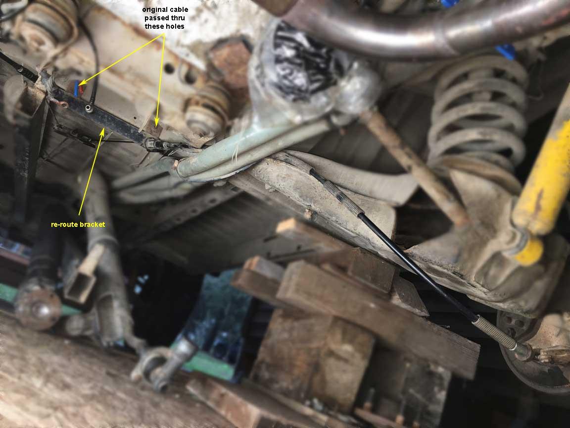

So I concluded that my parking brake was dragging because the spring on my new disc brakes was not sufficient to return a permanently bent cable core thru the horrific angle in the brake cable routing.
This angle, is a LAME design. (It's a VW design, not smallcar). These are new brake cables, that were bent upon the first use. I bent the core back to straight then went about changing the angle to point the cables in the direction the cable wants to go.
The photo shows what happens when you pull the emergency brake, tightening the cable. It makes the shortest path which is too sharp of an angle for a cable.
The smell of a project wafting about..... Here are the new bracket dimensions.
Here it is installed. The flanges bolt thru the original brake cable holes, using large washers. (oops, image error) If you have other larger holesaw sizes you can cut thick washers to cover the hole.
So back ti the question,,,, did this modification solve the "hooooop....hoooop" problem?
Well, the song has a couple less "oo's" now and more "......" ,
"hooooop....hooooop....hooooop....hooooop....hooooop...."
now it's
"hooop........hooop........hooop.......hooop.......hooop.........".
So not a complete success.....but
- the emergency brake cable now has a proper route
- it 'feels' noticeably better (less friction)
- it's not bending a permanent kink in the cable core.
....KTMs, GasGas, SPOT mtb

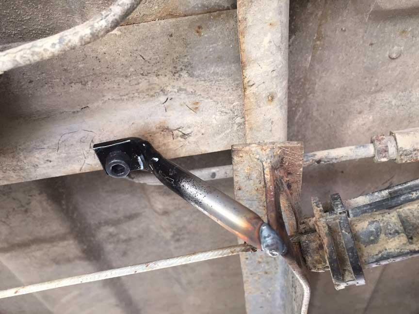

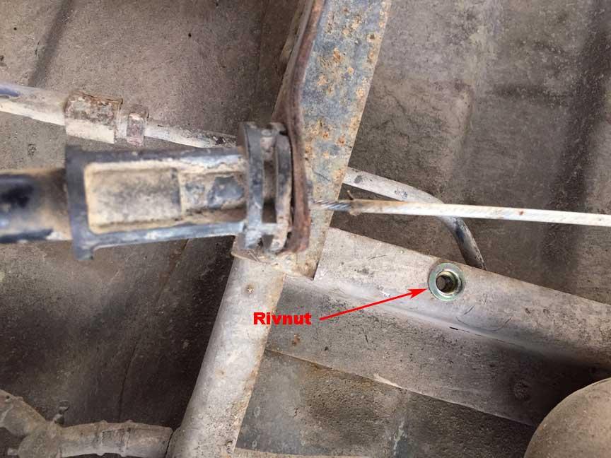

Six years later,,, a mod to the mod.
This has been a good mod, it really cleans up the routing of the long and somewhat troublesome cables. The Disc brakes return spring is barely strong enough to return the Vanagon's long cable contraption. Add poor routing,, tight bends, friction and the weight of the cables it just couldn't do it. With proper routing the springs are OK!
This item is a bolt-on mod, anybody could make this kit. I used riv-nuts for the brace. But the brace could simply be CLAMPED to the frame rail (no drilling).
I have my tranny out and decided to brace up my cable re-route bracket. The relocation created a much better cable route, which firmed up the brake action a lot. Buts since the bracket itself could flex on its mounting, even in better "feel" at the handbrake is available by eliminating more flex.
It DID firm up the handbrake - a little more than 1 inch reduction and it feels TIGHT!
Un-bolting the brace, then pull handbrake, you can see it moved about 4mm under tension.
Here's what the braces look like.
Construction details
Driver side (plastic moved for welding)
Passenger side (plastic moved for welding)
