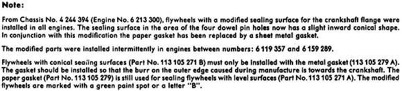

I'm rebuilding my first engine, an early 1966 1300 without the o-ring crankshaft. Should it have a metal or a paper gasket between the crankshaft and the flywheel? Thanks.

Idea The metal is a carryover from the 1200/40 HP engines.
I would try the paper and see what end play there is first. You can try the metal if it works better.

While the change did happen during the 1200 era, the change wasn't to the 40HP crankshaft, rather it was to the 6v/180mm flywheel. However, I'd not really be too concerned about it - I do the same as HRVW said above, use the one that wants to work best in setting up initial endplay.
FYI - here's the scoop on the the different gaskets:
