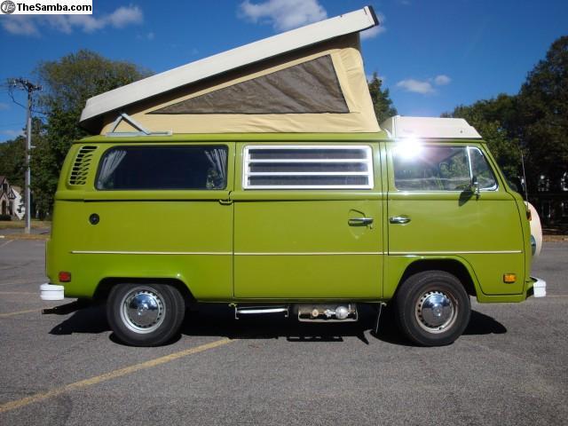

The view from the side.
It's got shiny, new-ish paint with relatively little dirt in it. That's about as complimentary as I will get. A keen eye will spot that the dogleg and rear wheelwell/battery corner is a somewhat different shade of green. This varies from not being visible to standing out like a beacon depending on what light hits it. There has been some rust repair, but it is surprisingly minor from what I can tell with a magnet and careful inspection in and around the affected areas on a lift.
Cheesy old vinyl stripping was applied along the length by a previous owner. Maybe it saved a few dings along the way. Rolling Eyes
The sliding door works very well.
The fiberglass top is pretty weather-checked, with minor damage at the front edge of the luggage rack.
It's got a newer tent installed, so that's at least one less thing to replace.
The propane tank is looking pretty sad. Nothing a beadblast and paint can't remedy, as the valves work and it demonstrably holds pressure without leaks.

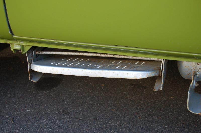

There's also some kind of aftermarket step that's been added. It was in even worse condition than the propane tank and has since been removed. Unless I find out this is some kind of rare option, it's going to end up in the trash.

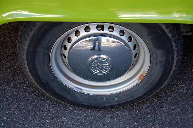

Here's a look at one of the wheels and hubcaps. The wheels definitely need to be sandblasted and repainted, but the hubcaps are in good shape. You can tell by the rust on one side of the wheels that this bus sat a lot.

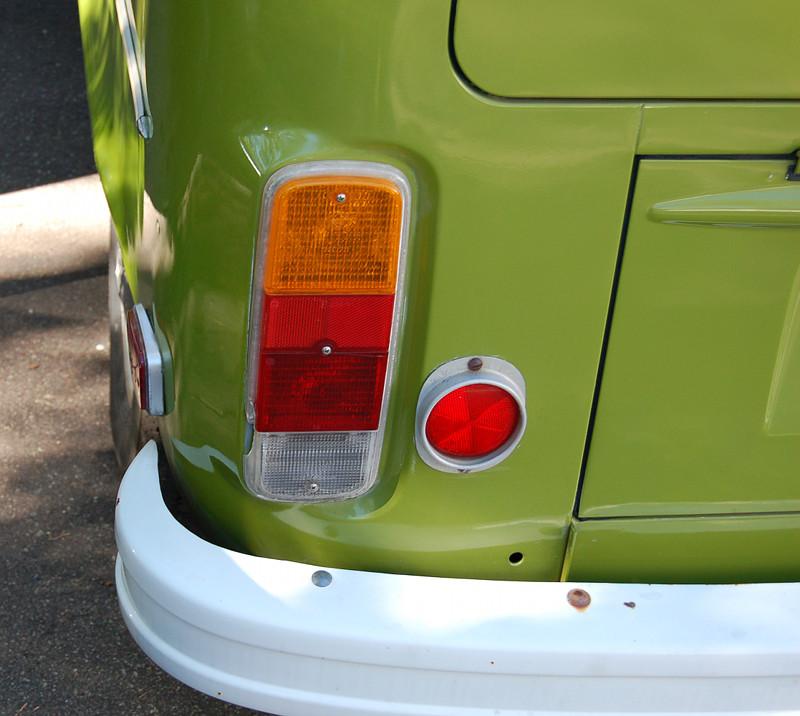

Coming around to the back of the bus, we find one of the first "cardinal sins". I can understand the tail lights are pretty small on buses, but driving sheet metal screws into perfectly good sheet metal to attach a trailer reflector? Twisted Evil WTF! Yeah, that'll buff out!
You might also notice the side marker light - only silver one on the bus and installed opposite direction to the RH one.

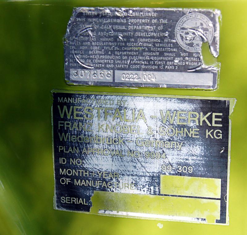

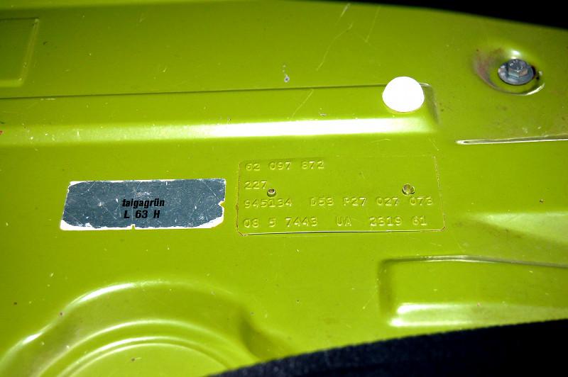

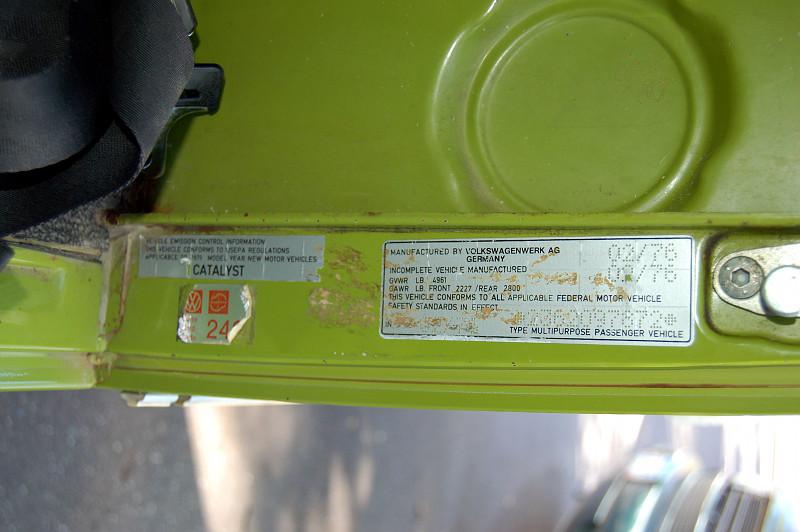

Despite a few one-off parts, at least you can see the M-Plate without crawling around the dash. Everything checks out just as it should. Legit deluxe Westy with Sage Green paint.
Almost forgot, here's the stickers just back of the driver's seat. No small table back there though (new one just arrived today!).

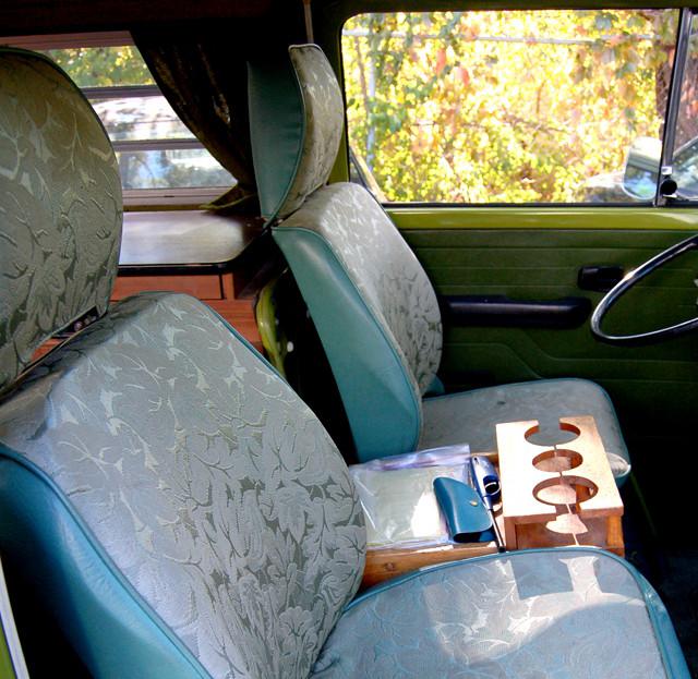

How 'bout those seat covers and custom middle box/cup holders !?!! Embarassed

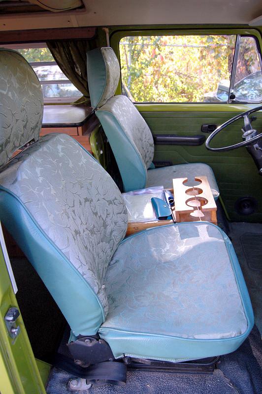

Here's the other side. Can't say the seats are any prettier from this angle, but I've seen much worse in the classifieds!

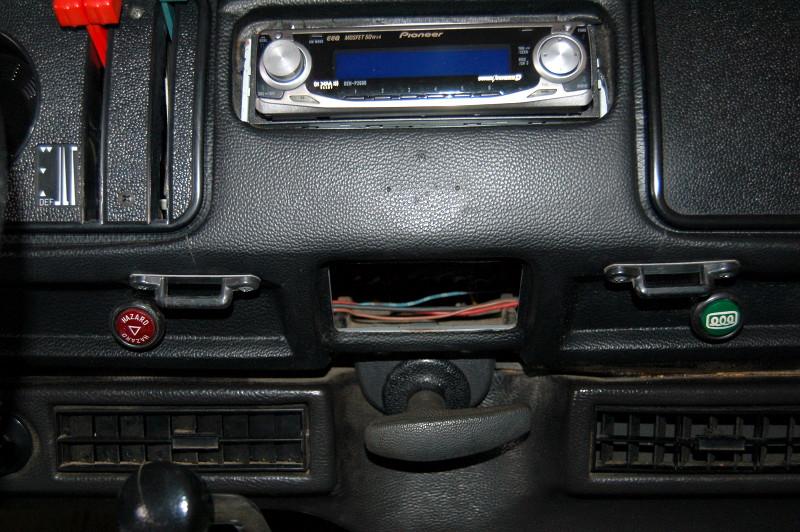

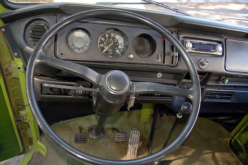

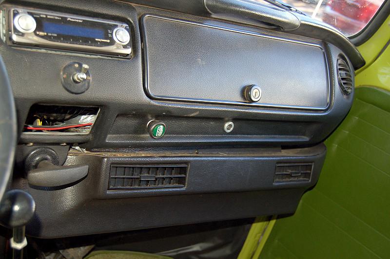

Back over to the driver side dash. Everything just looks kind of sad and neglected.
Lovely little swively thing immediately under the aftermarket radio, but the screws are small and just happens to sit right where a decal should be.
Missing emergency flasher knob, ashtray, front table support brackets, A/C vent, guage panel screw, etc ... but dash is in good shape with only very small crack. Steering wheel is another matter though.
Here's the right side of the dash. A/C clearly hanging off unattached. Turns out to be undamaged, just pushed down by ductwork apparently from to radio install. Not a lot of pride in workmanship there, Previous Owner. Rolling Eyes

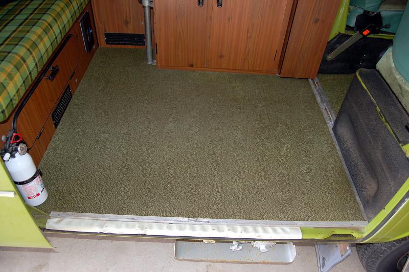

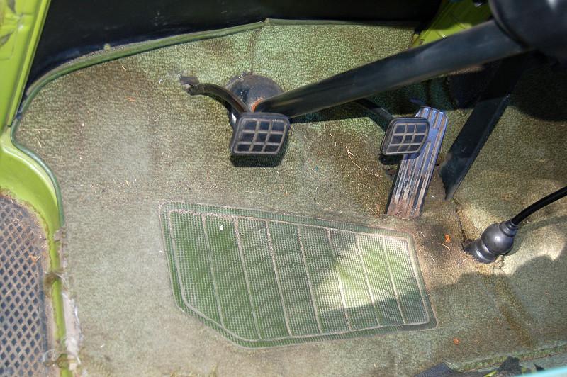

Carpet is original, for what the hell that's worth. Still, I'm going to pull that baby and see how far I can get it. No hope for that leftmost edge though.
Here you can see what I'm up against in terms of the kickpanels and carpet. The texture of the repro ABS kickpanels doesn't look anything like these originals. The cardboard material looks to be in good shape so I'm going to try to restore.

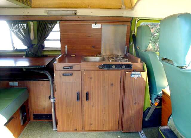

The veneer isn't perfect, but sure is better than a lot I've come across. The chunk missing from the tire door was found later and looks like it might glue in place pretty well.
Stove works, sink pump doesn't. Table isn't awful, but needs some help.

Original carpet. Actually greener than appears in photo. Seemed salvageable, and has actually cleaned up since nicely.

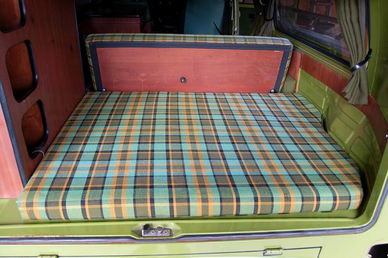

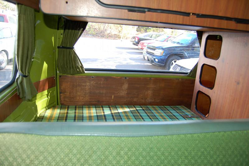

There must have been a competition to see just how many greens and patterns could be fit into a single camper. The owner has to have been in the running for a trophy. Embarassed
A look over the back seat reveals the first visible Westy plaid. It's sun faded, but otherwise in pretty good condition. The rear hatch panel is worn, but seems very restorable.
One other thing you might notice is that it has all of the original curtains and the retainers are there and in pretty good shape. When I bought the camper, the owner didn't think it still had its front curtains, but I found them after purchase tucked into a cranny.

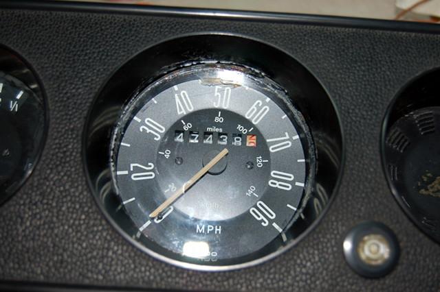

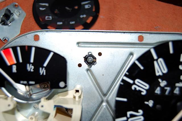

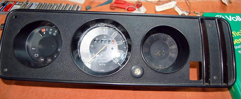

The first thing I did for our Westy was to order kits from German Supply to replace all the fuel and vacuum lines, along with new fuel filter and fuel pump. While waiting for this to arrive I began to fix the first thing sitting in front of me - the instrument panel.
The panel was kind of a disaster. Not all of the retaining clips were there, which allowed it to sit kind of popped out and at a slight angle. Some of the warning lamps weren't working, the glass over the speedometer was falling out and slathered in glue, and the blank on the right was missing paint and had adhesive residue from some odd thing long since gone.
Time to come out. During removal I discovered the missing retainer had fallen inside the dash panel. Lucky break - one less thing to have to find.
On the bench, you can see the shape it was in. The photo actually looks quite a bit better, as the warning lamp side glass was very dirty inside.
There had been a feeble attempt to re-attach the speedometer glass by trying to bond the glass face to the plastic. You can see just how well that worked. It took a lot of work to remove all of the glue and repair the original retainers to work as originally intended.
I stripped the whole works down, cleaned everything, stripped and repainted the filler plate, and finished off with plastic polish. There wasn't much that could be done for the emergency brake lamp lens. Why this hasn't been accurately reproduced is a wonder as it is a simple plastic part used on many model years and it seems they all should have gone bad by now. Sure would be nice to have this red instead of milky white. I also hit the heater levers hard with de-greaser to try to clean them up. They're better and they're clean, good enough for now.
Before I put the works back together I replaced all the lamps and used Ratwell's suggestion to upgrade the ones that light the gauges.
Here's the end result!
With all the lamps working I could see the EGR light on constantly. Pressed the button on the little box below and the light went off.
It's curious that there's also a place for a "CAT" light in the warning cluster. There is no wire and lamp holder in the wiring harness to support this light, and the little box near the floor doesn't have a reset button for the cat, nor a wire going to its connector for that purpose. Yet, this is a California bus, built Feb '76, and wears a tag in the door area suggesting it had a catalytic converter. It seems likely converters came before CAT lights.
Wrapped things up by rebuilding the emergency switch and replacing the knob and lamp. Also replaced the lamp on the rear defrost. Most recently found a pair of front table support brackets and put those back on.
I'm thinking of using an iron to flatten out those small screw holes left after removing the funny swivel thing just below the radio. The Westy warning label should cover them nicely.

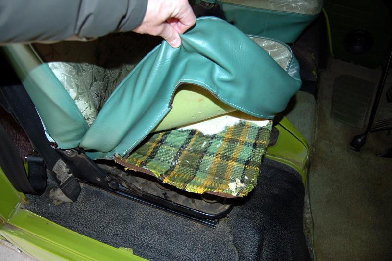

To the back seat (please bear with me, just trying to catch up to where things are at now).
Remember this sad vision?
I began poking around the edges of the cover that surrounded the rear armrest cushion. The cover was stapled all over the back so I was cautious, but as I probed I found Westy green fabric so I began pulling more staples expecting to find some damage. With the cover removed, I was looking at a very "pilly" and somewhat sun-faded original.
Emboldened, I tried the same tact with the lower rear seat cushion. Staple after staple I removed, all along expecting to find a rip, bad stain, or hole in the underlying foam. I found none and so just kept on going. It was a ton of work removing perhaps 200 hundred or so staples. The suspense was enormous as I really expected disappointment - why would the seat have been covered this way?
Hours later I was rewarded with the sight of good foam and only somewhat sun-faded original Westy plaid. It took a lot more time to vacuum, wash, and remove spots but I think it paid off nicely.
I also completely disassembled the seatbelts and soaked them clean. They were stiff from years of sitting and now nice and supple.
You can see the armrest foam has shrunk somewhat since new, but its good enough for now.
Lastly, here's a look in back of the seat. You can see the pad is pretty faded but it cleaned up well.
I used hockey-stick tape around the edge of the back seat fabric as recommended in a thread here. You can see its wider than original - there's a reason - I had to try to cover up the staple holes left by the awful cover installation. Can repair some day when re-staining that panel.
While we're back here, let's take another look at that carpet.
This is the result after spot cleaning and vacuuming. Haven't shampooed it. Not bad!
[EDIT: Oh yeah, got rid of that rusty step thing just left of the propane tank. Every little bit helps.]
