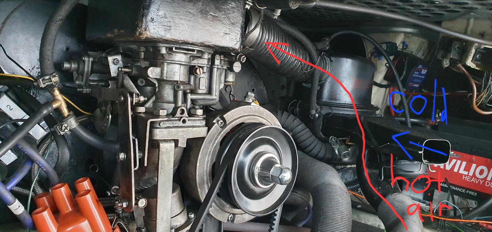

A side note, new "stock" mufflers have lazy preheat plumbing. (The mufflers are just built wrong compared to OG. See how the heat riser flow doesn't exit with the flow of exhaust gas? The heat risers don't even get hot on the freeway…) This German 34pict3 I worked on would NOT accelerate smoothly even with gratuitous accelerator pump discharge. Freezing cold intake manifold… Repairing the stock air cleaner preheat valve brought back smooth acceleration, and I was able to dial the accelerator pump adjustment back.
I just wish the people spec'ing parts owned tape measures and eyeballs, much less micrometers…

Muffler in question, doesn't get very hot:
NOS bus muffler from EB's gallery:
www.airschooled.com
I think I recognize that bus!
With the preheat tube in place and functioning that engine runs smooth and great!

A engine can only run properly, when it´s:
1.) mechanical sound
2.) ignition OK (at idling and up to the whole range of rpm)
3.) carb or injection system OK
4.) exhaust also OK
All and everything must be OK!
A new perfect carb or distributer alone is no match maker.
AND: the carb and dizzy must match, work together (vacuum range)
I agree. Everything I have done on the engine is standard and up to spec. I’m not sure about the dizzy, as it’s pretty old. The engine, I rebuilt from a beetle AR case, with new bearings after an align bore. The thrust bearing was recut. I then used my newish 1600 barrels and pistons from my old engine. The dizzy is a AJ dizzy so I am not sure if it combatable with a picture 34 3, as the engine had a little Empi carb on it when I got it. I used my Pict 34 after I cleaned it and rebuilt it. I’m waiting on a new dizzy to turn up.
A new aftermarket dizzy can be totally junk!
Many of them make 40 to 45° BTDC when static at 7,5°. For me, a absolute NO GO!
Imo, a good used original or a restored one is the very best choice.

Set your timing at 30-32° BTDC @3800+ rpm, hose(s) off and plugged. This will mimic high rpm, full throttle operation when you are asking the most from your engine. It also eliminates the effects of a high idle on your timing that mikedjames mentioned. Do not reattach the retard hose if the retard can will not hold vacuum, just leave it plugged off.
You should be able to see an instantaneous spray of fuel into the throat of the carb when you blip the throttle. Only takes three hands to do. Smile

Imo, this is a perfect way to adjust ignition with a defective or wrong dizzy 1000 miles far away from home.
When original a vacuum dizzy is installed, it should be the better way, going original.

This is the one that came today.

soggz wrote:
Hi. My bocar carb has probably only done around 2000 miles. I rebuilt it a couple of weeks ago, as I replaced my fuel tank which kept blocking the carb with rust from it. I will take the carb off and go through it again.
The same thing happened to me. Check your fuel filters. Also the idle/pilot jet gets clogged easily as well from rust that bypasses the filter.
If there is nothing wrong with your AJ distributor mechanically it should work fine for your application. I mentioned it earlier: Try running the Bocar without the retard hose attached. Also plug it at the carburetor. Time it as you would an SVDA, 7.5 at idle and 850 or so.
