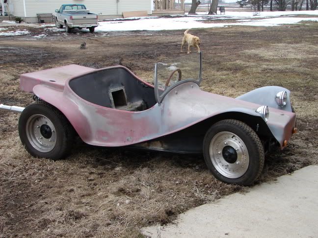

On my Mini T, I left the pedals in their original spot and moved the shifter back about 6 inches. Seating was sort of a lay down affair. Sloping back and a foam cushion on the floor. I'm 6'-2" and other than getting in and out, it fit me very well. That's our 5 foot tall daughter in the car so you can see just how low the seating was.
Here is a shot of the chassis. Floor framing was 1"x2" 11 ga. tube laying flat on the perimeter and a dropped floor of 14ga. steel welded to that.

I can see what you are saying about the sloped seat back, wow, you have to look for it in that first picture. So basically, the seat bottom ends somewhere roughly under the front edge of the dash? Now I'm wondering, can she drive it too? (obviously not on the street yet)
I had the pedals in the stock position when I sat on a plank across the top of the tunnel, with a coat rolled up for a back rest, and from that seating position I could barely touch the brake pedal. The shifter is way up there, but I can give it a really angled back handle (with a glass door knob on top) and reach it by leaning forward a little. My only shifting is reverse and 3rd, and occasionally 2nd when hilly downtown areas. It is a lot easier to reach than a reserve handle on a stock Bug (and I've done than many times.)
I do like that windshield frame of yours. I've got a stock Berry frame so I'm going that way. You have given yours a really cool, almost comically stylized, look that fits this body style well. Thanks for sharing.

She wasn't old enough to drive when that picture was taken. And even now she continues to take after her mother in the vertically challenged department. The car was set up for me and the seats were fixed in place. I have since torn the body off and am in the process of turning the chassis into something else. Think about putting a couple of those batteries up in front. With the engine hanging out the back and a full gas tank under the back deck, there is almost no weight on that front end. Best of luck on your electric power. I will be watching your build closely.
