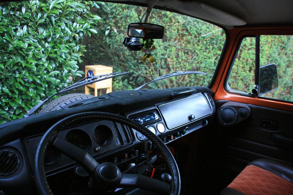

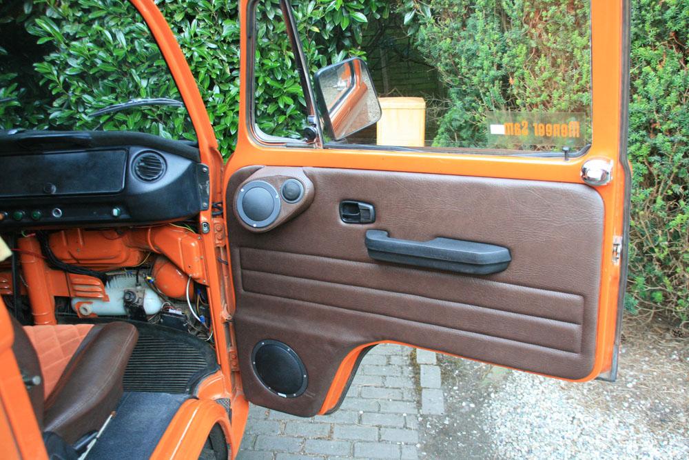

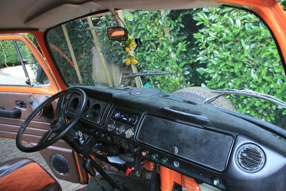

We finally got everything installed and upholstered. We still need to do some cleaning up in the interior and some bits of the wiring, but everything is up and running.
Dynaudio system 360 installed, tweeter and mid-range cross firing towards opposite passenger for best sound quality. Window winders had to be eliminated and are replaced by electric windows.
Modified dash with fiberglass to accommodate the Focal 130CVX center driver firing at the window for a wide sound stage.

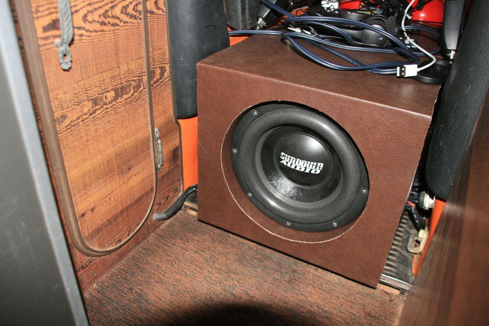

We built a new center console which now has a small housing for the 8 inch Sundown Audio driver. The enclosure for the woofer is only 6,5 liters. Leaves enough room in the console to store documents and two fire extinguishers. We still need to finish this with a nice black mesh to conceal the woofer.
When we had everything installed we had some trouble with the JBL MS-8. However, after a call with JBL they shipped me a new unit which arrived to my doorstep the next day. Probably best service experience ever.
We still have some deadening to do on the left door, but the system sounds awesome. It has cost us a whole lot of time and money to get it done, but it was well worth the effort. It plays extremely loud without distorting with intense base.

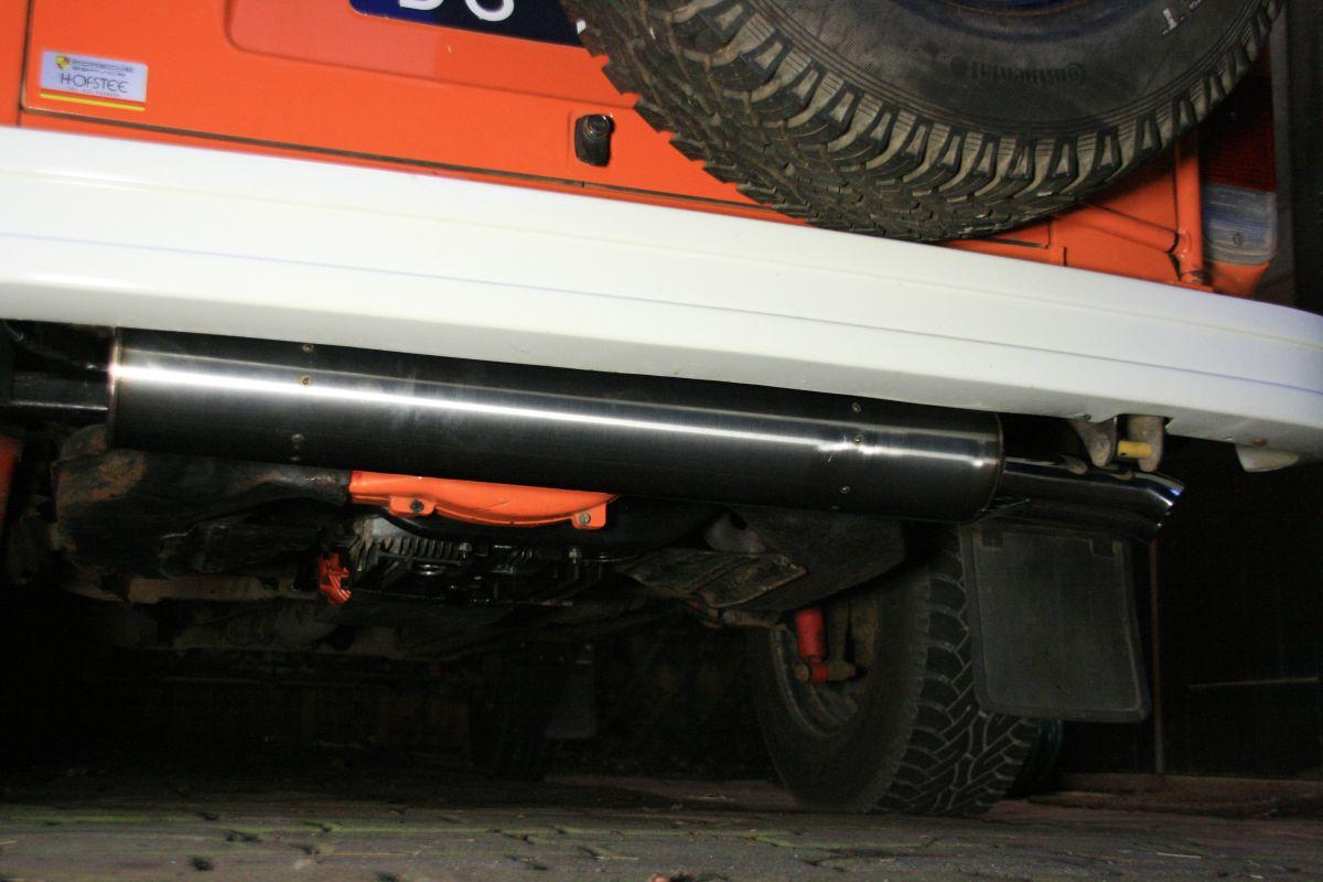

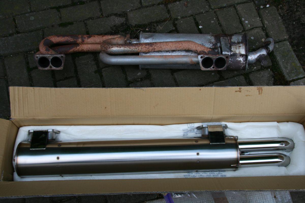

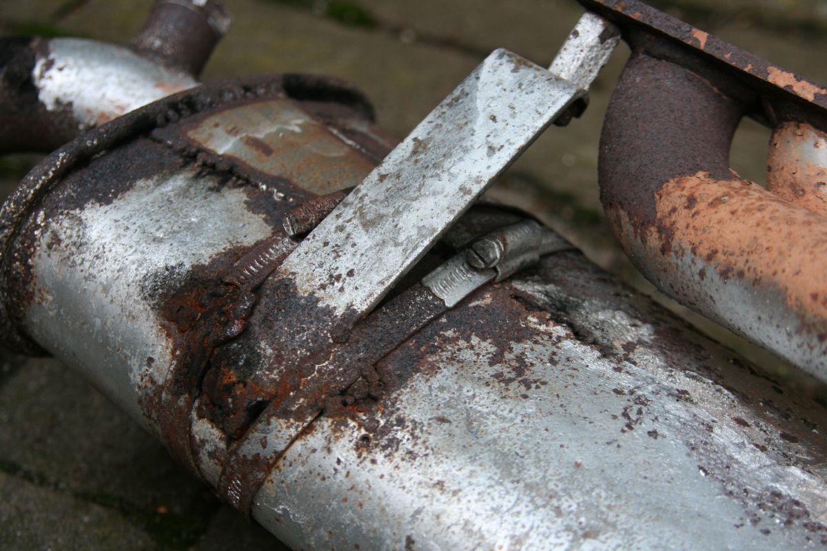

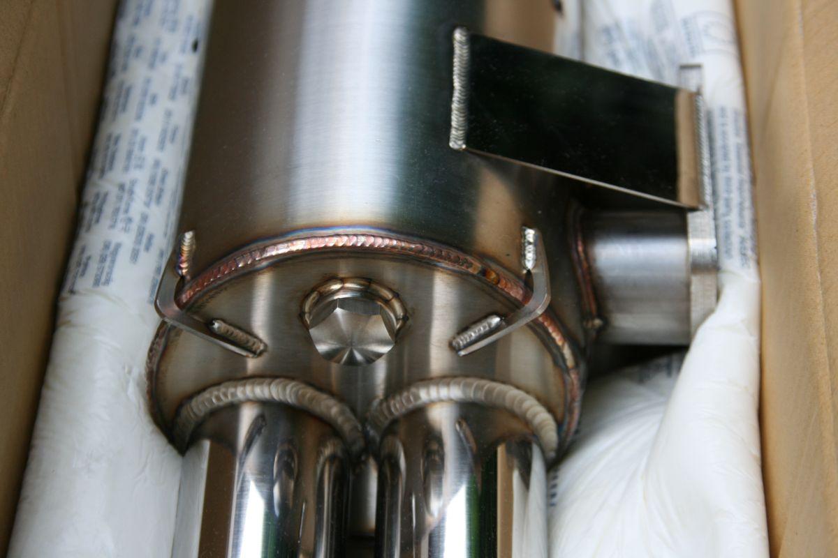

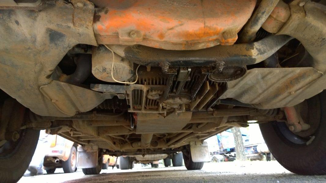

In the meantime, we swapped the Thunderbird exhaust for a Vintage Speed one. After 5 years, 30k miles and some patchwork the TB was f****ed up beyond recognition.
Vintage Speed was shipped in a matter of days and the packaging, as with everything else on this product is ace. Comes with studs and 12mm nuts for easy mounting.
Getting dark here, pic of the end result doesn't do it justice.
Sound is a bit heavier compared to the TB, and a bit louder as well.

We have always planned on doing a write-up on the MS install, but we had some problems during our trip through Africa.
The problems were most likely caused by a configuration problem. We have since upgraded to MS3 and we are going to re-tune it from scratch.
We also had some problems with failing O2 senders. We hope this was related to the way it was mounted, so hopefully it will work better with the new exhaust.
Also we're going to move the MS ecu out of the engine bay, to eliminate possible heat induced problems.
Once we got everything wired up and the O2 sensor replaced we'll start re-tuning with a set of new injectors. Once everything is dialed in and the system is running reliably we'll do a write-up. Don't expect anything soon though, still a lot of work to be done and nowadays we don't have that much spare time to put in the bus.

One thought no many people know about O2 sensors is how sensitive they are to silicone spray. If you are "water proofing" anything that way- it might have an effect on your o-2 sensor.
Love the exhaust. Might get one for mine when the time comes.
Never put anything on the sensor. Let's just hope it was due to it's mounting position. Maybe the airflow was messed up where it was mounted, allowing it to build up soot on the sensor.
I think VW originally mounted theirs pointing straight down going into the top of the exhaust pipe. Is this angle what your referring to, or more related to the distance you place it from the point of exit?

The sensor should always be mounted between a 3 and 9 o'clock, this is too prevent moisture collecting around the sensor. Probably also the reason why they are mounted in the 12 o'clock position on the VW's and pretty much every other car.
We had the first one fail after about 7000 miles, at the time I thought it was due to leaded fuel we may have used in Africa. The replacement sensor we carried failed within a couple of days.
Once we got back to Europe we installed another new sensor and it failed within a couple hundred miles. These were all brand new Bosch units, so no crap quality.
The sensor was mounted in a weld on bung right between the collector and muffler on our Thunderbird exhaust. Maybe the bung caused some sort of weird turbulence causing soot to build up on the sensor tip. It could also be a temperature problem, if the exhaust flow is not hot enough it won't burn the soot of the sensor.
The guys at Vintage Speed said the ports on our new exhaust are suitable for continuous O2 sensor operation, so we'll see how it holds up.

I think a heat sink bung extender from Innovate might do the trick or you may fabricate a copper butterfly and use it inbetween the exhaust and the sensor as long as there is an airflow.
http://www.innovatemotorsports.com/xcart/product.php?productid=16148

Too bad you can't dip a little bit south and let the engine return to Aircooled Heaven where it was conceived Smile
Awesome trip!
We'll figure something out, don't wanna miss the opportunity!
We'll see how the unit holds up internally, my experiences with it were less than positive.

Jake Raby wrote:
We'll see what happens indeed. The TB was beyond repair, tried to fix'r up a couple of times but the material was just too far gone
