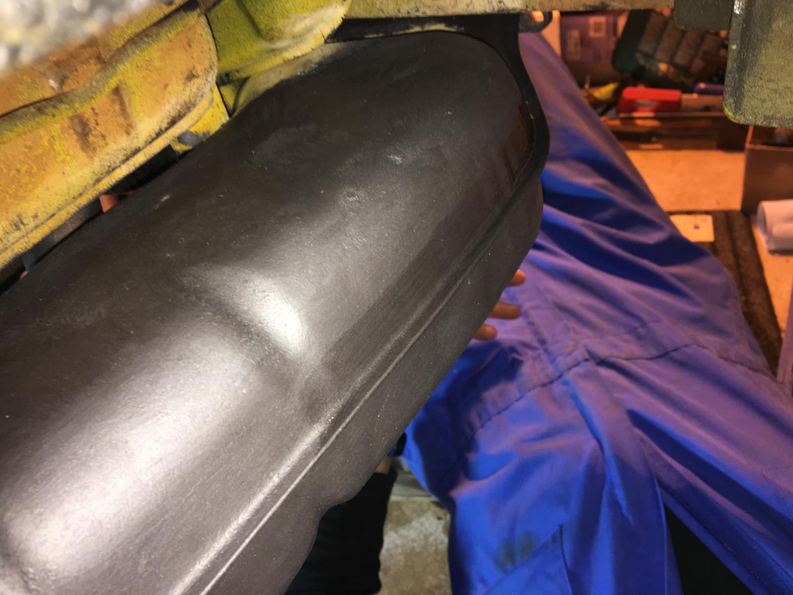

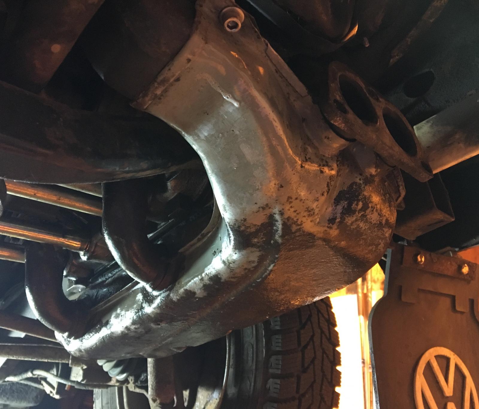

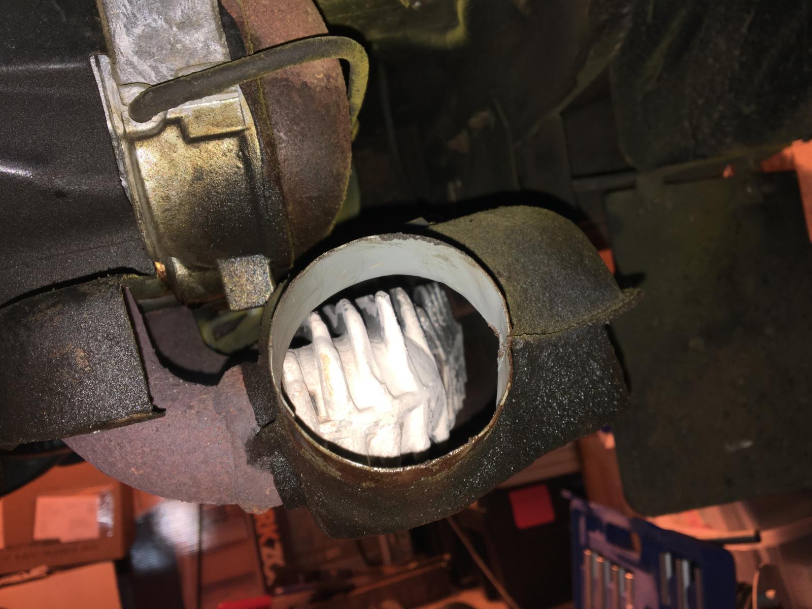

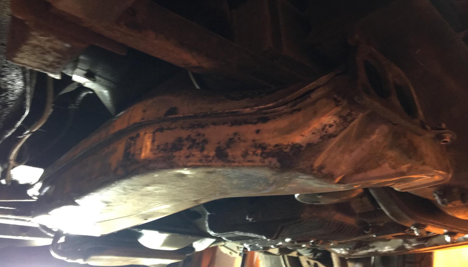

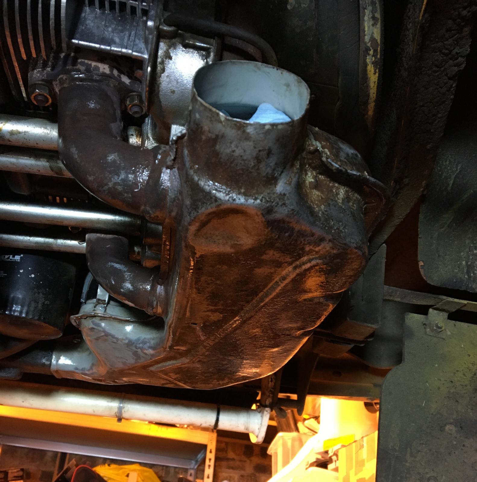

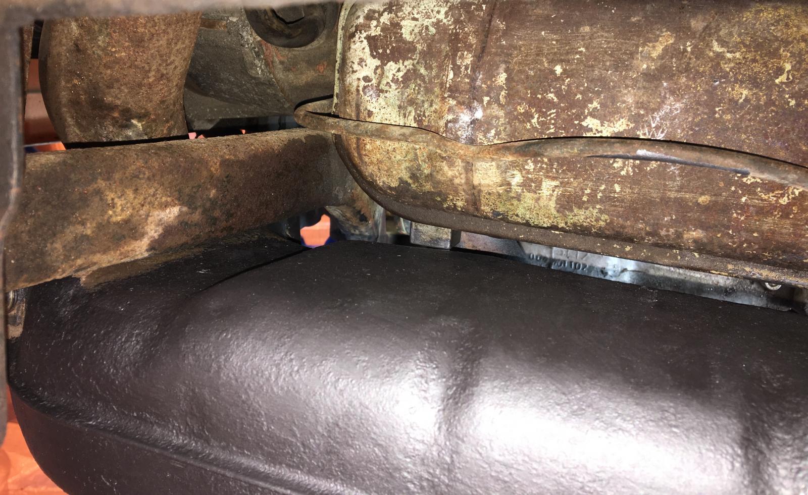

Ok, I have a little experience here.
Five years ago (before I discovered TheSamba!) I was having problems with the heating in our bus (you will all sympathise!)
The garage I used to go to persuaded me to get 'new' heat exchangers, which they fitted (and then zip-tied the controls to 'hot') This didn't actually fix the problem, which turned out to be frozen control cables and, maddeningly, there was probably nothing wrong with my OG units that had lived in the dry of Australia 'till then. Embarassed
Anyway, the reproduction units they fitted cost £180-£200 each (about $300 each then). I don't know if they are Dansk but they have been on for five years of moderate use, plenty of long trips, rain aplenty and garage parking when not in use.
I've been refurbishing them in situ for the last couple of weeks, and the photos I have are below (mostly after wire brushing). They were very rusty on the undersurface, which I attacked with a wire brush on a power drill, but the topside still had a bit of paint on. I have painted them with POR15 manifold Gray high temp exhaust paint.
There were no holes, and now that my heating system works, they put out a moderate amount of heat. My cabin temp was 19degC (66F) on an 8degC (46F) day recently after a short run.
Damn, I wish I still had the original ones so much it hurts! There is a NOS pair in the classifieds from Holland for 1000 euros, not including postage! (no chance!) Rolling Eyes
Hope this helps the discussion.
