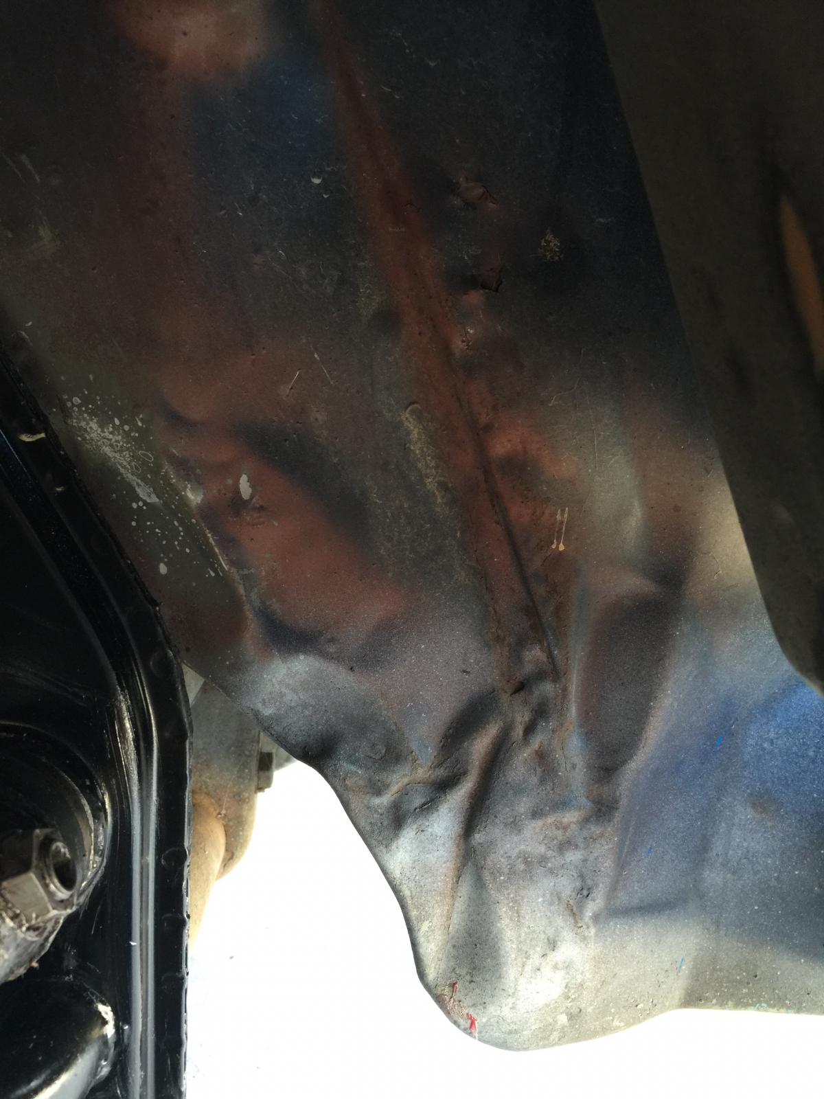

a pic of some of the damage:
I am sure that this damage means that the smooth fenders on the vehicle are not original, unless the damage happened while driving with the fenders off... there are a couple layers of paint on the car the they seem to match...
Any way what do you think about the spacing on the beam?

You clearly have body damage so that is most likely the cause. Three options, live with it as is, bang it in with a mallet to clearance it or cut & replace.
Maybe just the angle of the pic but the shock tower may be tweaked also on the damaged side.

Yea, This got hit in the past in the front right. looks like a flat hit to the right coner. The finder(s) have been replaced and this was repaired with a hammer...sort of.
