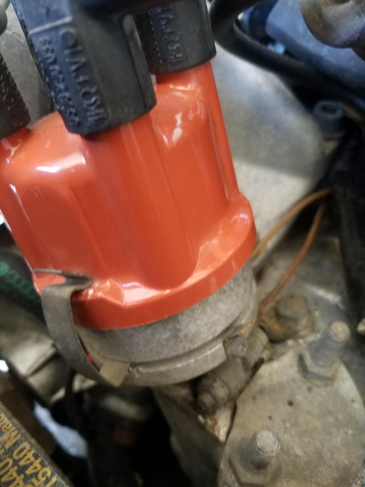

PostPosted: Sun Jun 02, 2019 11:23 am    Post subject: Re: Problems after changing fuel lines Reply with quote
Is this what is being referred as the AFM sensor?
I do not see a vacuum line coming from the distrubutor. I do see an unused spade connector. Is this supposed to be connected to something?

PostPosted: Sun Jun 02, 2019 11:57 am    Post subject: Re: Problems after changing fuel lines Reply with quote
Have you tested your fuel flow and pressure at the left injector rail? Take a run of 5/16" hose attach at the test port and check for fuel flow with the key in the on position and the AFM flap held open. Make sure flow looks good. I'd also check for good pressure while you're in there. You want around 30-40psi. Did you plug the injectors back in appropriately? Did you accidentally pinch an o-ring so that there's a small vac leak at one of the injector tips? Did one of the rubber stops on the injector body slip down or up, causing the injector to not seat flush in the intake?
Sounds to me like you have a fuel supply issue. If it starts and idles strong, and revs good under no load, it's not likely a spark issue. Unless you effed up your timing when putting the dizzy back in. Did you put the dizzy in backwards? Did you check your timing after reinstalling?
That spade on the dizzy is superfluous. A spare ground.

PostPosted: Sun Jun 02, 2019 12:02 pm    Post subject: Re: Problems after changing fuel lines Reply with quote
DS1980 wrote:
I do not see a vacuum line coming from the distributor. I do see an unused spade connector. Is this supposed to be connected to something?
Late-model vans don't use a vac advance, ergo no vacuum line. The spade connector is for metal suppression/ground rings, which late-model (89-91) vans also do not use. What they do use is a suppression/ground cap, which yours does not have. Just went through this a month ago with my '90: Ordered a cap at NAPA without having a part number with me (rare occasion), didn't open the box in the store, got it home, and... not the same; didn't even bother installing it after comparing it to the old one with the ground cap removed. They ordered based on their erroneous database. Ran down to Advance Auto, which had the proper cap in their store.
Not that that's what's wrong with your van, just an FYI.
