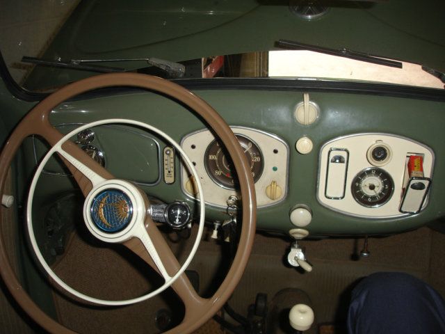

Who has a picture of a Dehne gas gauge in a split?
Splitdog
Samba Split Personality
Joined: February 16, 2004
Posts: 4135
Location: Planet VW
Splitdog is offline
PostPosted: Sat Dec 22, 2012 11:19 pm    Post subject: Who has a picture of a Dehne gas gauge in a split? Reply with quote
I want to see what the different mounting possibilities look like. Thanx...

PostPosted: Sun Dec 23, 2012 9:17 am    Post subject: Reply with quote
From a search of the "Gallery" for "Dehne":
In Stereo, Where Available!
qwerty
Joined: March 18, 2004
Posts: 345
qwerty is offline
PostPosted: Sun Dec 23, 2012 10:17 am    Post subject: Reply with quote
Looks like an oval or zwitter, not split window dash...
Eric&Barb
Joined: September 19, 2004
Posts: 25860
Eric&Barb is offline
PostPosted: Sun Dec 23, 2012 10:23 am    Post subject: Reply with quote
Even if it was an early KG dash the mount is the same. Image is listed as "Dehne 1951/52".

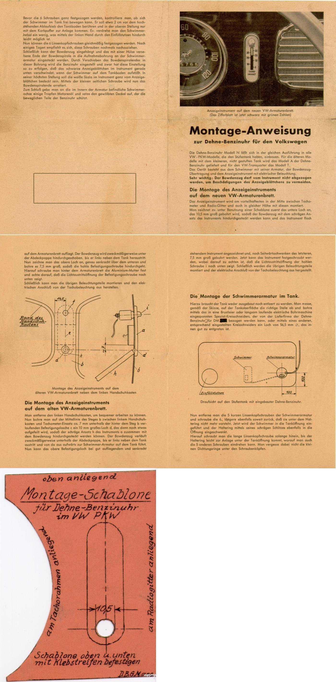

PostPosted: Sun Dec 23, 2012 11:12 am    Post subject: Reply with quote
Middle part of the paperwork? Looks like a split dash pod next to the glovebox. (thanks for the original post to Eurodub and Andi )

PostPosted: Tue Apr 08, 2025 9:53 am    Post subject: Re: Who has a picture of a Dehne gas gauge in a split? Reply with quote
Within the wonderful installation instruction provided in this forum, I see a location for the sender hole in the top right side of the early style gas tank. My June 1952 Beetle came with the Dehne gauge but its original gas tank is long gone. The written instructions indicate that the hole should be 56.5mm in diameter. Before I cut my hole, I’d appreciate confirmation that this location and hole size are accurate.
In addition, I’d appreciate anyone that has a correct early white face for the viewable gauge take detailed pictures and, if possible, include measurements so I can recreate one for my car.
