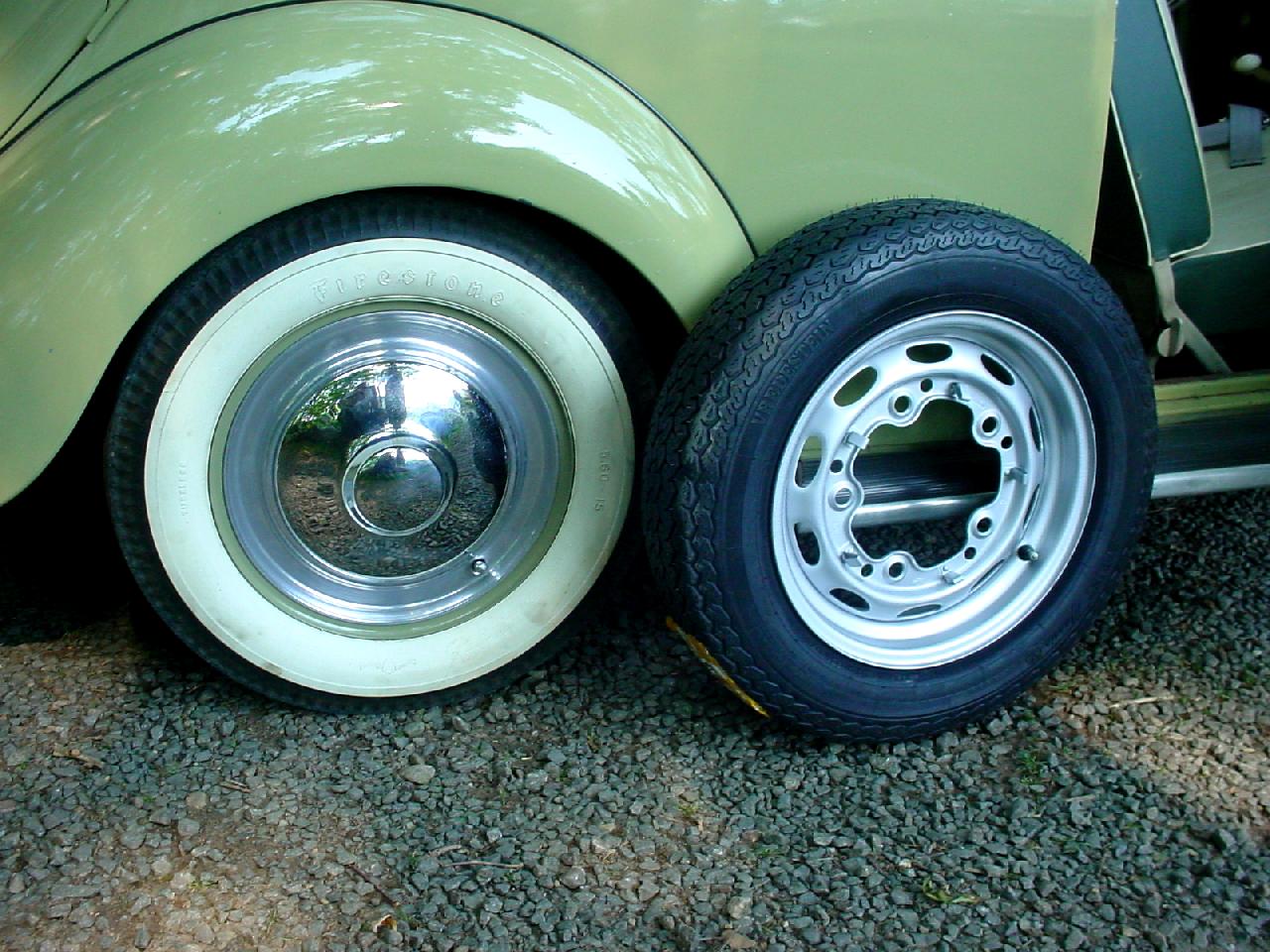

Stock Steve
Joined: April 10, 2005
Posts: 1964
Location: My Left Nutmeg State
Stock Steve is offline
PostPosted: Sun Jan 27, 2013 6:20 am    Post subject: Reply with quote
Jeff,
We had to go with a 155R15 Vredestein (Sprint Classic) to fit in the spare tire well of Moogie32's '63 Ghia.
Nice looking, "older style" sports radial, plus it's a fresh tire, which is reassuring from a safety standpoint.
I also have a couple of sets of them that I use on my '60 Bug. Here's a shot of one sitting next to a 5.60x15 Firestone for comparison:
Here's another of the same tire, but on black-painted wheels (both are 4.5" width):
Keep up the great work on the Alken--very exciting to watch your progress!
