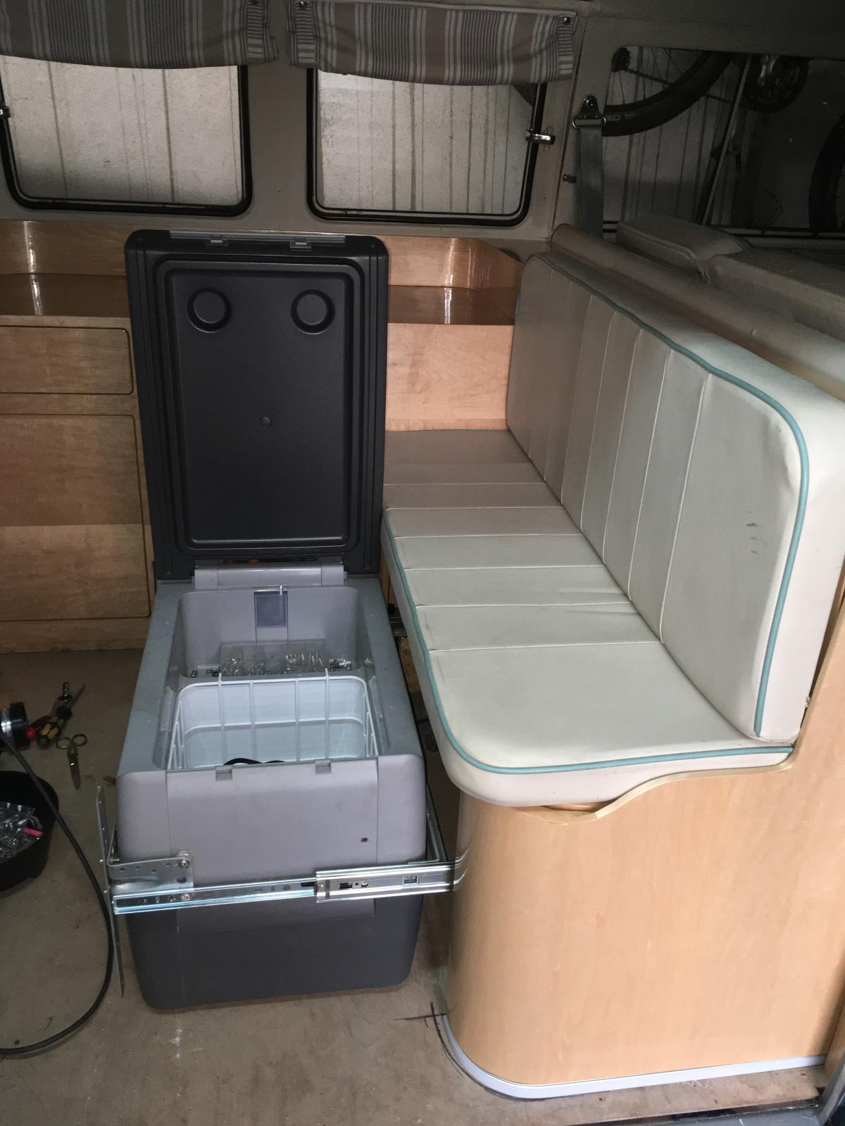

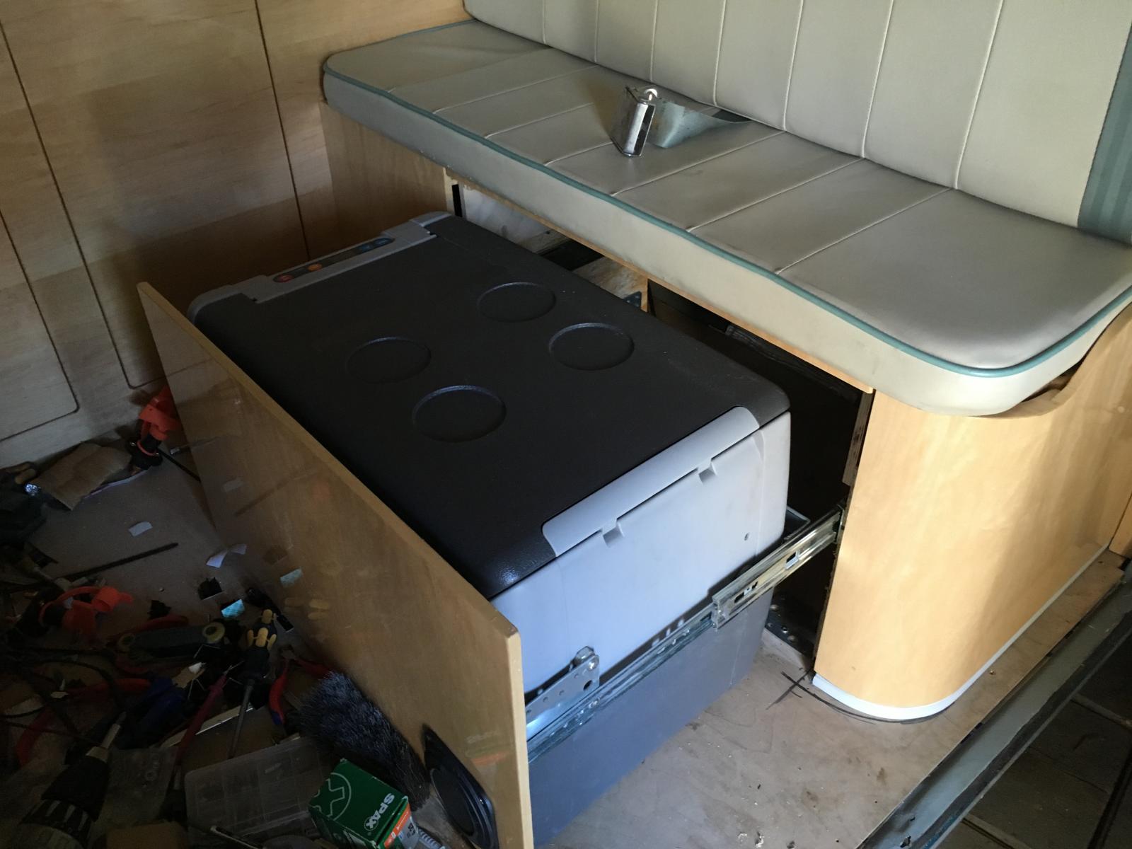

3. The cooler / Freezer unit will be integrated under the forward seatbench on sliding rails. The 'push to open' mechanism is a nice thing, just that with heavy breaking, the unit would unlock by its own weight. I have integrated a lever mechanism which arrests the cooler when locked into place. This lever sits behind the driver seat and needs to be pushed down before the cooler can slide out.
Closed
Open:
Here you can see the seat bench front side cut in half, and the cooler cover already with new Marple veneer.

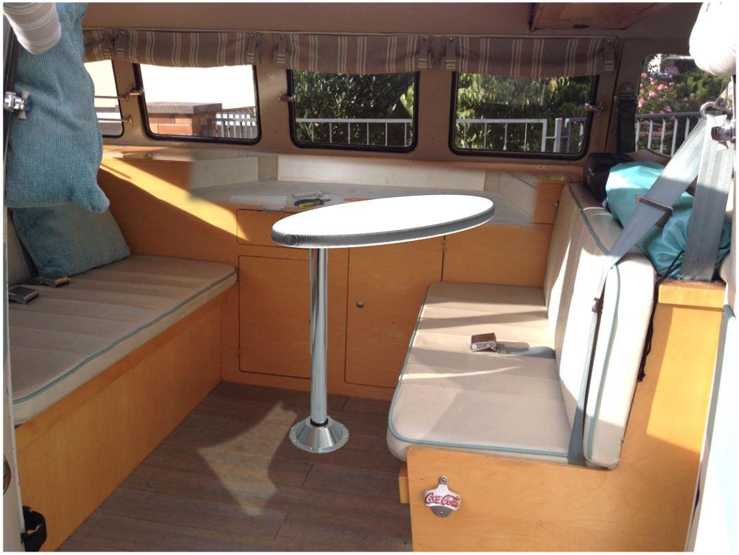

Yes, table there will be - was thinking along those lines:
- Surfboard-shaped table
- Dimensions and position of the out of center leg will allow free rotation of the table to be moved 'over' the sideboard for easy access of storage areas when table is not needed.
- Table supports in two heights:
1. a long leg when you sit at the table
2. a short leg so the table is level with the benches. It has to support of the upholstery elements, which will be used to make up a large bed all along to the rear door (together with the rear trunk area this makes a large bed)
Something like this:
And here rotated in parking position (over the lower middle section of the sideboard):

I like the oval table. Don't think I have ever seen one like it. Looks very useful. Could fatten it up to almost round and still be workable.
Have you considered making a bracket off the cabinet instead of the floor post? I hate floor posts. Smile

Thank you this gibes me an idea. I think i could integrate a pull out support so i can spare the table leg and the floor munt. Time for welding....

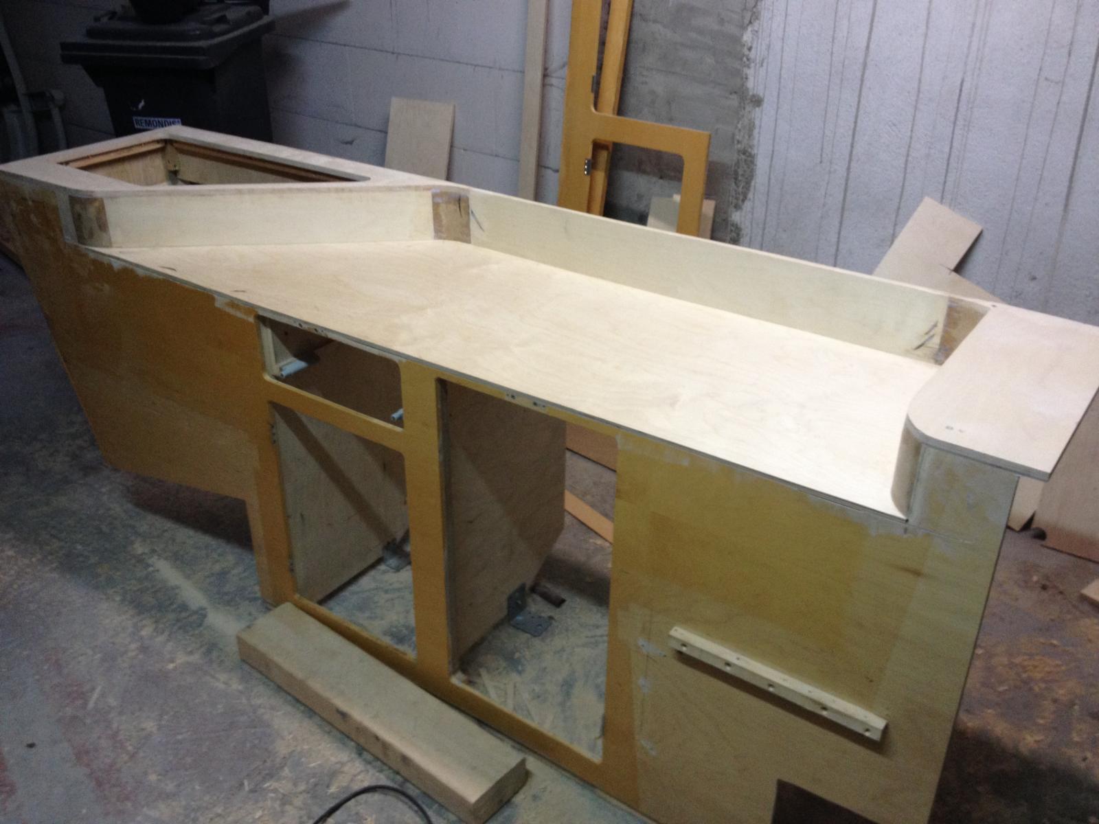

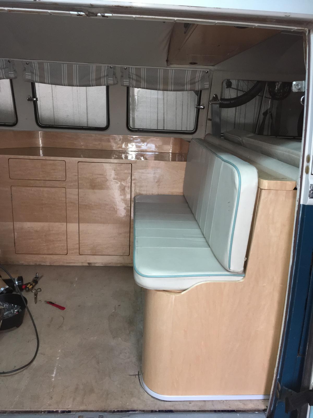

Some work done on the sideboard.... getting close to apply new veneer:
Good exercise to get the 6 feet long unit in and out the bus several times until I was sure about horizontal and vertical alignment and a snug fit between fire wall and front seat wall...
Had to shape a new door for the rear section. This is needed to access the engine fire extinguisher mounted on the floor - in front of the inner rear fender. As far as you can look into the compartment (in the picture below), this area will be used as storage room, separated from the fire extinguisher by a wooden board. The door will be mounted with the previous hinges and be held by magnetic push-locks. So no need for a handle or catch-whole...
Rear seat bench already veneered. Got alittle lazy to make some templates and just roughly cut out the 6 hinges from the sheet of veneer, which than was glued in one go to frame and doors. (I wanted to ensure alignment if wood structures).
After application, I had to cut out the doors. This was not possible from the back and I damaged the veneer in two areas where I replaced it with small sections. The whole area will be covered with the seat upholstery, so I will leave it like that. It will be ok after the application of the boat clear coat.

Have started to fit the modified interior into the bus. Some pics of the first test fitting. The interior was reshaped, veneered and painted with "International" boat paint.
I had to lift the units by about half an inch to create enough space for the cooler / freezer unit (the smallest size which can host champaign bottles in upright position).
LED lights will befitted all around the floor and are remotely controlled by an app.
Parts after reshaping, new veneer application and boat paint treatment:
First test fit:
The retractable cooler unit is locked in place with a hidden fixture to arrest the box during driving. The lever to unlock the hook is positioned between rears of driver seat and seat bench, and mounted flush along the upper edge of the panel behind the front seats. By pushing the lever down, it releases the 2 arrest hooks and the cooler unit can slide out.

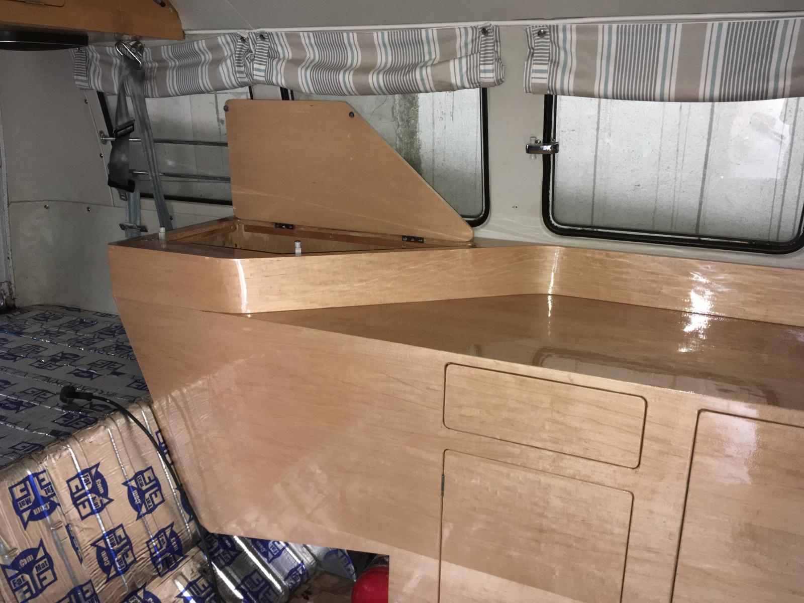

Rear section of sideboard:
Top flap to access another storage compartment on top of motor fire extinguisher. Drawer and doors with magnetic push-locks (time will tell if I have to add more to keep doors locked during rides)
And here a direct comparison. The reduction of height of the side board and the curved seat bench seem to do the trick: create the impression of more space...
The red propane Gas bottle (as in the last picture) will be tucked away under the sideboard behind the driver seat. Here the inboard gas heater is mounted to supply warm air to front and rear compartments.
The rear seat bench will be mounted soon...

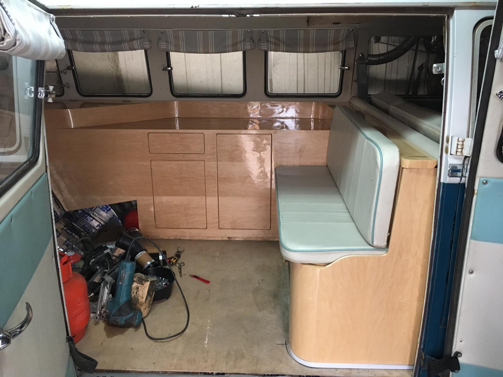

Seat benches mounted.

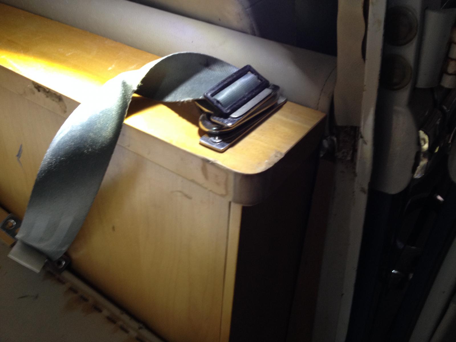

Finally, after heater, fire extinguisher, 4 seatbelts, Cooler/freezer unit had been mounted and connected, I have finally installed my seat benches...

The pictures show the interior with a vinyl floor just very slim so that the cooler can be pulled out and slides over it.
I am missing the metal profile at the edge of the floor.
