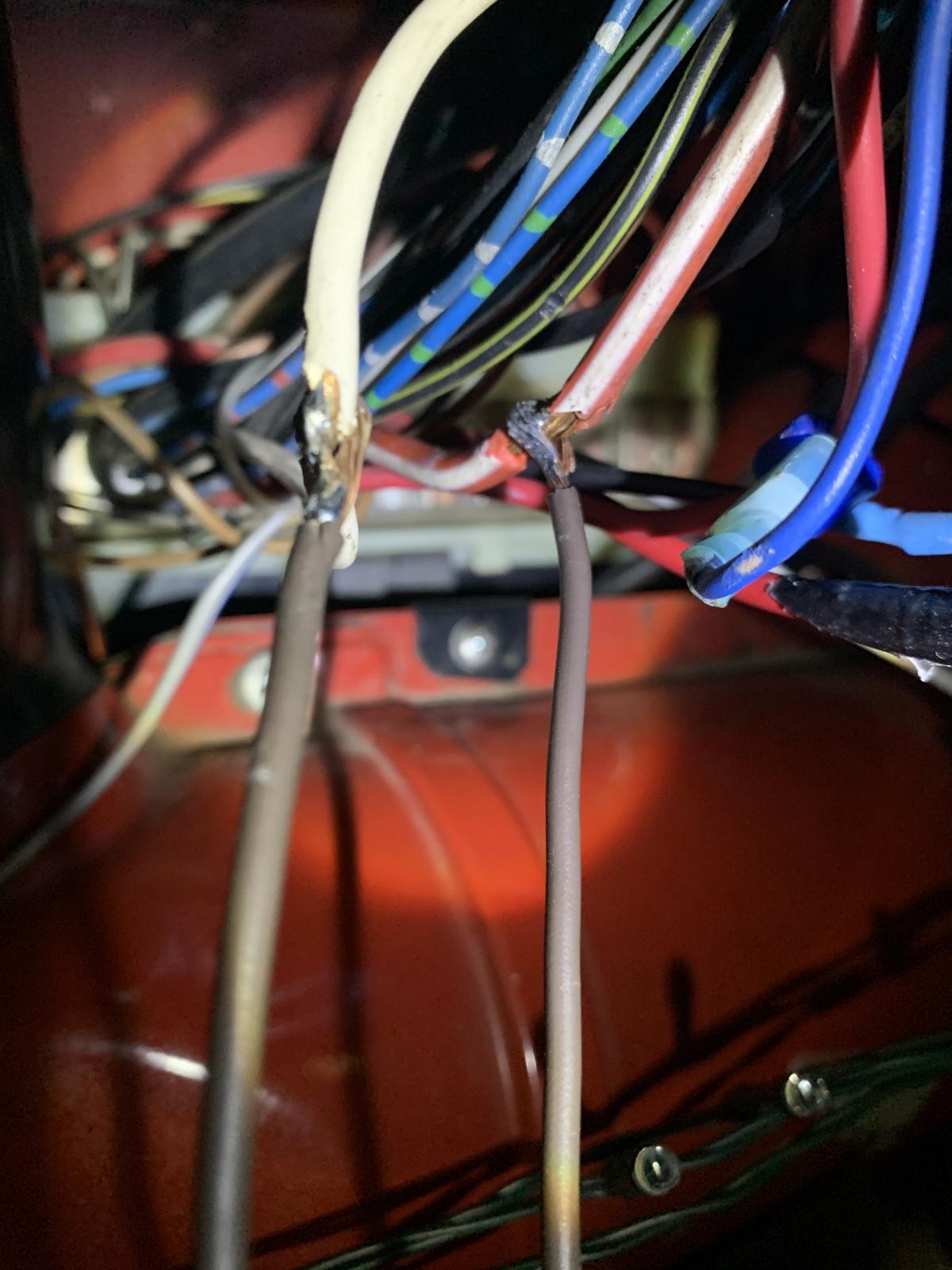

I am not sure how this plays into it or if it matters, but the previous owner added a toggle switch that must be switched on before I can start the vehicle.
If that toggle switch is not turned on, theres no power going to the ignition.
I dont know if he did that to bypass the ignition??? I really have no clue as to why it exists - could that switch be bad?
I plan to have it removed but i need someone who is good with the electrical on the bus to help me.
Here are some photos of the switch and which wires they are attached to. I removed all the electrical tape so you can see.

I’m no electrical engineer, but I always thought a switch is supposed to interrupt a circuit in the path of a conductor.
In your photo it appears the P.O. has put a switch across two different conductors. If you flip that switch you will effectively short circuit whatever those wires are connected to.
I could be wrong, I’m just going by what I see in the pictures.

It obviously runs and revs so it's not in coil or condenser.
Seeing your pics and reading your description, I would start with a ignition switch.
That looks like a bypass for a bad switch that's got worse.
First Remove that toggle switch.
Then Install new ignition switch.
Then proceed further if problem persists.

The white looking wire that the added switch is tied into, what color is this actually? What color tracer does it have?

PostPosted: Wed Nov 20, 2019 6:21 am    Post subject: Re: Bus won't run - seeking advice Reply with quote
That workmanship (used loosely) requires ripping that all out, getting the Bus wiring diagram, and restoring to stock.
That is below Failing grade - cold joints, no strain relief.

PostPosted: Wed Nov 20, 2019 7:06 am    Post subject: Re: Bus won't run - seeking advice Reply with quote
Not to mention no insulation.
That Scotch Lok terminal is so kowality too...
Buy a test light when you get the meter. You ae going to need it.
