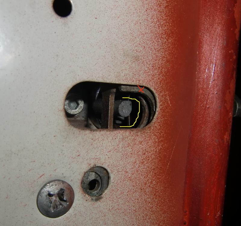

1st off THANKS for all the help and advise!
The hockey puck piece does not engage with the workings of the latch mechanism... it just floats.
Not the best camera, so I hope the photos are helpful...
I'm going to clean and oil the mechanisms today but again I can see that hockey puck does not engage.

Its pretty difficult to take a decent close up picture...
With the handle and locking mechanism removed and the pieces lined up by hand it becomes apparent that the hockey stick is not only too short to engage, it also lacks the length to engage the up/down backwards C shape that locks & unlocks the piece.
I'll try to get a better photo when I get a 2nd pair of hands...
It's definitely the wrong door handle because the locks work using the inside handles, the outsides don't engage the locks.

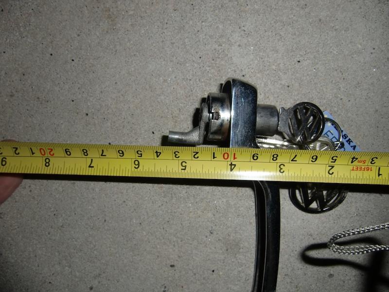

Alright, I got you a few pics as well.
First is my door handle with a tape measure so you can see if your hockey stick piece sticks out as far as it should. From the edge of my handle, the stick protrudes about 33mm.
Second and third pics are just for clarification. I know you said, the hockey stick was nowhere close to hitting the part that slides up and down, but just want to make sure you are looking for the right place where the hockey stick should be hitting.
When looking from the inside of the door, the part that slides up and down is the kinda half circle part I crappily drew the yellow line by. However, this is NOT what the hockey stick should be hitting, and as you can see in my pic, my hockey stick is not long enough to contact this part either.
The part the hockey stick actually hits can be seen better from the handle side. It hits these two fangs. My hockey stick hangs over these fangs by a good 5 or 6mm, so assuming you have these fangs, you would have to have an incredibly short hockey stick to miss them.

EXACTLY I have the fangs but the stick isn't long enough to engage them... If you look at the picture of my 'hockey stick' compared to yours, you'll note that yours is brass colored, longer, has a small right angle brace and the hockey stick extends pasted the housing...

handle part number
My L-shaped wing does not have a parts number stamp
lock mechanism and handle.
My part number reads:211837 205 J/M and right underneath that a K/L
Thanks again to everyone - if nothing else, I'm inspired to by a new camera...
