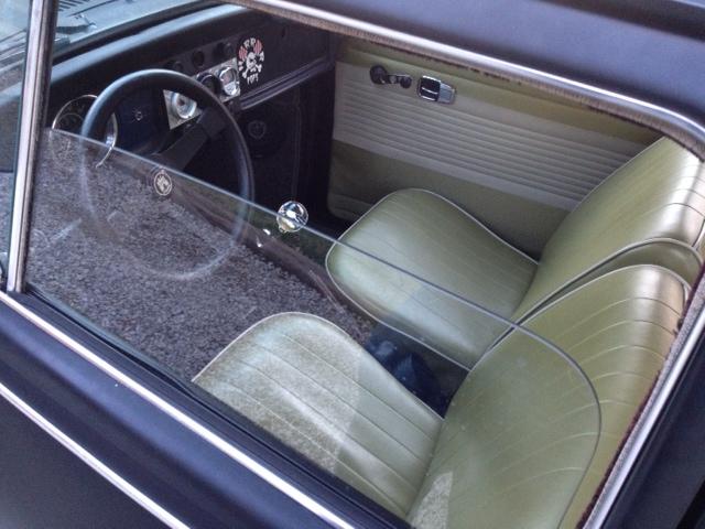

Interior: Lowback seats, green/offwhite vynil throughout, grey carpet in and rubber mats. Headliner is up there, but poorly installed and looks ugly. Clumsily small aftermarket steering wheel, padded dash and some mismatched gauges in a piece of stainless in the factory radio location complete the "look". Radio is in the glovebox and it has some fiberglass kick panelsWindows are hard to roll up and down, passenger side vent window doesn't open without falling out. The wires are a MESS. Lots of added on stuff, ad hoc switches and grounds in the wrong place....

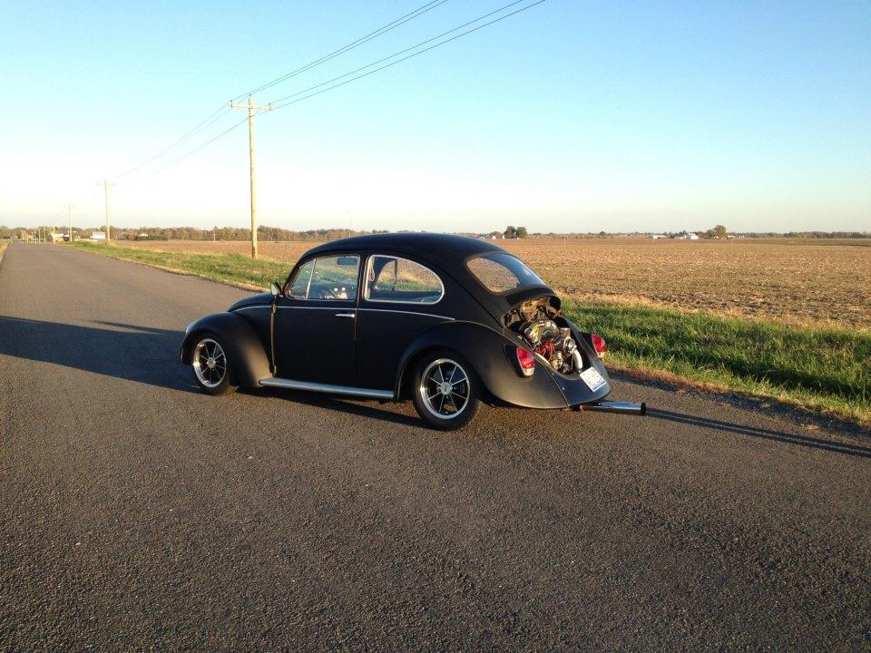

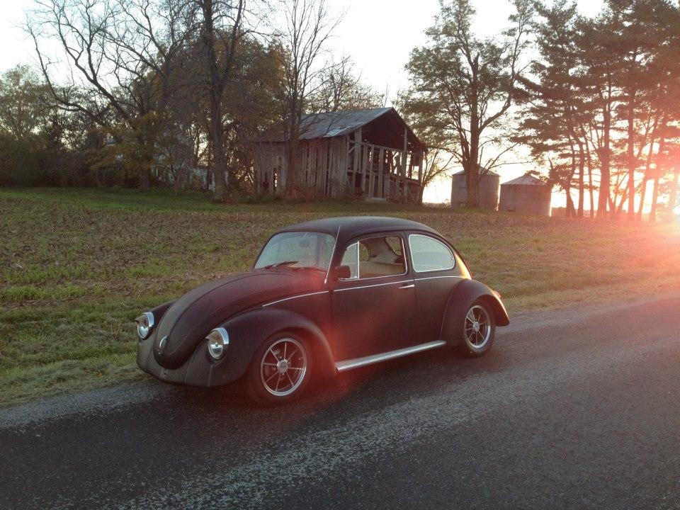

The day I brought it home in all it's cheesy glory with spikes and maltese crosses everywhere!

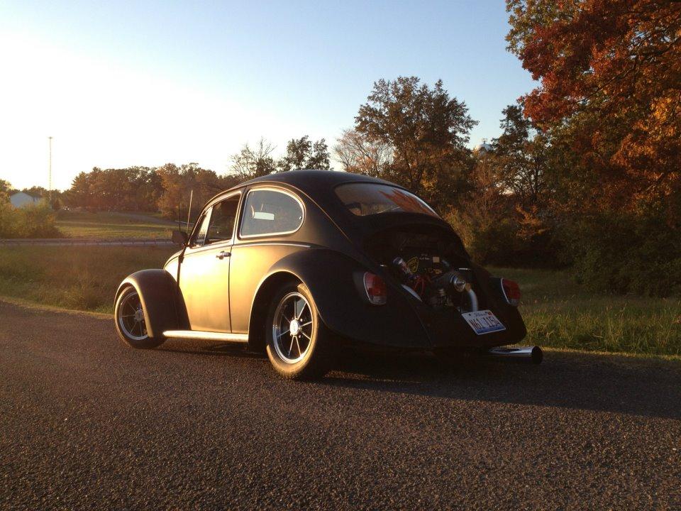

After about a year of driving it:

| Very nice bug, have fun with it. And are those early door cards? love the interior. 69's are nice |

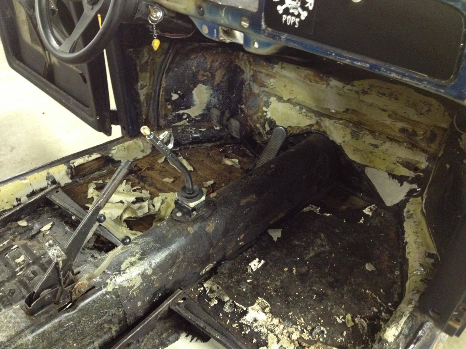

Previous to 2/5/13 work night I removed big interior bits: Seats, carpet, door panels, rear 1/4 interior panels and stored them away.

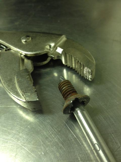

2/5/13 Removed Removed fenders, running boards, windshield, pass door, rear 1/4 windows, rear glass, PO addon gauge cluster and all wiring/oil pressure lines, antenna, washer squirter, headlights, wiper motor assembly and wires. Couldn't get the Drivers side door off because of this ugly problem! Badly stripped screw heads! What do I do? Tried to cut a groove to use a flathead screwdriver to no avail....
Other Pics:

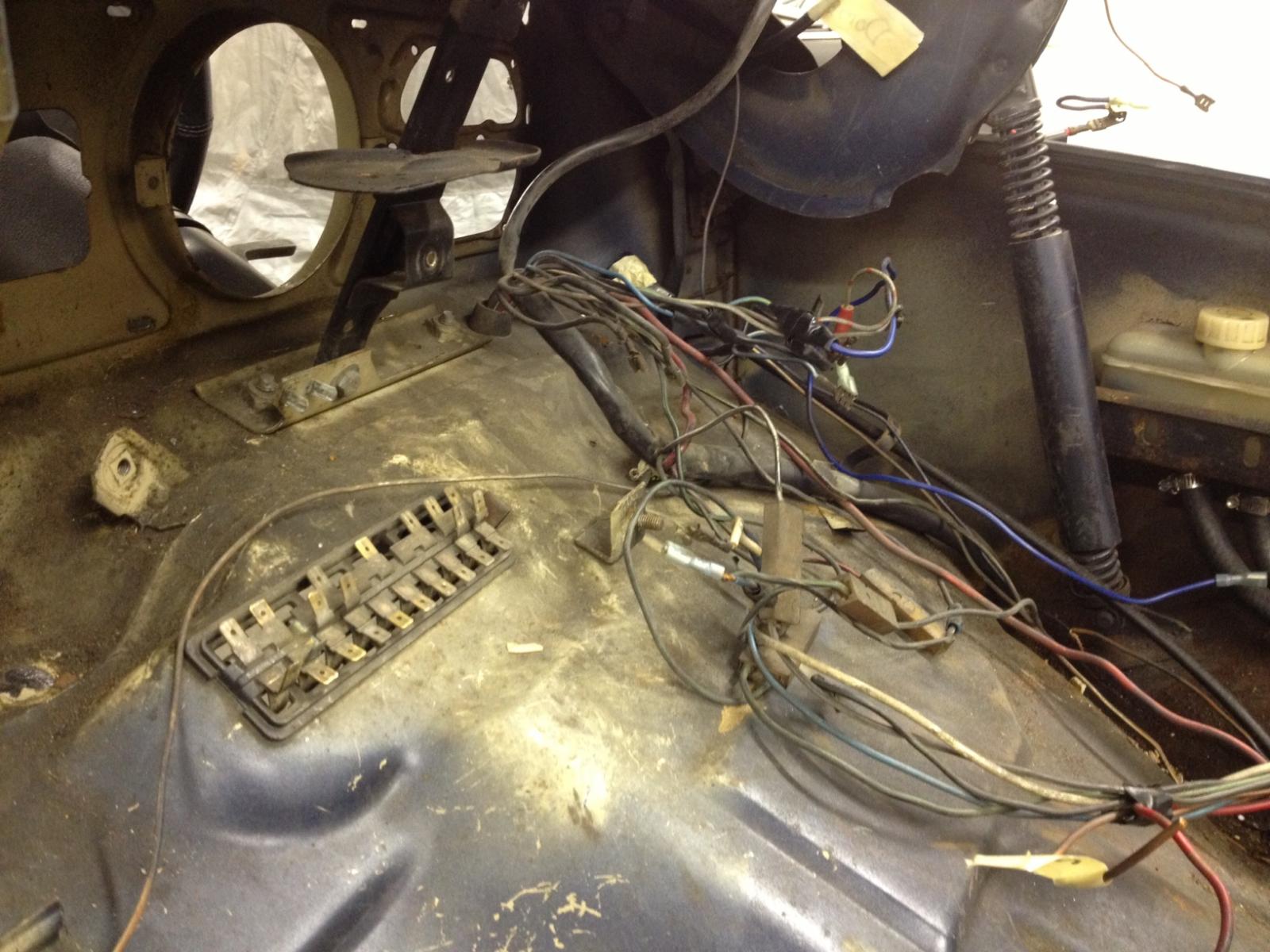

2/7/13: Removed almost all of the remaining factory wiring up front, removed visors, dome light and finally headliner. Pulled up as much of the carpet padding and sound deadener as possible.
Pics:

good work .Hope you took lots of pics of the wiring and switches. I did the same a couple of years ago ( see gallery) On the door you may need to just take the pin out. My body guy had to do that on pass side.

| For the door screws. Buy a left handed drill bit and run the drill motor in reverse. That way, if you get lucky, the screws may break free and run themselves out. If not, you still have a hole drilled to try an "easy out". Tip: run the drill slow, it will grab better increasing your chances of removal. |

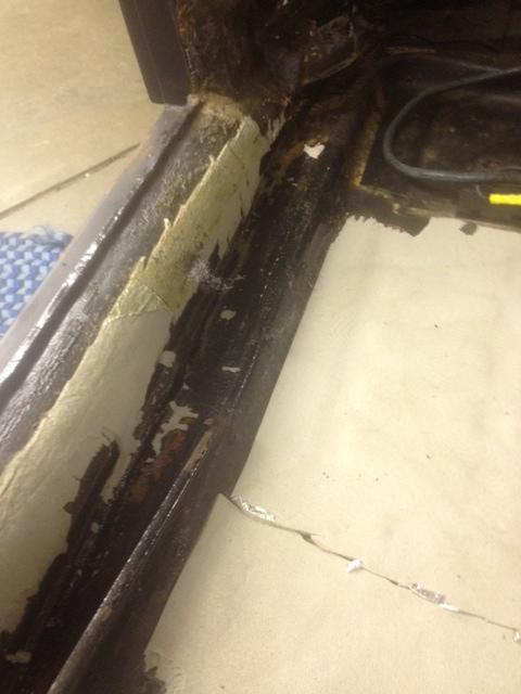

It's been awhile since I've spent time in the garage working on this project. Tonight I plan to attack the stripped door hinge screws and the floor pan "insulation".

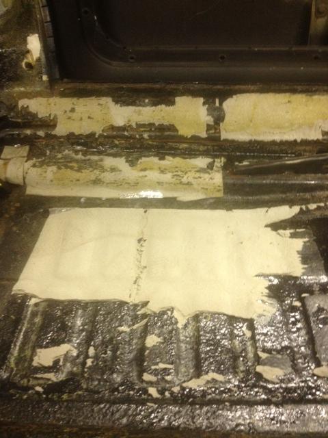

I have a bunch of this foam matting backed by double stick tape to deal with -- Adhesives and foam don't typically bode well with grinders and wire wheels in my experience....
Putty knives and screwdrivers are working, but just barely - Any suggestions to remove this junk easily?

Monday night's work: I stopped by the local Harbor Freight and grabbed an extra set of easy outs, like the ones that anima40000 suggested, and with a careful touch I managed to get both of the jacked up hinge screws out of the body while breaking only one cheap drill bit.
After that, I removed the remainder of the wiring harness from the front of the car. Only wires from the steering column remain, but have been pushed from through the body.
Scraped a few chunks of stuff off of the body and pans -- I think I will try some heat as most of this stuff is general adhesive.....
Some of the deadner is tar-backed - going to take a lot of heat to melt this stuff......
