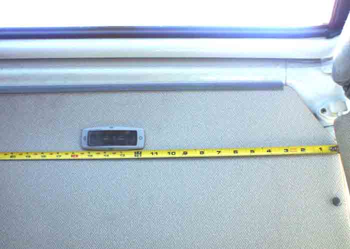

PostPosted: Fri Mar 15, 2013 2:01 pm    Post subject: Reply with quote
This will give you an idea where the hole for the passengers side dome lamp should be.
