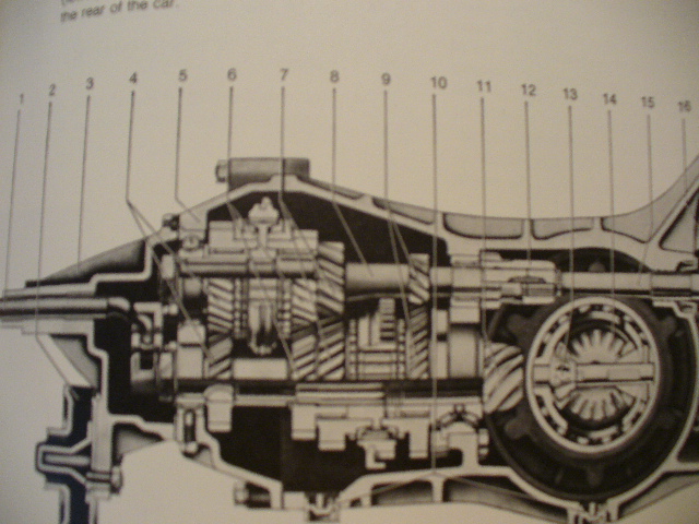

During assembly, they are screwed together loosely by a small locating stud in the end of each shaft, then a splined collar/sleeve is slid over the union locking them together as one shaft, and then a snap rings locks the collar from sliding back off. It is normal to be able to wiggle the shaft up and down, but not in and out. Collar is #12 here...
If you can "pull" it out by anymore than say 1mm, there is some sort of problem with that connection. Access to the shaft, stud, collar and snap ring are all inside the diff housing, so you don't need to disassemble the "trans" per say, but you would need to remove the right axle tube and side cover.
