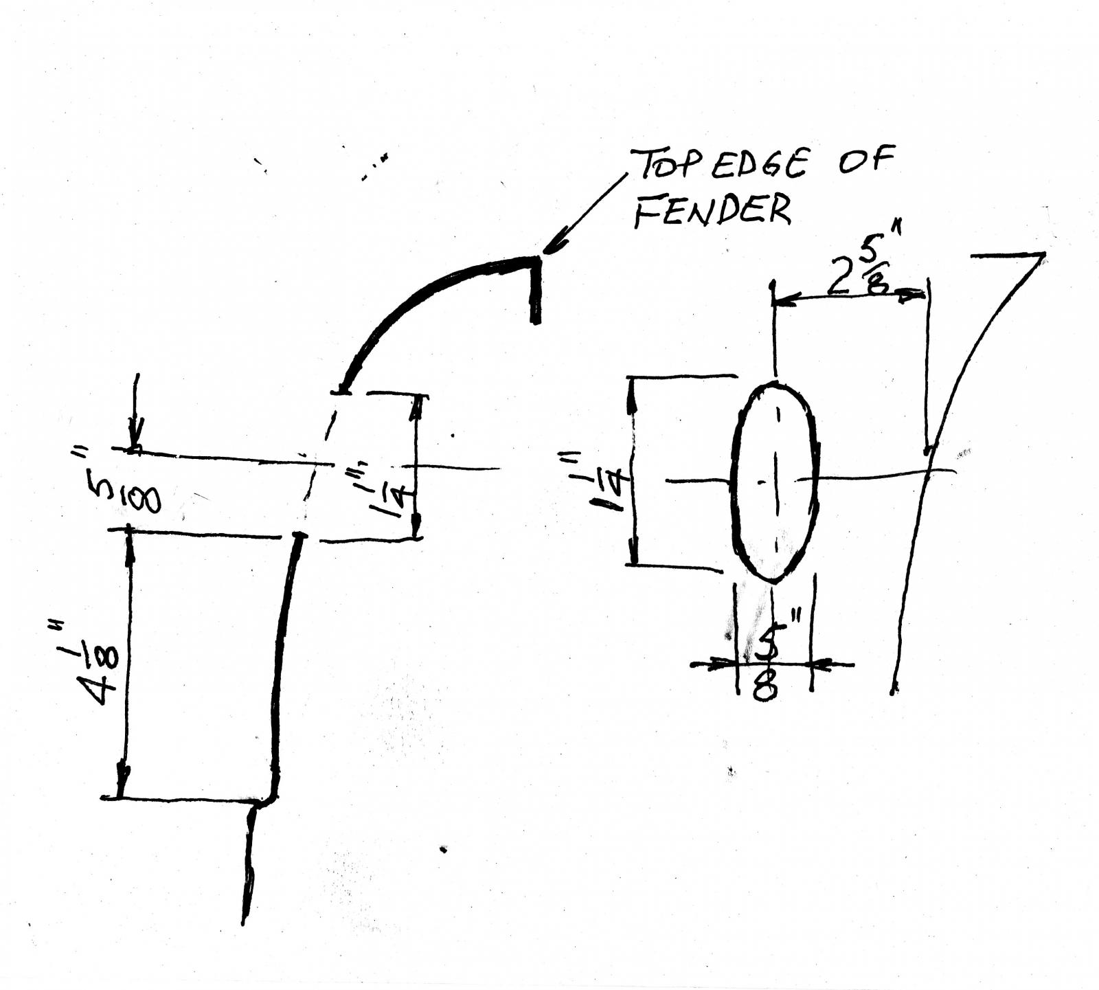

Anyone have measurements, or a template for the antenna hole location? Thanks
Hope this helps.

I can easily tell what the picture on the right is showing, but what about the pic on the left, where are those measurements from? Do you know the measurement from the body line up to the hole? Thanks
OK. Just measured and modified the drawing to a simpler measurement for you. Just measure up 4 3/4" from the mould line to give a centre line. Measure in 2 5/8" from the edge to give the centre of the elongated hole.

Perfect, thank you. Exactly what I needed
