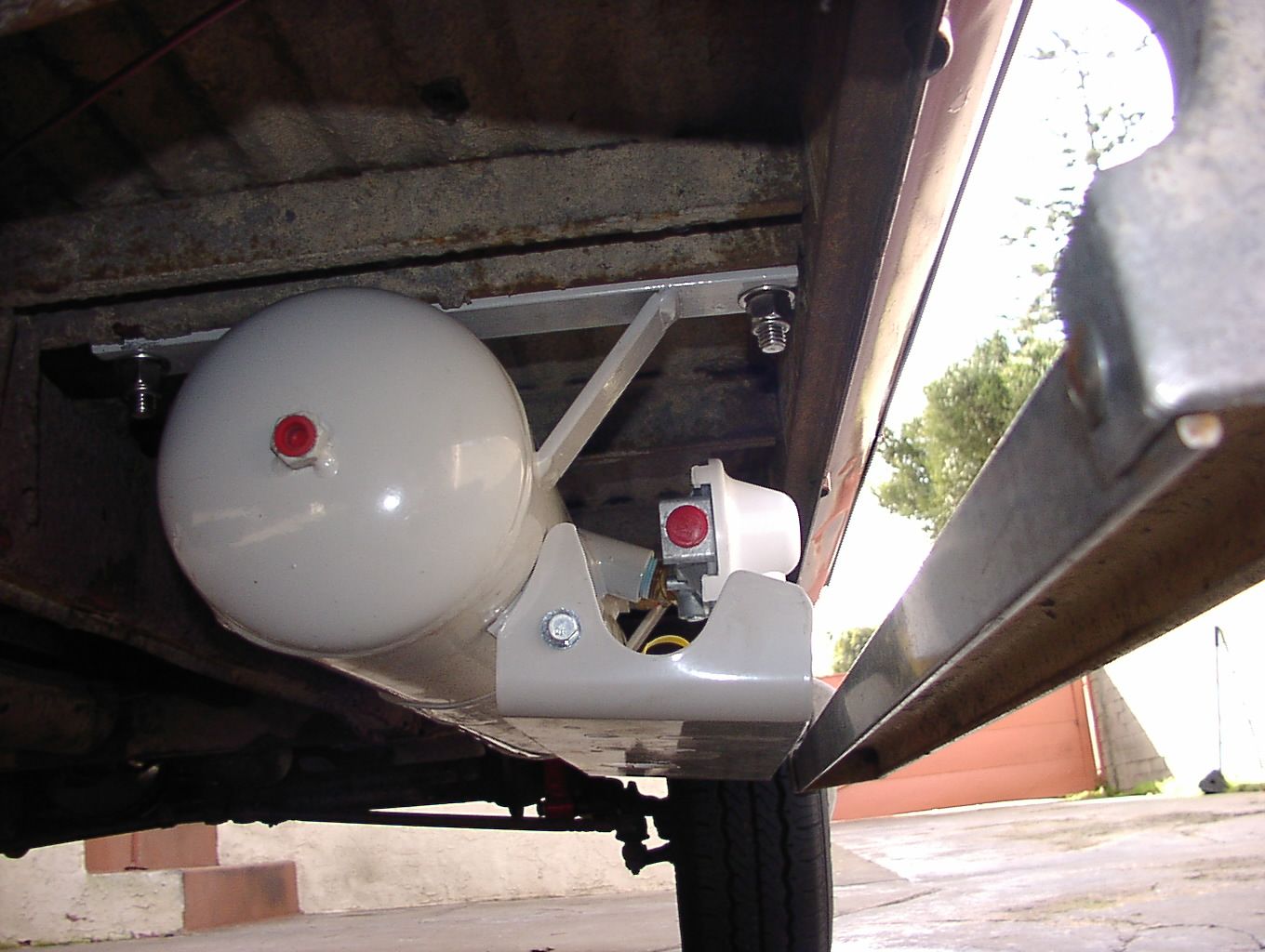

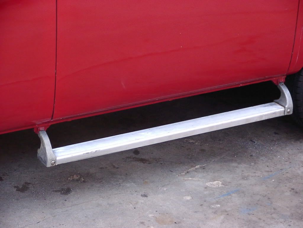

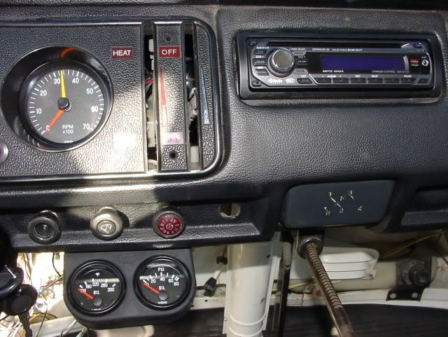

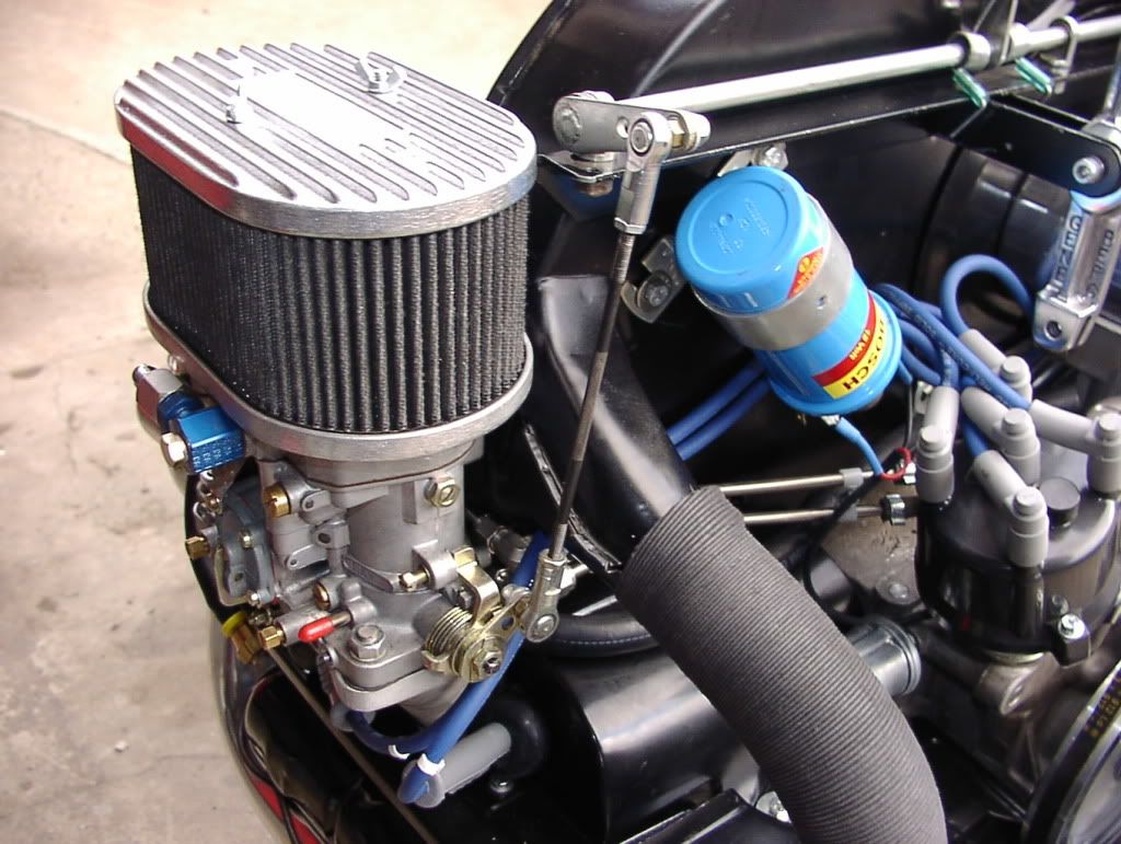

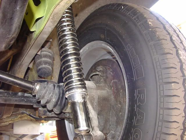

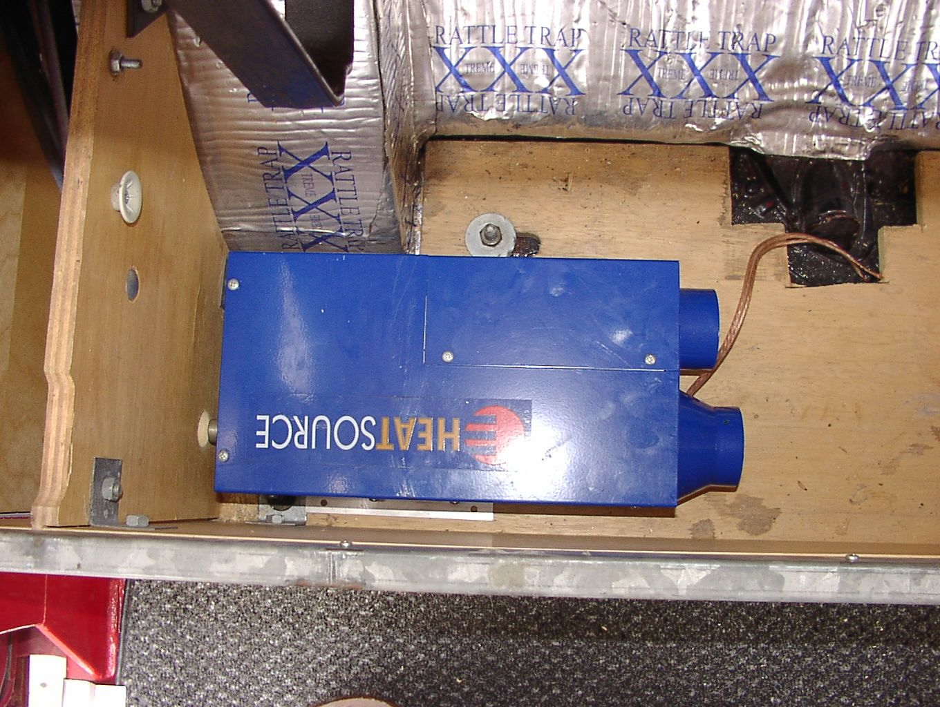

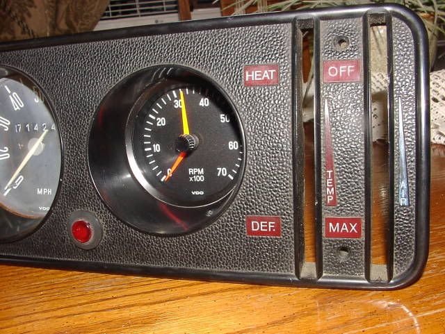

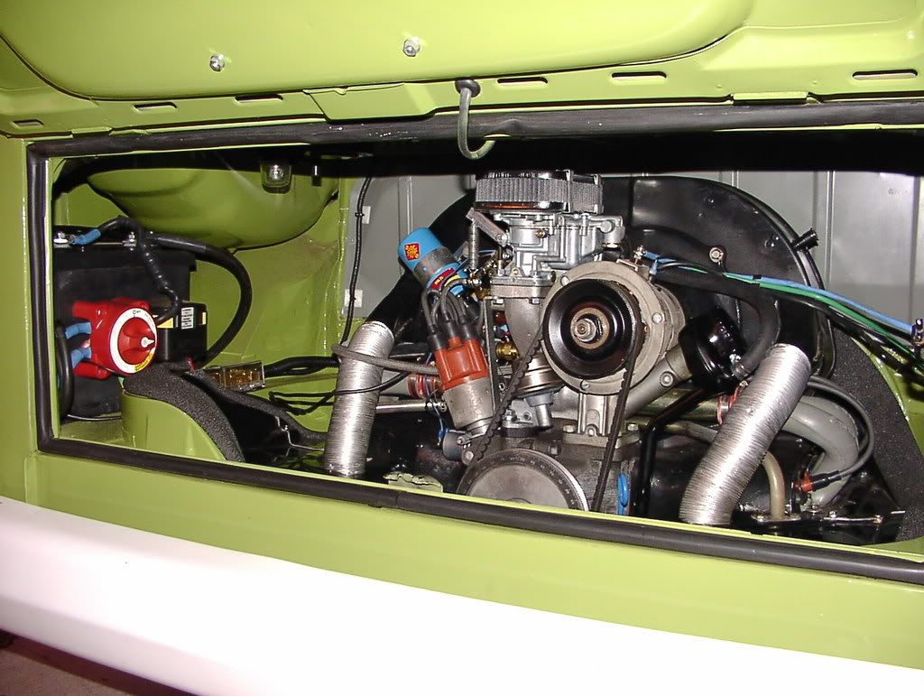

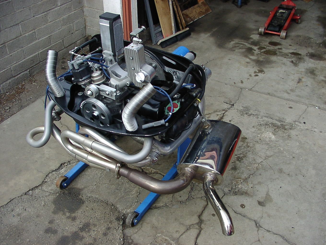

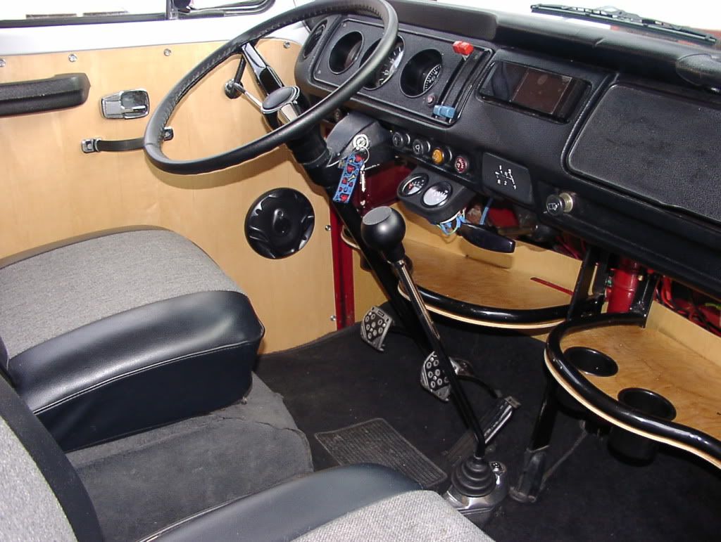

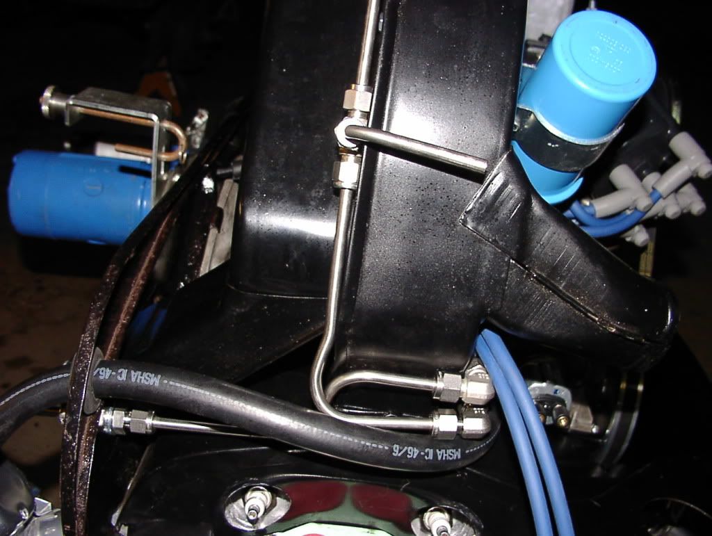

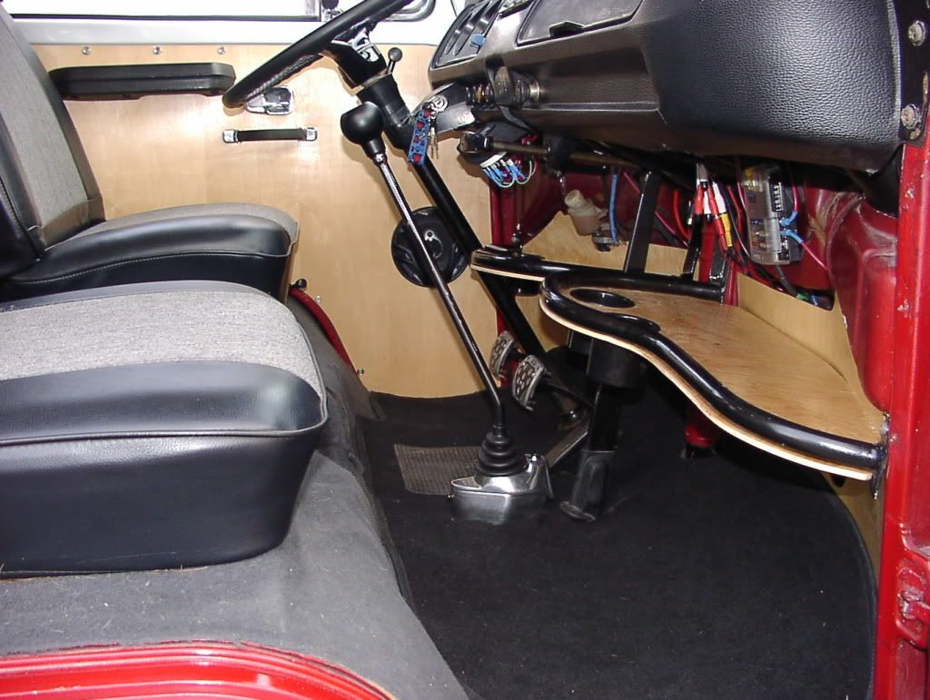

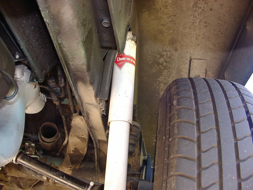

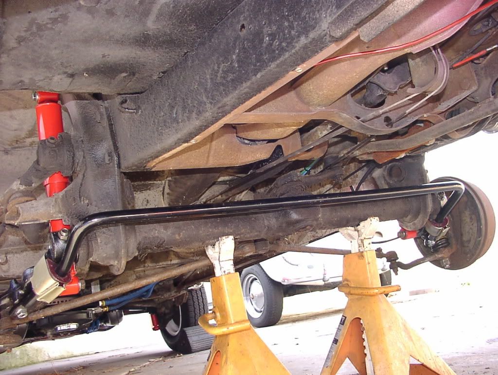

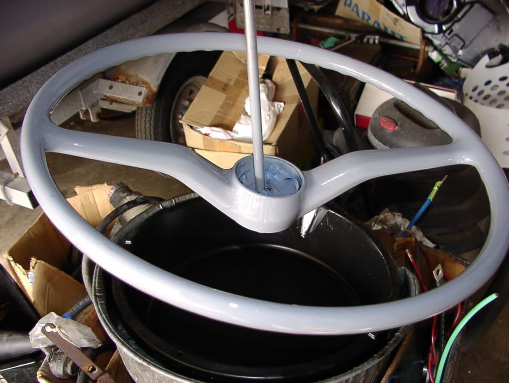

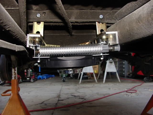

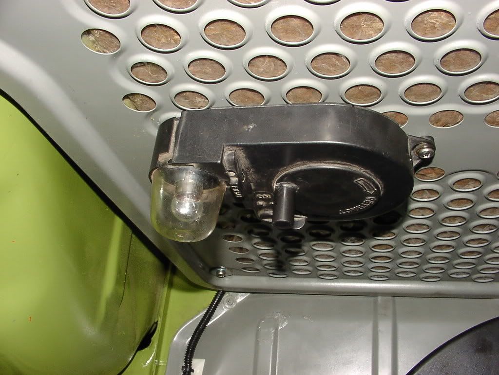

I received a PM from a member asking about worthy upgrades. In responding it became pretty lengthy so I thought I would share it here. Not sure if it's appropriate or not. The upgrades kinda depend on what year bus you have but I can start with a few. These aren't in any special order.
Auxilliary battery
Fuel tank overhaul
Deep sump
Engine compartment light
Engine gauges (oil pressure and temperature)

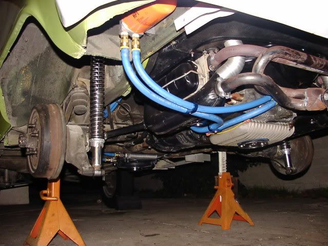

External oil cooler
External oil filter

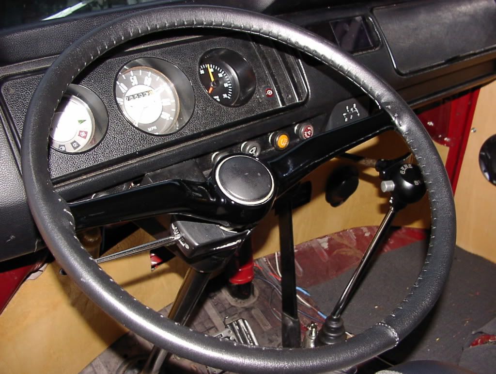

In dash tachometer
Coil over rear shocks
Curtains

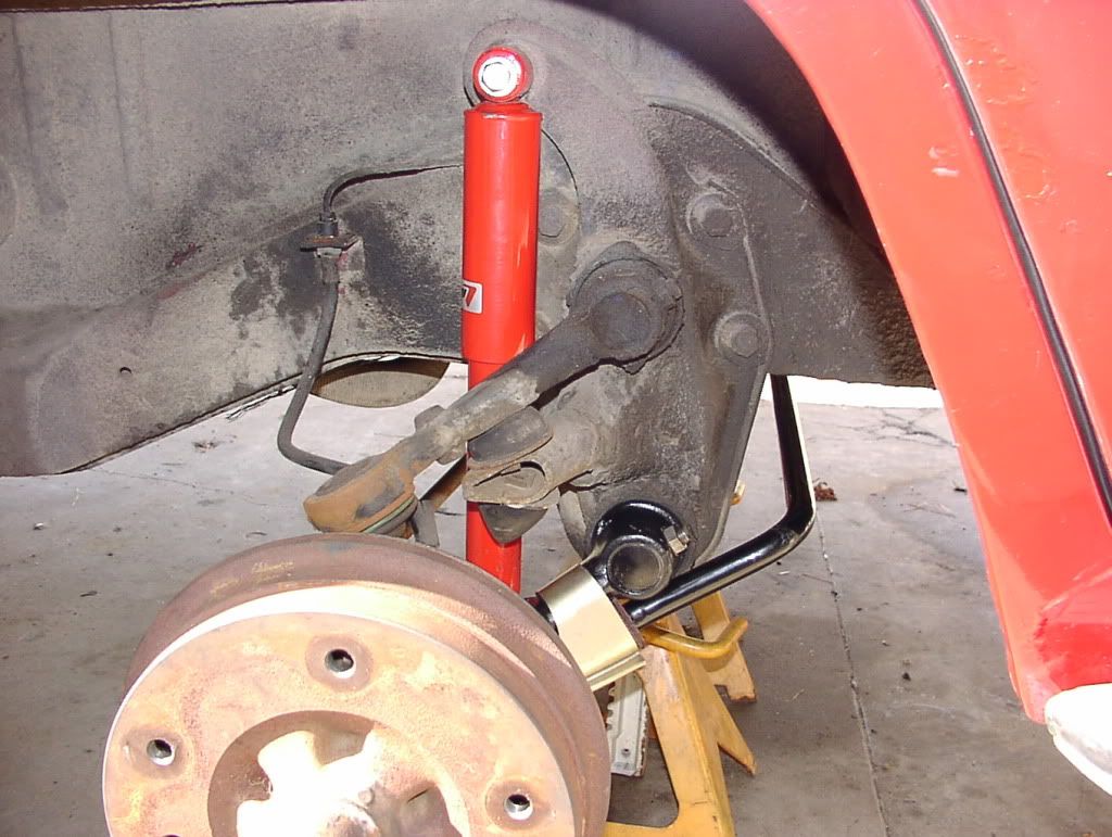

Gas shocks
Wood paneling

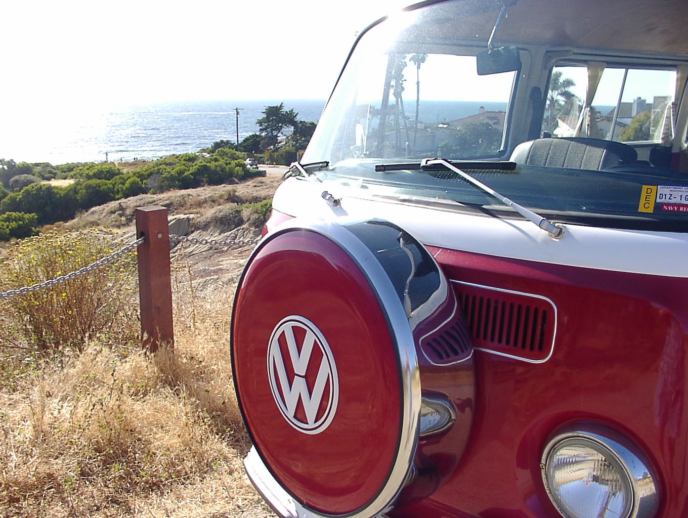

Spare tire cover
Propane heater
A1 Sidewinder Exhaust

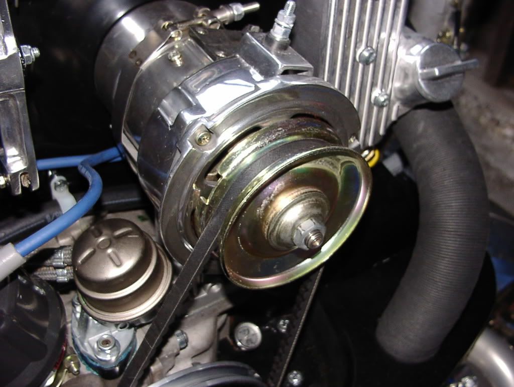

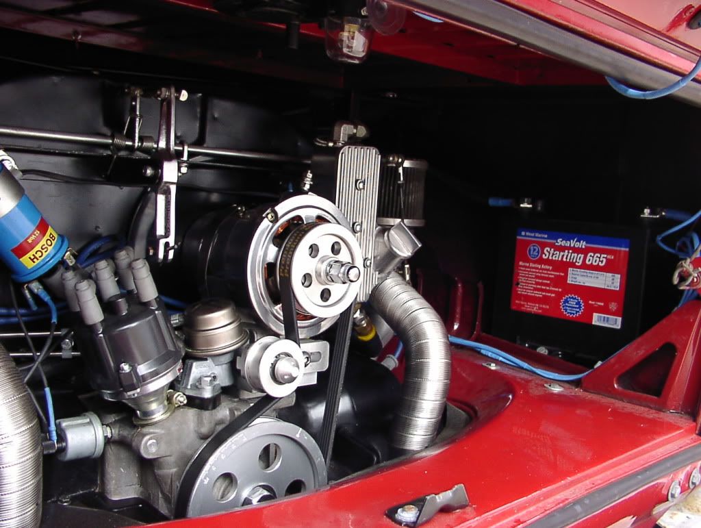

Serpentine belt system
Adding power brake booster to pre 1971 bus

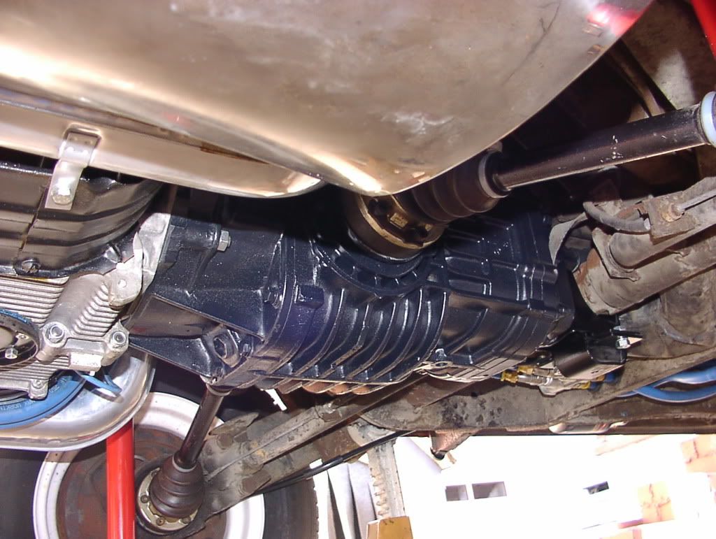

6 Rib 091 Transmission for better freeway performance
Gene Berg gearshifter (locking)
Sidestep
Koni shocks
Heavy duty front sway bar
Wheelskins leather wrap
Steering wheel redo
Fog lights
Stainless fresh air hose
75 amp Bosch Alternator
Dual Dellortos
CB Performance breather tower

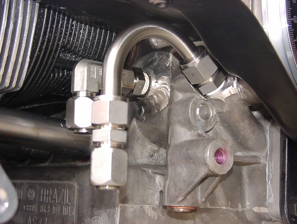

Stainless fuel manifold
Full flow oil system
Ceramic coated heater boxes

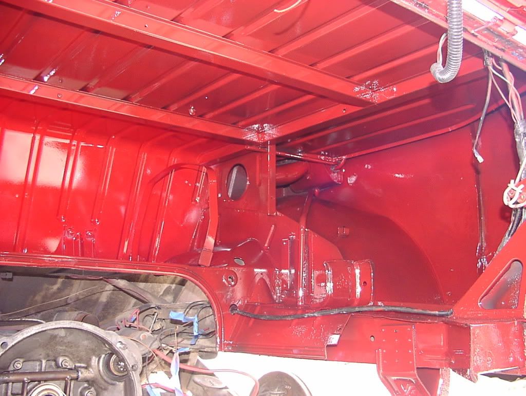

Painted engine compartment
Powder coated wheels with Hankook RA08 tires

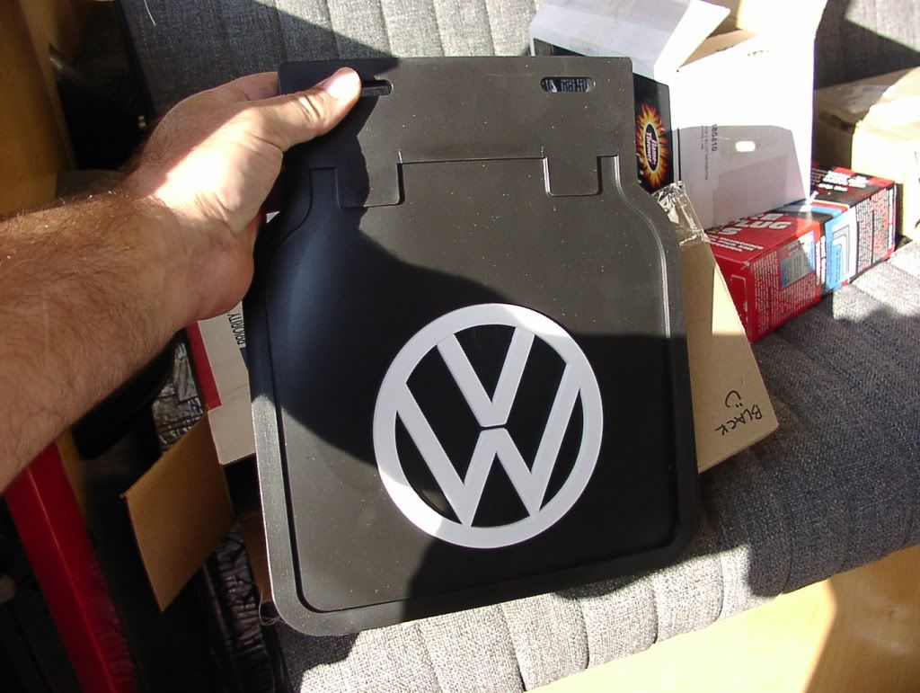

Mud flaps
Shelfs

Agree with almost all but why serpentine belt? Lastly, why deep sump if you have external oil cooler?

That was a turnkey engine that I had purchased for a customer and the sump came installed.
The serpentine belt is on a different bus. Say what you want to but I really like it. I researched them and bought the best one I could find for my customer. Granted that it doesn't give added horsepower or any more reliability but if you have an extra $220 burning a hole in your pocket or maybe your birthday is coming up I think it's cool.

you have 3 types of shocks, if you could pick one what would it be?

Right, it depends on your budget and what you're trying to accomplish. The coil over shocks are an easy way to raise the rear end of a sagging bus and make the ride stiffer. For about $100 it's a cheap upgrade.
The KYB shocks are about the cheapest "gas" shocks you can get. I had Bilsteins on my old bus and really liked them.
Koni's are top drawer when it comes to ride. They aren't cheap at around $130 each if I remember right. The set pictured was purchased through the samba classifieds for $300/set.

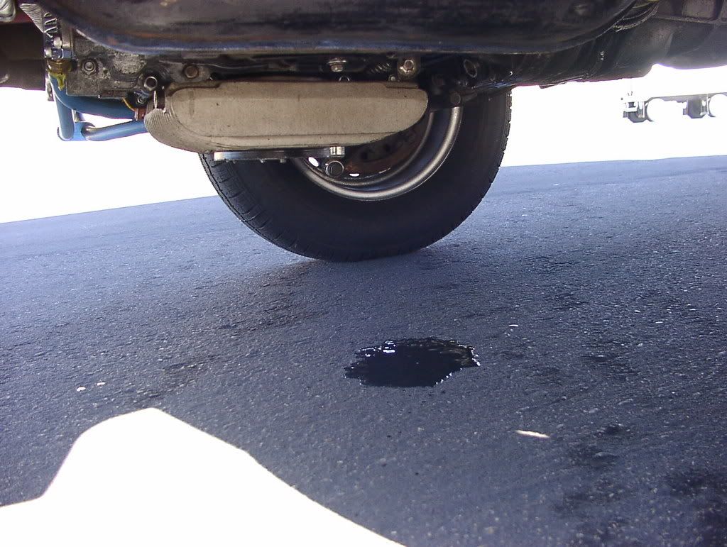

Ummm....... Is that bus marking it's spot? Shocked Laughing Laughing Laughing

I've heard all sorts of fluff-n-stuff about the Serp belts. Other than tastes-great/less-filling arguments, the physics seem sound on a number of levels.
There was specific research about ACVWs on this subject and I've mislaid the paper but it comes to this:
The toothed Serp belt, rides on TOP of the edge of the pulley and doesn't rely on the shearing friction with the pulleys to turn: that's what the teeth are for. That shearing friction (essentially, pinching the belt at the gen/alt pulley end) you pay for in power.
It probably isn't enough to feel in the seat of your pants. But its there. Also, the constant pull down on the gen/alt bearings is another source of friction that you can reduce. Again, not enough to feel, but still there.
The toothed Serp is capable of continuing to turn the gen/alt at the correct ratio past 4k RPM. The The V belt is not. (This is from the paper I mislaid.) Past 4000, some folks blamed cavitation for a failure to maintain the same proportion of cooling. No. The problem is that the slippery shearing friction of the V belt at the gen/alt pulley starts to lose the fight around 4000 and begins slipping so much that the ratio between crank rotation and fan rotation falls.
With the Serp belt, your fan is more likely to explode (and may, if you spend a lot of time North of 5000 without a welded fan) before the belt fails.
And the final best of: The Serp belt requires no fiddly moving of inside and outside shims, split pulleys, etc.
The only functional complaint I've heard against the Serp System is that the Scat Serp Kits have crummy Idler Pulleys that have a bad habit of falling apart, but that the original BMD Serps are pretty nigh bullet proof.

BMD, that's what I bought.

Figgr'd as much. The BMD is some nice kit, and its kind of cool that they broke into the VW scene with their product. I'm just waiting for them to do one for Type4, but I don't expect to ever see it, and I don't want one bad enough to bespoke the work on someone's CNC.

I Stainless fresh air hose
i couldn't agree more with this one. i am running them on my bus and my in laws Thing. the best 40.00 you could spend

hello aeromech can you tell me the name and where i can get the coil overloads for the rear of my 73 bus... thanks Brett

I have no clue. I bought these at my local VW Parts House. I'm sure if you do some looking you can find them.
