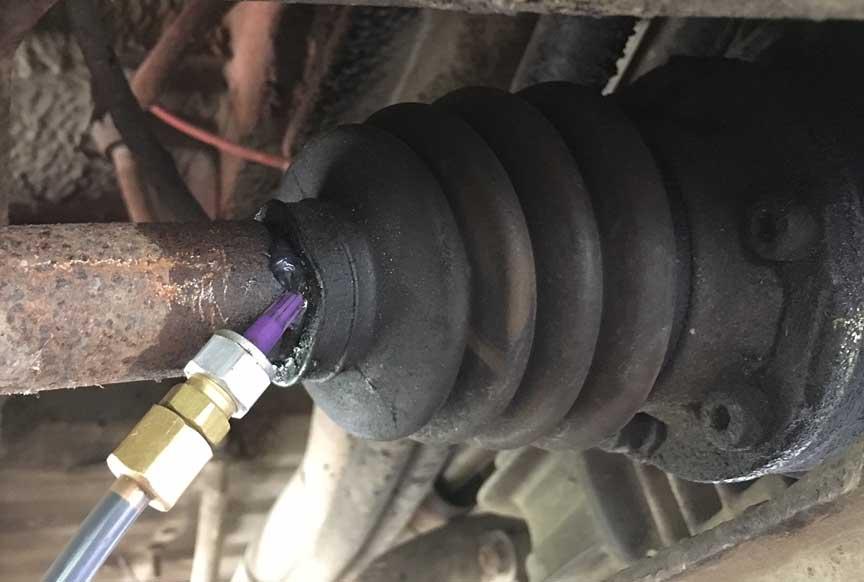

1) Leaving for a 3,000 mile trip this eve.
2) Had a recent event (2 days ago) where some other guy left on HIS 3,000 mile trip without checking his CV boots.... thatmade me think about looking mine over better.
So I found one that was leaking a little. Closer examination revealed some kind of goober/patch. I peeled it off and it was covering a hole where the boot had worn thin then thru. These may be original boots (178kmi) - apparently the goober lasted quite awhile. Maybe I goobered it myself before a trip many years ago. It seemed like silicone, but maybe a little tougher, but it looks like it held for a long time. It's silver and you can see remnants of it in the photo. I'm leaving tonite, I want me somma'dat.
So, what is the quickest way to patch a hole in a boot? I'm gonna do something, maybe Shoo Goo unless someone has something better (tested).
Pumping EP Moly grease in. Probably have to change boots anyway, might as well grease.

OK all done I suppose. Couldn't bring myself to use a bicycle patch - knowing that grease may ooze out as I'm trying to press it down. So I cleaned it with carburetor cleaner then covered holes with Shoo Goo.
Poked another boot. It could not possibly be OEM
Covered hole with Shoo Goo
OK now THIS must be an OEM boot
Old OEM boot poked.
This one had no band.

Old OEM boot poked.
That grease needle looks much shorter than the one that VanCafe has in their CV grease kit.
http://www.van-cafe.com/home/van/page_626_338/cv-repack-kit-a-for-2-wd-vehicles.html
It looks like you're only putting grease in the boot not in the CV joint itself. With the long grease needle and removing the clips you can slide the needle under the boot and get the grease into the CV joint itself. Loading the boot with grease might cause rotational stress and do more damage to the boot.

The long needle will reach into the CV joint and old grease will be displaced with new grease. Putting grease into the boot only, could cause damage to a weak boot and may not reach the CV joint.
When you grease suspension parts do you disassemble and repack or do you just clean the nipple and pump new grease in until the old grease comes out? You can spend hours repacking a CV joint or you can spend days and weeks of driving and camping with fresh grease needled into a CV joint. How many times do you fold your toilet paper? Anal is banal.

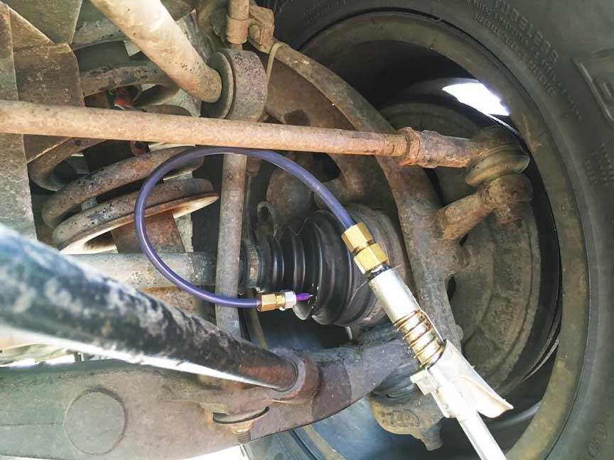

What I use to inject 25ml into each CV on a regular basis:
That long flexible tube (a piece of ΒΌ" irrigation line) has a slanted cut end which slips under the small end of the boot (no clamp) and reaches all the way in until I can feel in the joint.
The 'hypo' came from Goodwill and was intended to inject meat juices into a roast. Similar items are available at your local pharmacy.

He may have dirt/grit in there. The original pic shows a very short needle, which is what I'm commenting on.
Yes, the short needle could possibly do more harm than good. The grease goes into the boot and not the CV joint. The new grease may carry dirt/grit into the CV joint and/or the boot may rupture with the weight of the grease turning at speed. Long needle or disassembly and packing are the better ways. I ASSuME that too much grease with a long needle would have the same potential for causing rupture.
The OP is leaving tonight on a 3,000 mile trip and he will probably round trip without problems, but it is time to replace the boots and inspect, clean, and repack the CV joints and not worry about them for the next 50,000.
A long six point or triple square hex bolt socket, clean bolts, new Schnorr washers, vinyl gloves, and the proper grease will be his friends when he returns. There are links and photos in other CV joint threads.

Some grease is better than no grease, But, it is a better idea if you have no idea what the CV joint looks like, what's worn & what isn't, to remove the boots & clean & inspect the joints.
Ya have to have an idea what you're starting with.
A longer needle shoved all the way down the axle to the joint would be a guaranteed way of assuring that ypu are getting grease in the right place.
The shoe goo will seal that up well if you got the boot plenty clean and scratched it a little with 80 grit paper.
You play hell trying to remove it.

Here is my home made version of an extended needle fitting, it gets right into the joint where the grease is needed.
