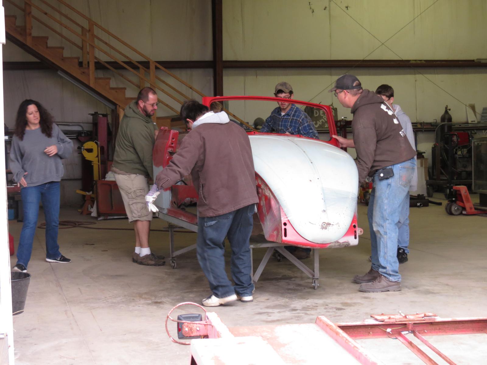

here are some highlights from the past 6 years, this is why Joe has it now. I am very slow.
bugmandave
Joined: December 30, 2005
Posts: 642
Location: Illinois
bugmandave is offline
PostPosted: Wed Mar 20, 2013 6:43 pm    Post subject: Reply with quote
dropping it off at Vintage Metal Werks.
bugmandave
Posts: 642
Location: Illinois
PostPosted: Wed Mar 20, 2013 6:57 pm    Post subject: Reply with quote
more dropping off pictures.

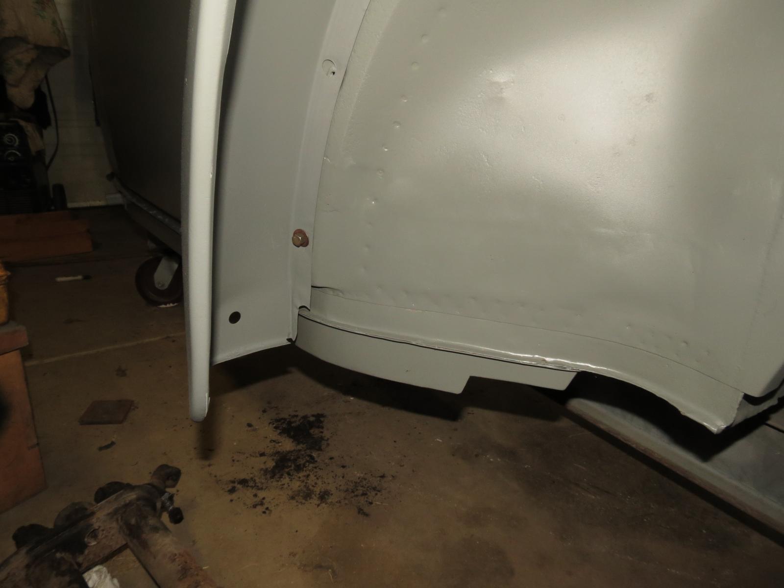

We've got some of the metal work wrapped up on ole Ruby here! We welded up all the extra holes in the front parcel area where it must have had some speakers and or radio or something hanging there over the years! We also got a couple rust holes repaired in the wheel well area and some finish metal work done in the spare tire well, and we replaced the majority of the drivers side carpet retaining strip on the rocker area! Not much more welding Ned's done in his beauty . Then time to do final fits of all removables and the. Into bodywork!
[img]
I will get some more pics uploaded this weekend of the different metal work areas we've done, we also did some welding and cleaning up at the ottom of th door pillars .

here are some pics Joe sent to me a while ago, first two are him working on the reinforcement rail that I hand fabricated to look like the original, third are seat belt mounts added to install lap belts, they are anchor plates from an old pan, welded in from underneath, last pic is the drivers side carpet retainer repair. just had a couple spots where it was rusted out.

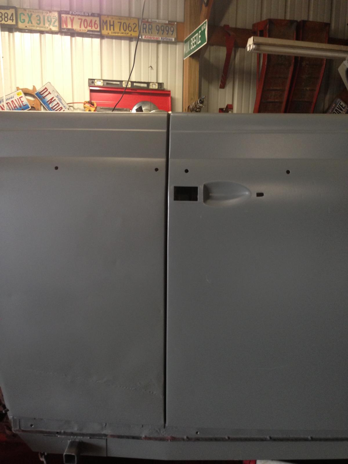

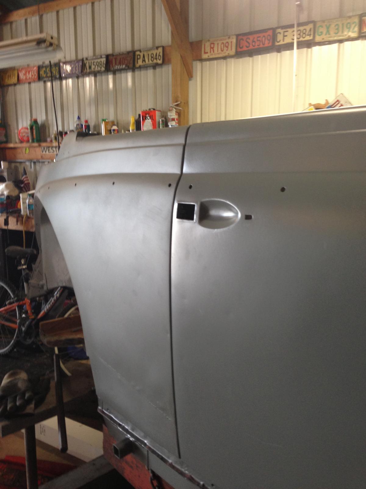

got door gaps dialed in

that is the pan, and now the body and pan are mocked up together so I could get the door gaps correct. just a few more small welding repairs and then on to the body work.

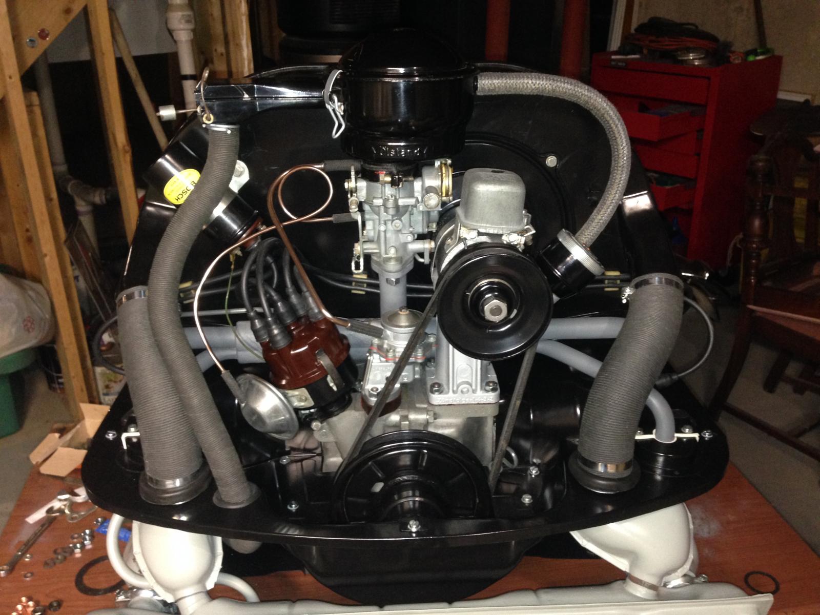

PostPosted: Fri Dec 06, 2013 9:10 pm    Post subject: Reply with quote
fresh rebuild and facelift, plus a few extras.
...69mm crank, 83mm pistons, mild high lift cam, performance valve job, pocket port and cc'd for 7.9:1 compression by AJ , 200mm clutch 1.1:1 rockers. not your grandpa's 40hp

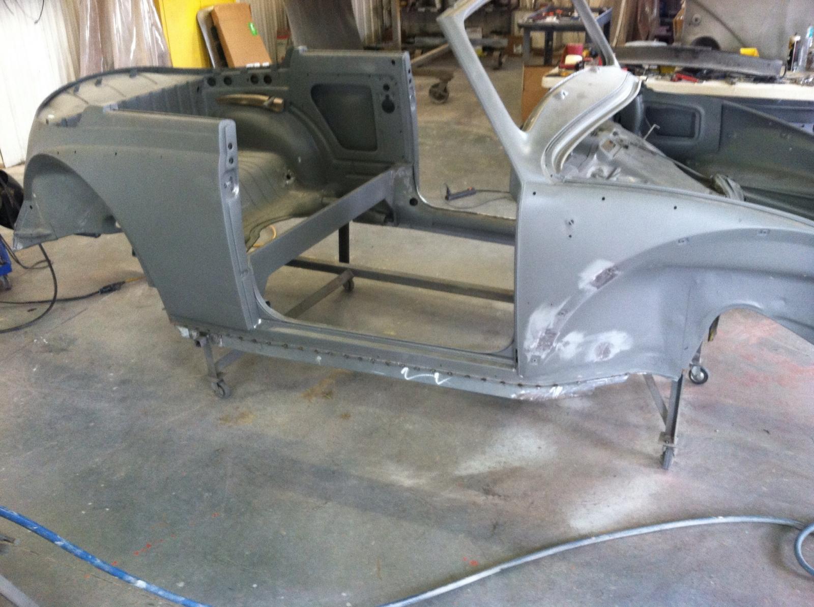

PostPosted: Sat Jan 04, 2014 1:37 pm    Post subject: Reply with quote
update.. body work pics
