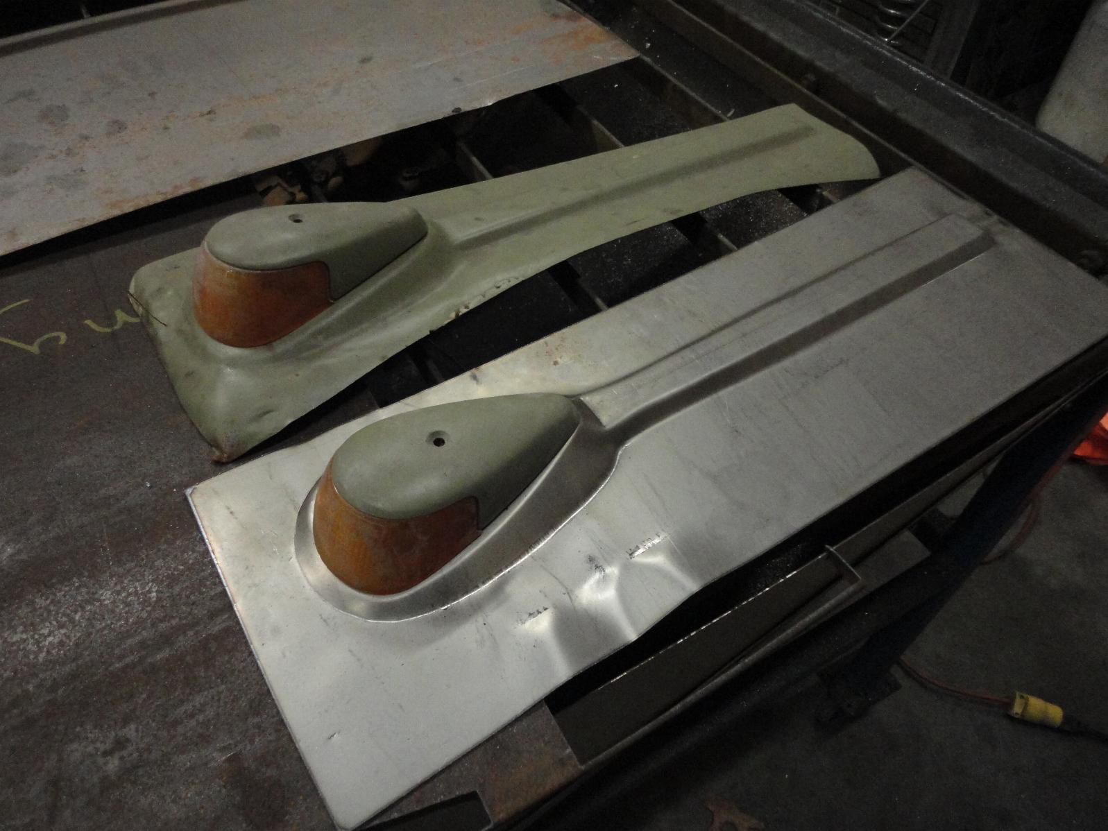

PostPosted: Wed Jan 14, 2015 7:23 pm    Post subject: Reply with quote
I am working on patch panels to make correct looking early fenders out of later ones since the early ones are impossible to find.
Why buy what you can build.

PostPosted: Wed Jan 14, 2015 7:25 pm    Post subject: Reply with quote
72 down style verses 73 up

PostPosted: Wed Jan 14, 2015 7:27 pm    Post subject: Reply with quote
Nice!! Cool

Nice patch ! Cool
Very nice! Good job Smile!
