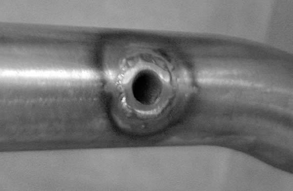

if you need a hole bigger than 1/2" consider punching a hole with a hole saw and welding a bung in there to keep the tubing strong
