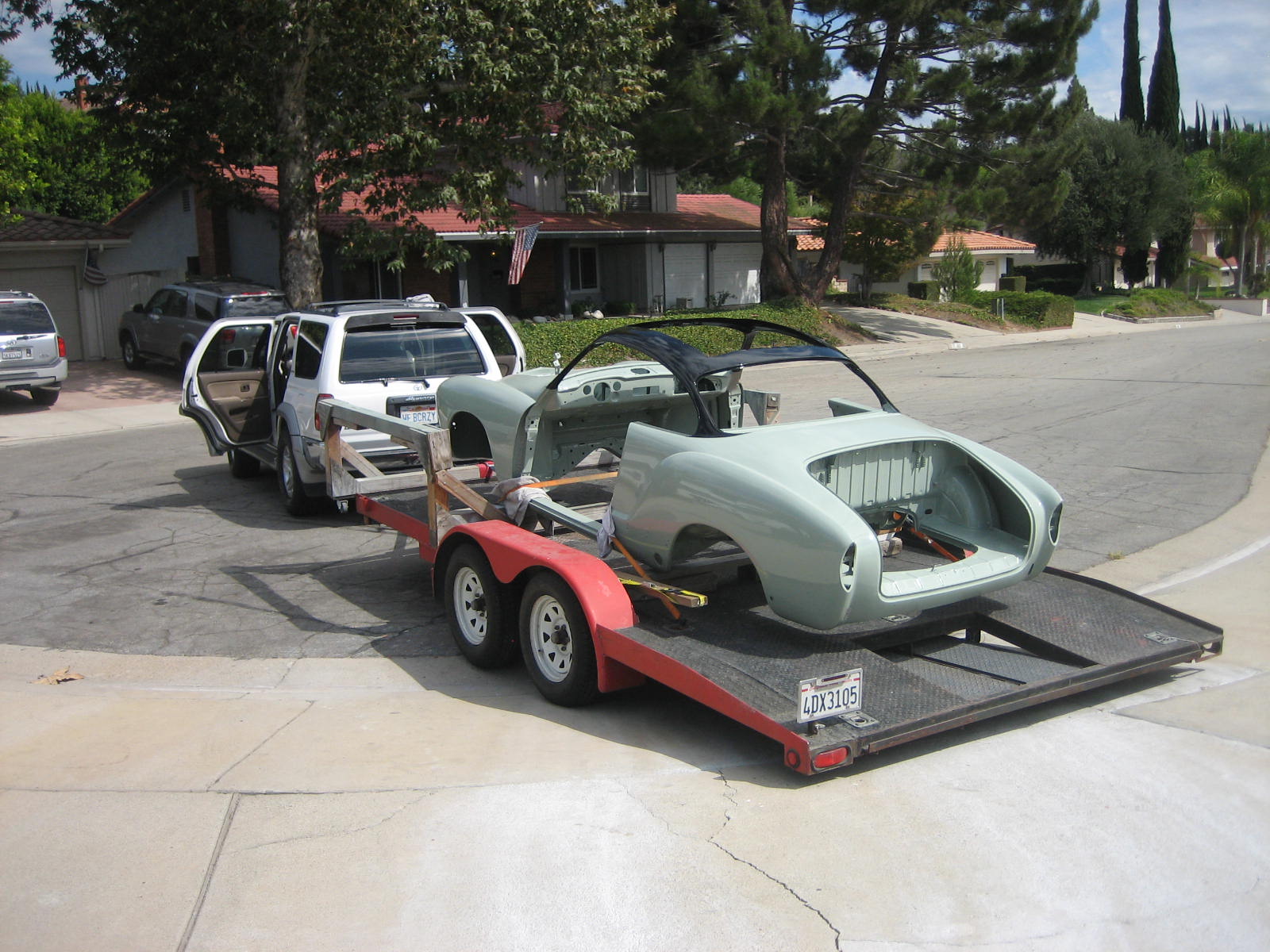

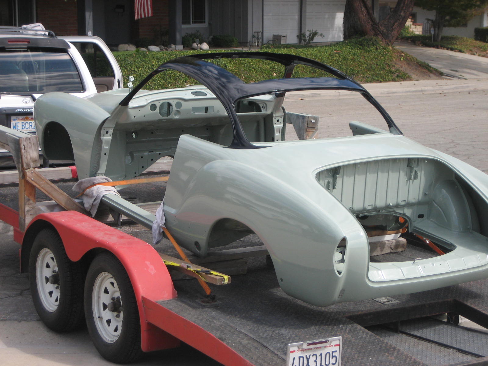

When I needed it moved on a trailer...I put down a few 4x4's as a base to tie down on. With my trailer set up I could place my dolly on the front so when i got to destination I could drop body on dolly and still be mobile. The body is really not too heavy.

PostPosted: Fri Mar 29, 2013 3:21 pm    Post subject: Reply with quote
Thats sounds like it would work for me I have a similar trailer. Thanks for the ideas!
