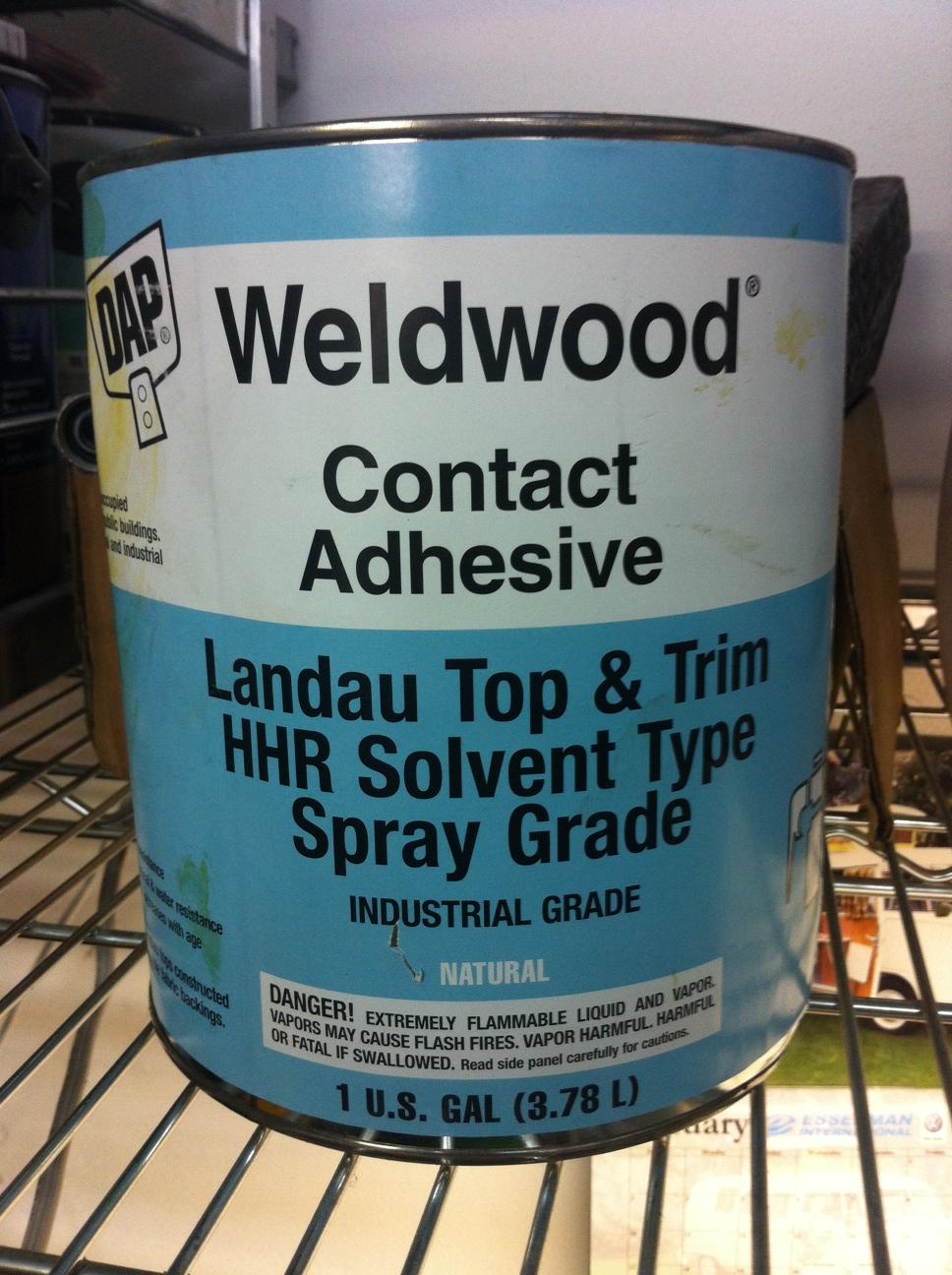

I got a cheap paint gun (bottom cup) and used DAP Weldwood Contact Adheasive from the upholstry store. You can keep the glue in the gun and as long as it is sealed tight it won't dry in your gun. They also have Cosmoline for clean up. Without the beading there will be stress at the gap and the glue could give way in the future. However the OG beading is a pain in the ass. They sell a smaller vinyl beading in a few colors at the upholstry store. Good luck, you can do it! _________________ President of "Society of Unappreciated Overachievers"

This is the only glue to use when it comes to a headliner. I live in South florida where it is hot and humid, and this stuff stands the test of time. To spray it, get a cheap $20 Harbor Freight spray gun. Keep the gun sealed and it will last for years in the gun. Mineral spirits cleans this glue up, and won't hurt your paint or headliner. Cost $50 a gallon and will do about 10-12 headlines in a bus.
Make sure to wear latex gloves. I would wear two pairs, so when the first layer got dirty, I'd be able to change quickly when needed. _________________ New Vintage Specialist.
