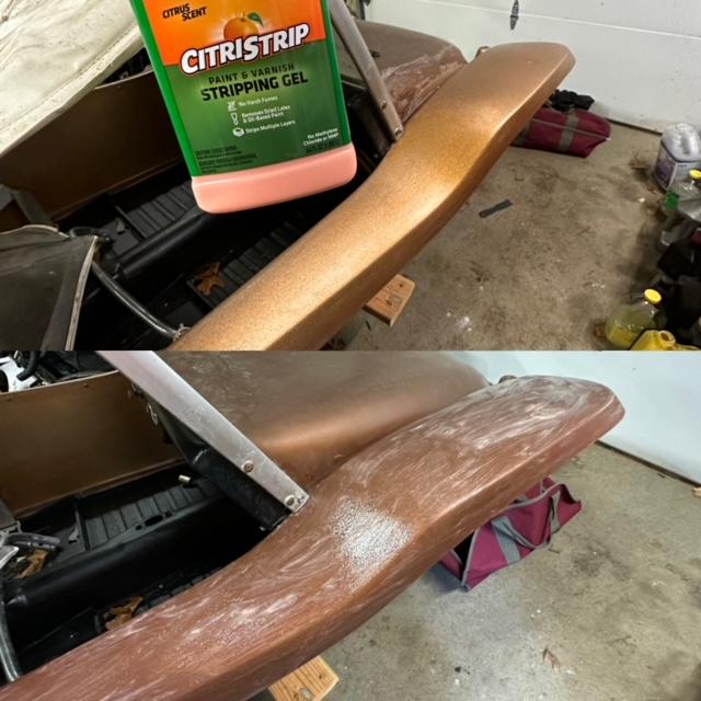

starting to strip off the brown paint

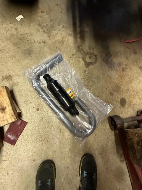

bought a muffler and some pipe to kind of replicate the idea of a sidewinder
